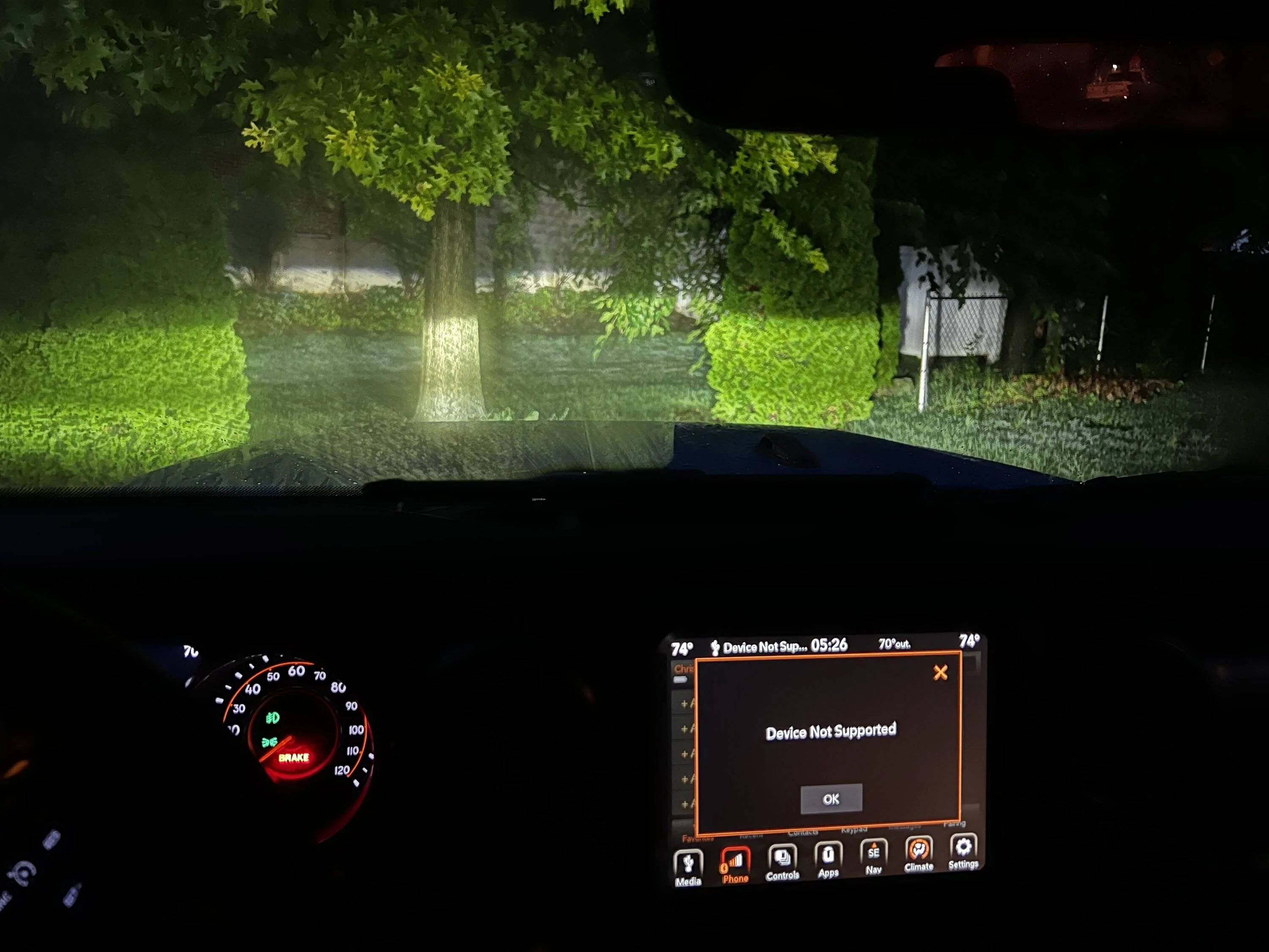

A bit humid outside today so I turned on my defroster and turned the heat up and found that the defroster is only working on the passenger side. Felt the food well vents and the passenger side is blowing hot air while the drivers air is ice cold. Both climate zones are synced wtf. My Jeep is a ā€˜22 JLU with 8k miles on it. A bit early for equipment failures. Any ideas @JeepCares
Jeep Wrangler JL Drivers side defroster not working A02DF170-7DD7-4533-A422-A1F2B0404510
