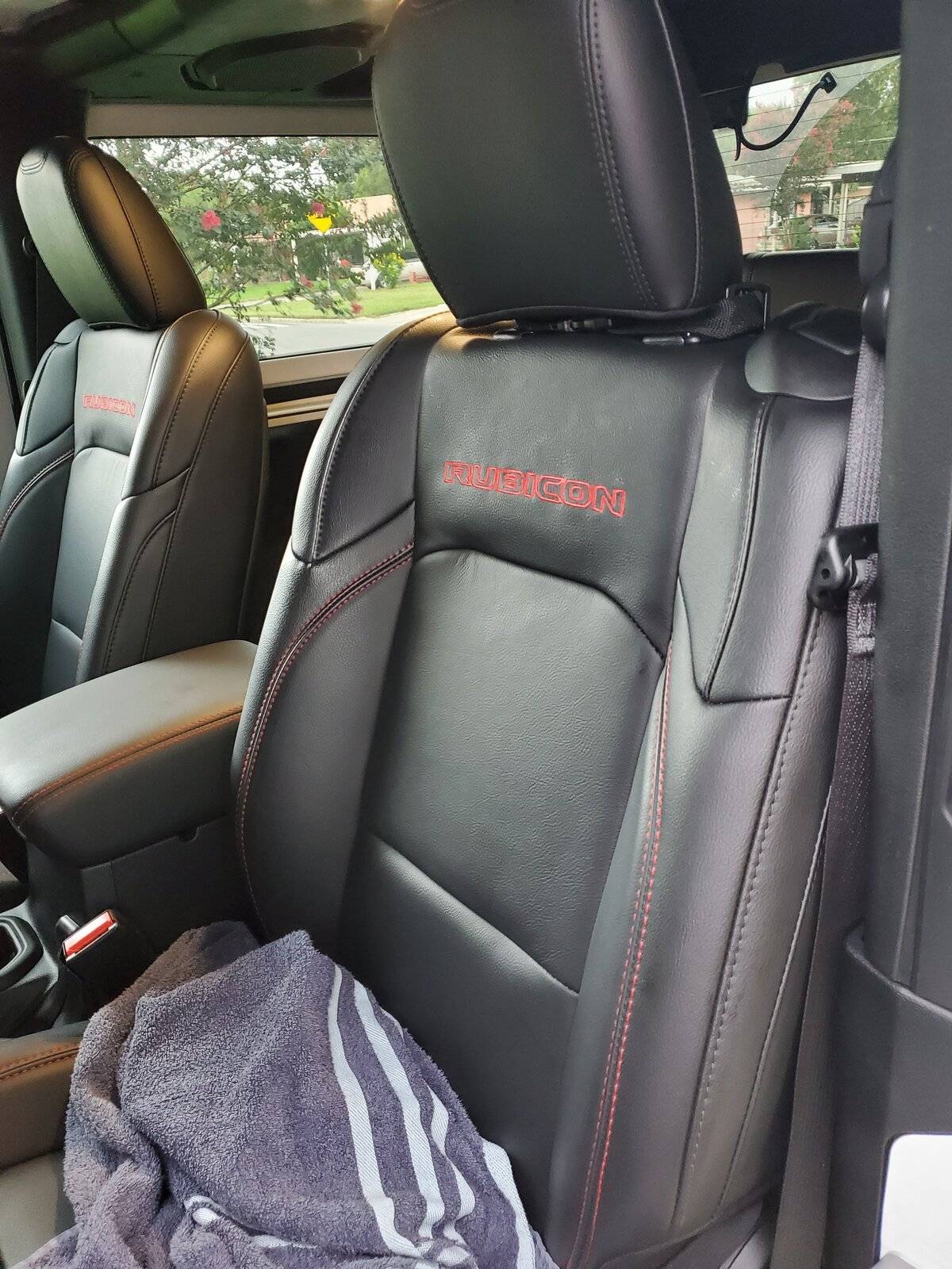

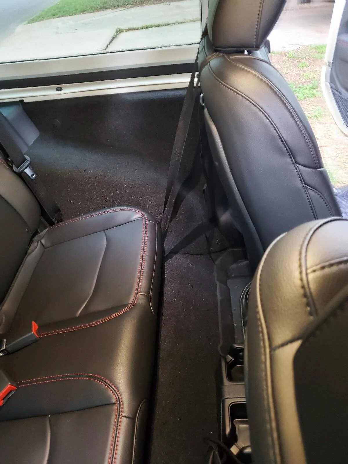

2 door 2021 JL Rubicon. I've only had it for about 3 weeks no issues until this past Friday. Driver side seat doesn't wanna lock into place. Tried the 3/8 ext. Trick but nothing. The plastic slider appears to be intact. Not sure what else to try. Trying to avoid dealership. Pretty much all my local dealers are backed up and no loaners.
Had to rig it up so that I can use it for now. Used the freedom top bag locking belt.
