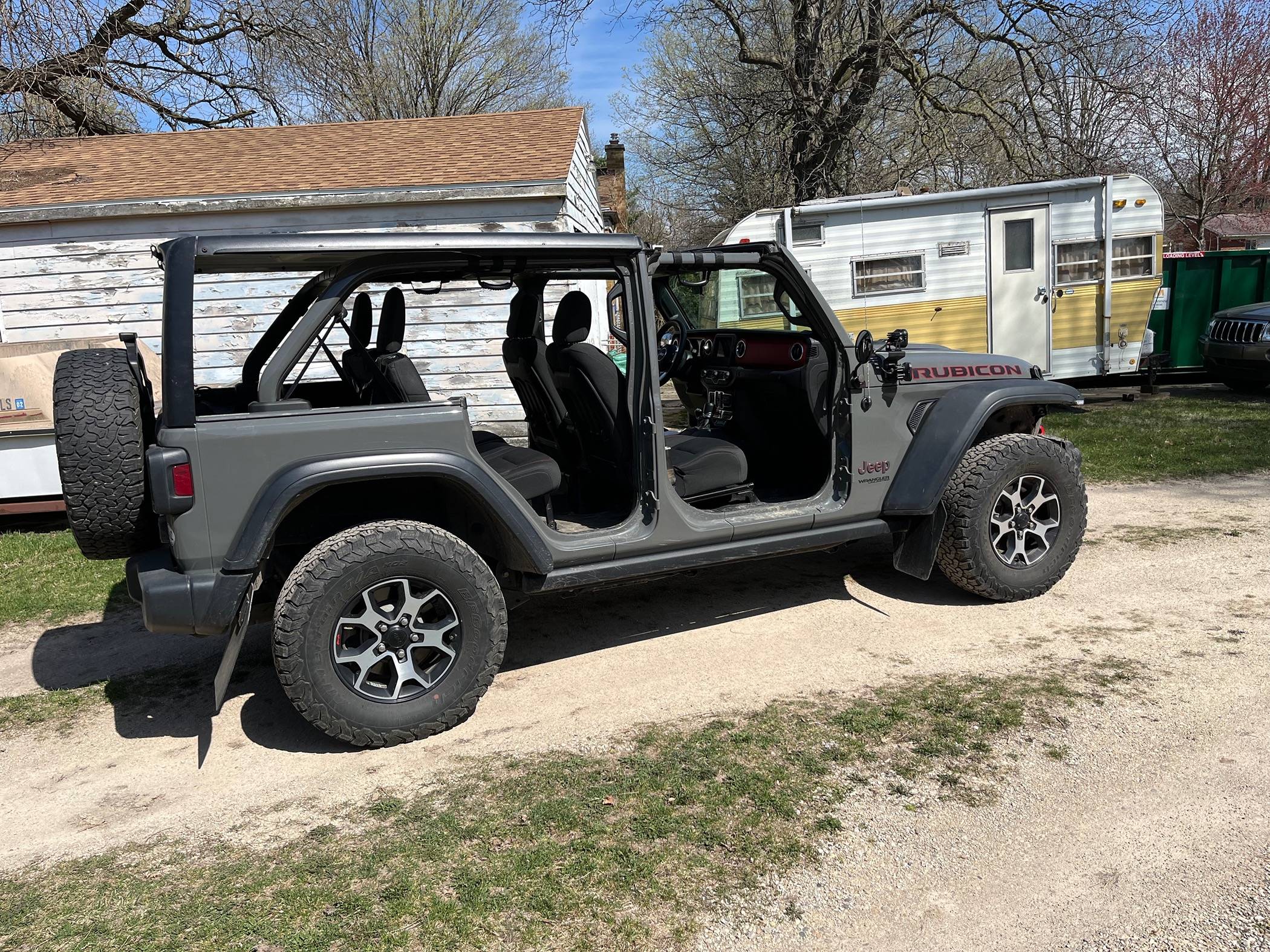

I was surprised last weekend to find out how flexible they are. Was in the process of taking the top off for the nice weather we had. Had all bolts out besides the passenger up front. Got sidetracked and came back ready to lift. It was about 2' up before realizing the front passenger side still attached. Lowered quickly and got the bolt out ready to lift properly. Surprising I found no cracks or anything out of ordinary. I would think with a backer plate you won't experience any issue assuming the plugs don't have any major weight pulling on it.
