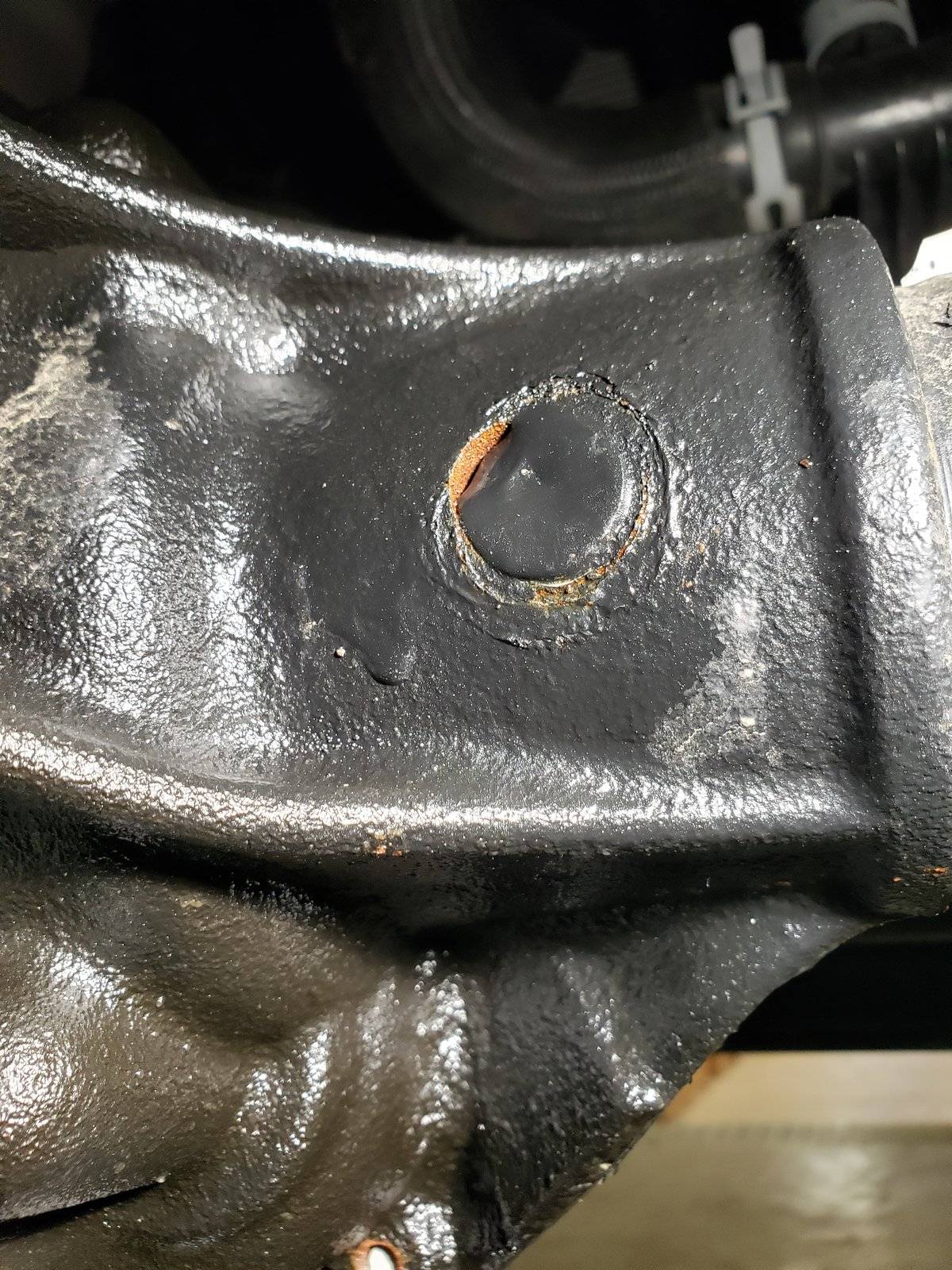

If you did hit something really hard, go under your axle and look at all the areas where the tube goes into a cast metal housing - so, both sides of the pumpkin and both sides of the front axle disconnect unit. The areas that will show cracks/bends/movement is the spot welds that look like this, it's where the axle tube is physically welded to the cast bits. These JL axles are known to break at the FAD, which is where mine did. Not to alarm, but I just went through something involving a big hit and axle issues about 6 months ago. All of the stock steering components were unbent in my incident.
