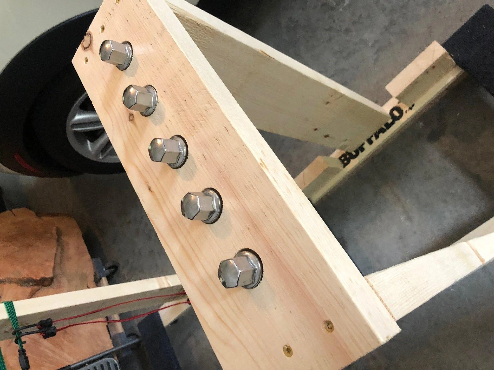

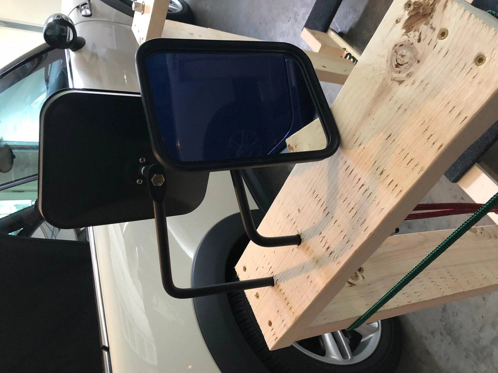

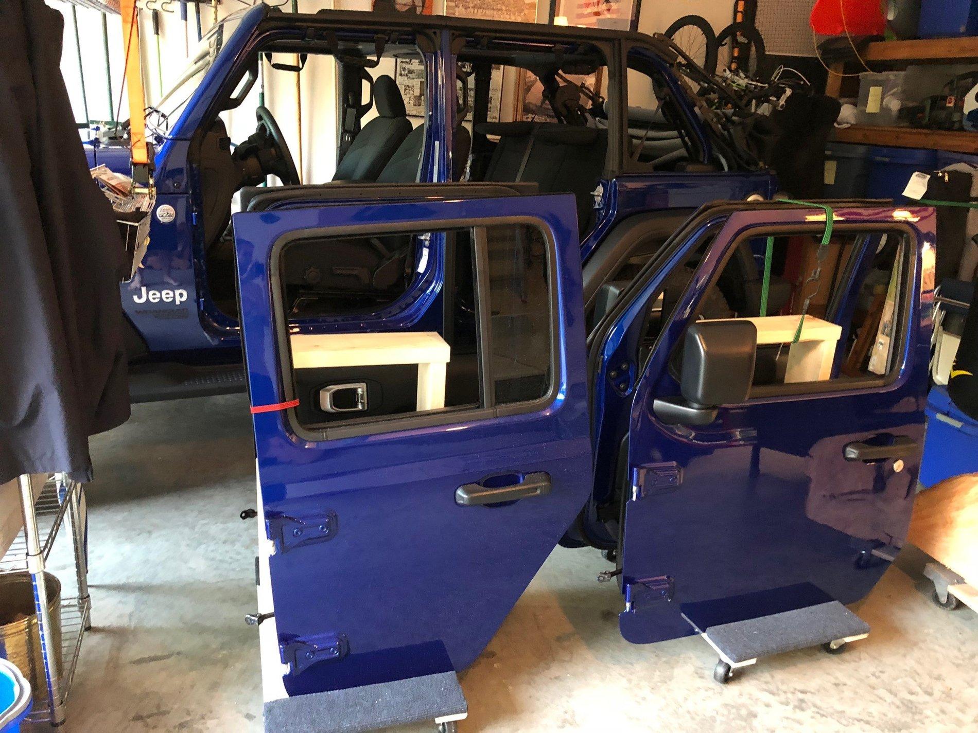

I finished these Q&D carts using a design I saw online...less than $60 all in...a single 2x6 that Home Depot cut to the correct dimensions, two furniture carts and an hour! I had removed the doors of my JL the first weekend I had it, and it was driving me crazy having them leaning against the wall in my garage unsecured!
I enhanced the design Sunday when I put the doors back on because of a rainy forecast here in Nashville....holders for my side mirrors and non-locking lugs!

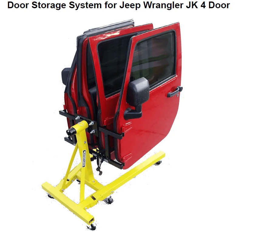

Anyone use something like this from Topsy, Stack and Roll?
I have an engine stand sitting around, just e-mailed them to see what the diameter of the pipe on their rack is, to make sureit will fit my stand.
You can wheel this out, put the two rear doors in first facing each other and the front doors on the outside, I would use a couple moving blankets draped over the interior doors to protect them.
Only concern is how stable it is? anyone use one of these?
Also how heavy are the doors roughly?
lastly I assume it is a good idea to lower the windows prior to removing them?
Note I have a Sahara on order for the wife, just buying stuff for it.

I can’t comment on the door stand, but yes 100% windows need to down when you remove the doors. It allows you to reach thru the door to grab the handle and also keeps your window safe while they are off

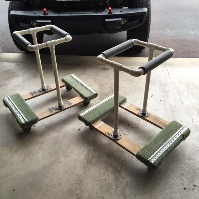

I'd mount that to a large board with the casters mounted to the board. Like a skateboard. This way it wouldn't bow down in the middle when loaded.
You could also built that with 2 2x4 running the length at the bottom and make door separator loops out of iron pipe with those same pipe pads.
You only need 1/2" pipe to separate the doors. Rather than permanently mount the loops to the bottom frame - just drill holes and slide the loops in. Then when not needed, you can break the cart down for storage.
I think I'll just make this for myself and post photos...
Harbor Freight sells the mover dollies with castors for $8. This is what I used for my YJ one. But if you start with this and modify it a little..
Something like this, only I have 2 doors per cart.
