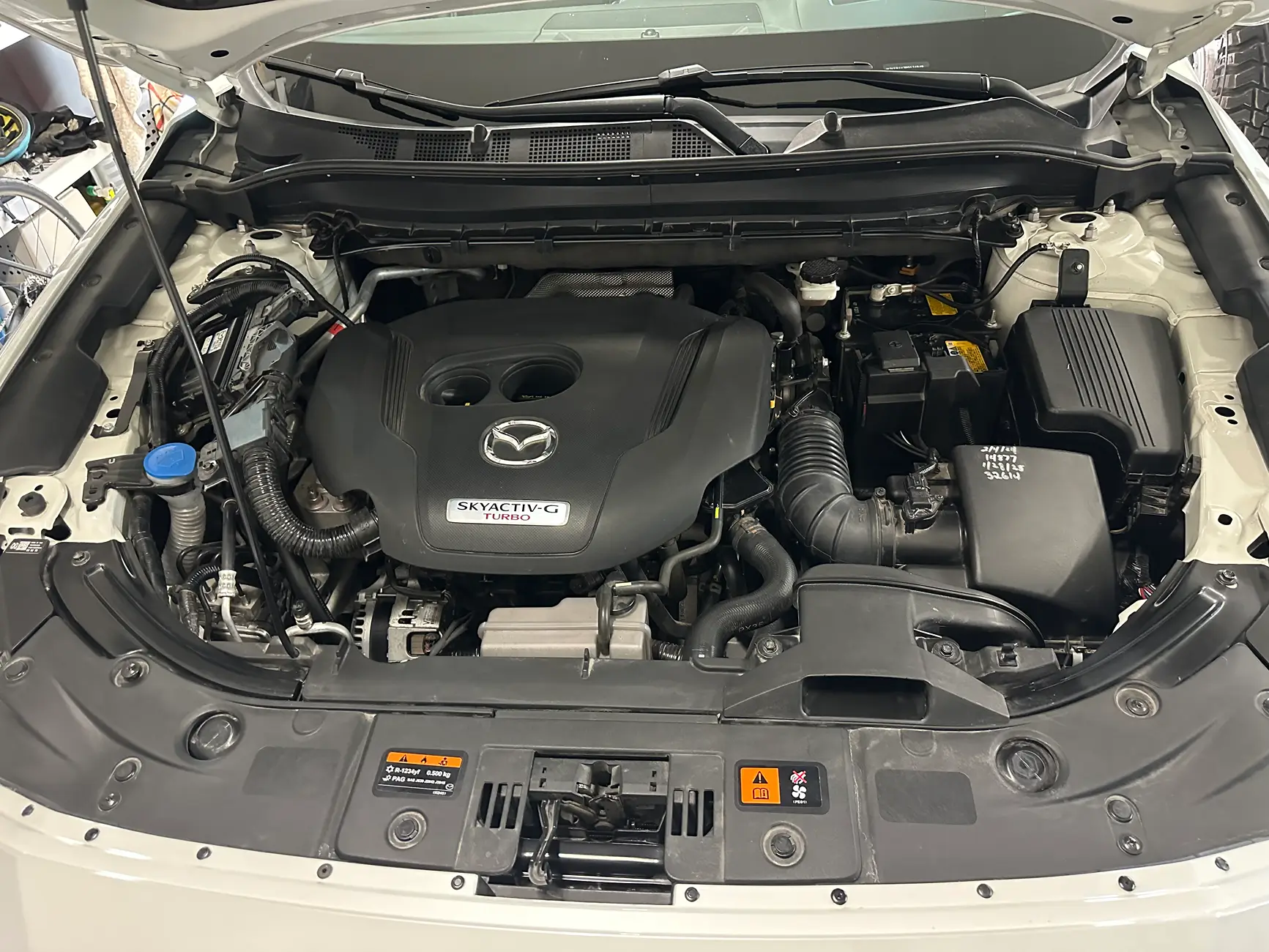

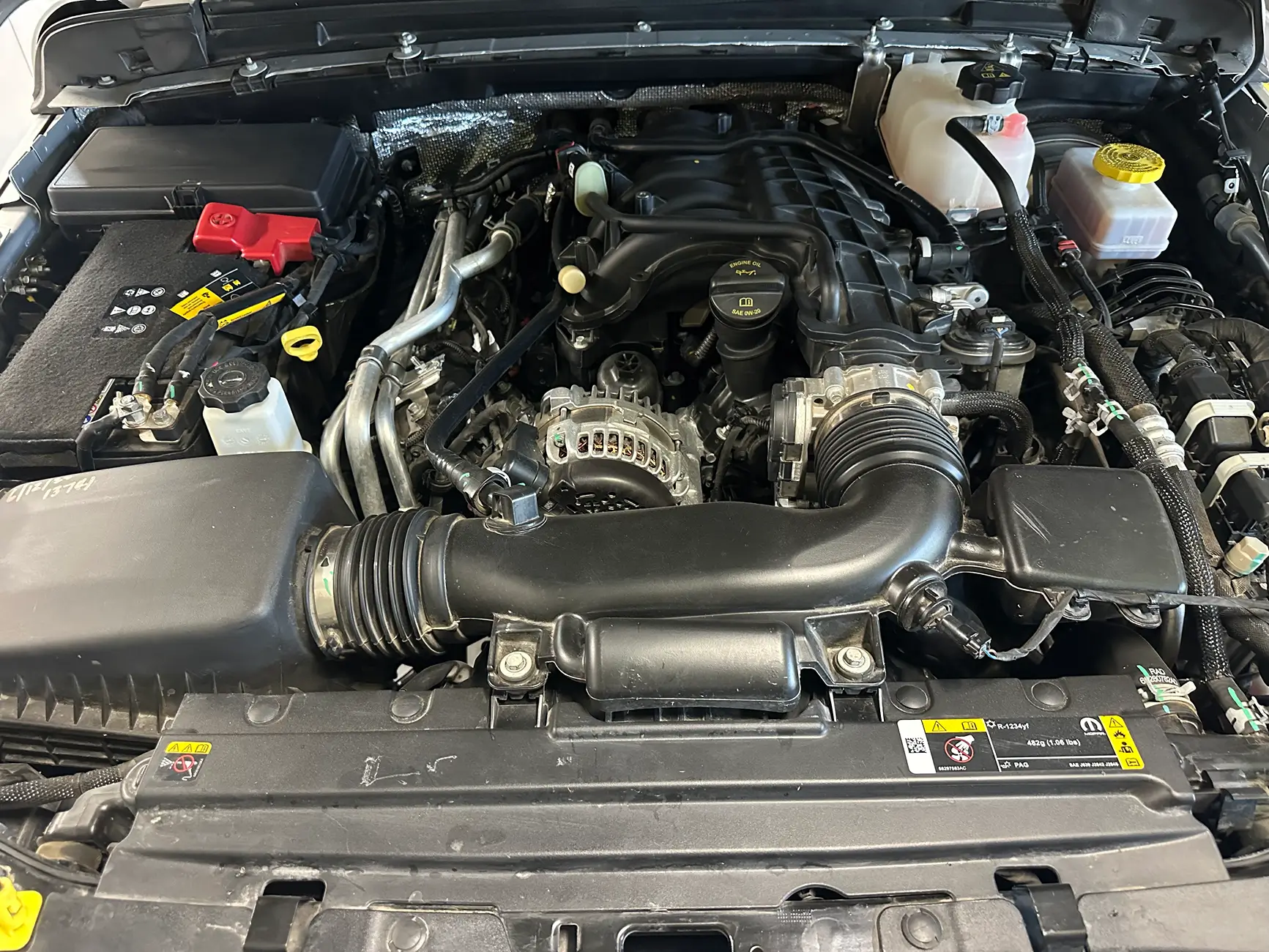

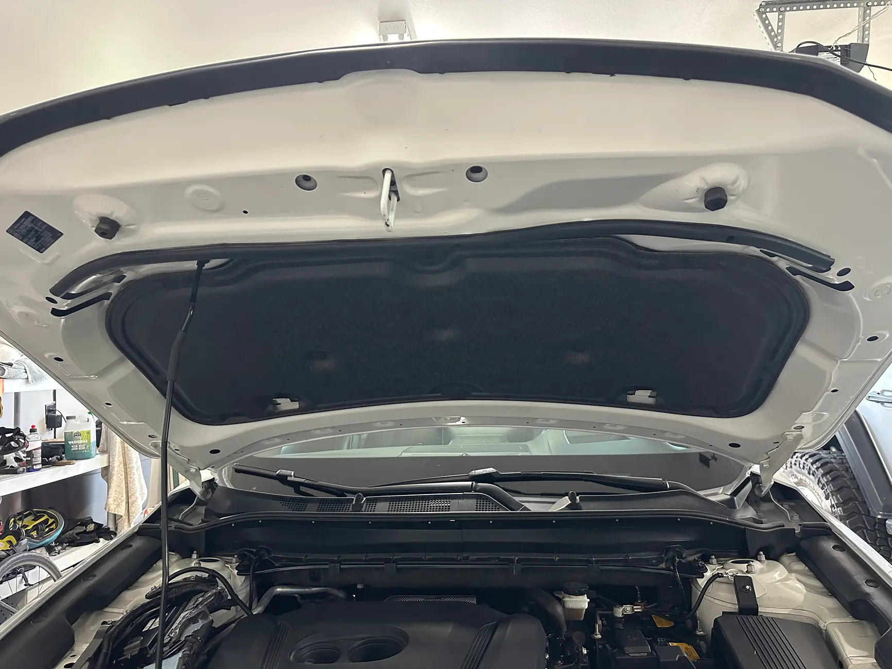

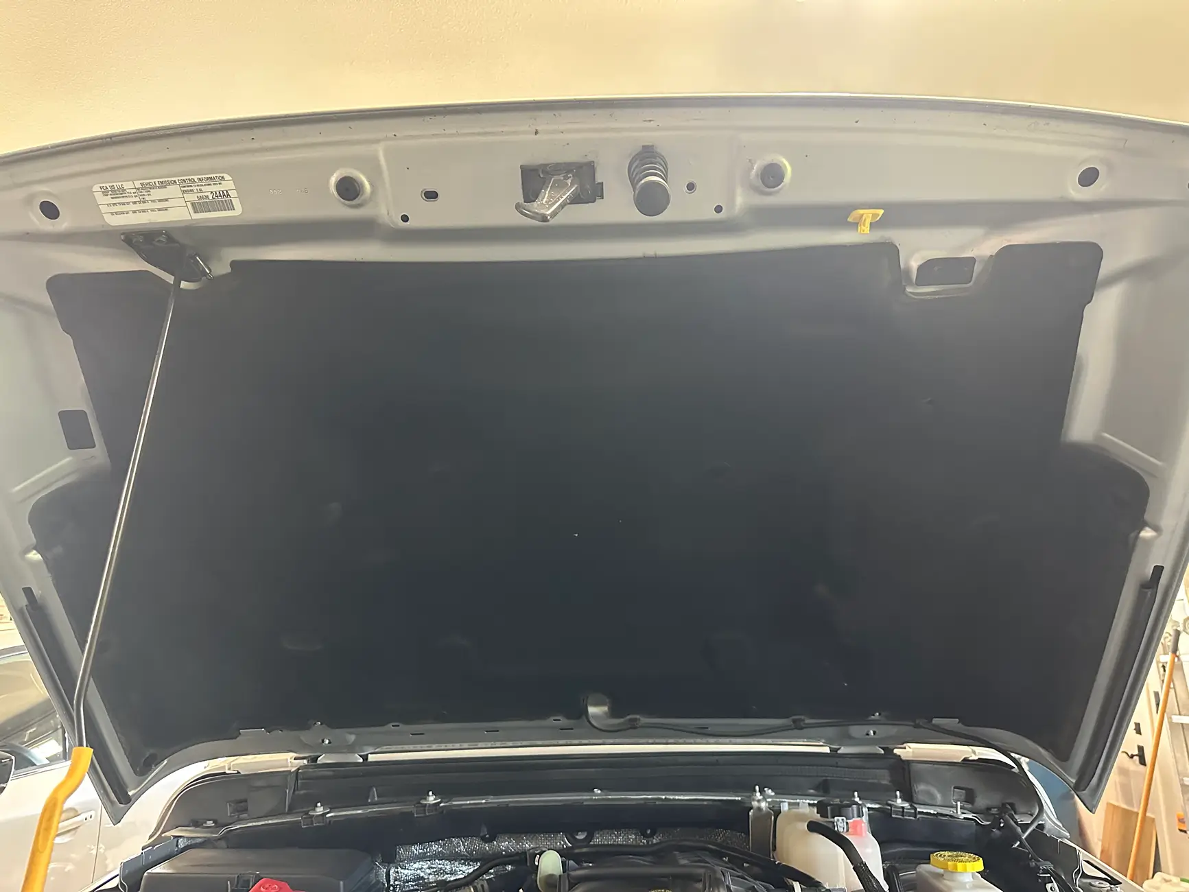

mine are not show vehicles so
Jeep Wrangler JL Don't fear the cleaner tempImagedtflcW
Jeep Wrangler JL Don't fear the cleaner tempImagehxLeNu
Jeep Wrangler JL Don't fear the cleaner tempImageARQzV
Jeep Wrangler JL Don't fear the cleaner tempImageqZJAc6
i just use a damp micro fiber cloth, if things are particularly bad I will use a small amount of dawn soap otherwise just plain warm water and wipe everything down every couple of months or sooner if doing a moab or similar trip...
mazda has 40,000 miles in 2 years and jeep 16000 miles in a year and a half...hood liners get the same wipe down..
