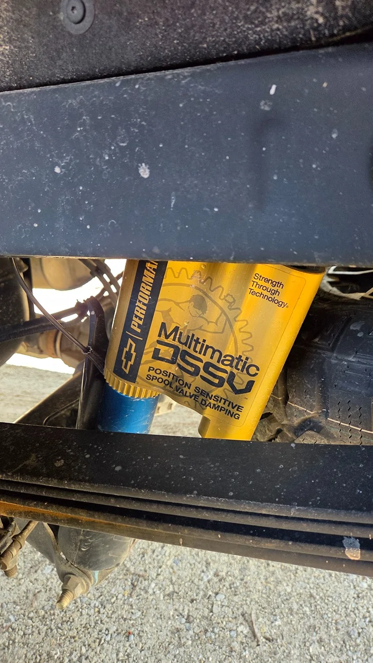

It sounds like what you are looking for is the multimatic dssv shock chevy puts on the zr2. Someone way more into shocks would have to explain the difference, how they work, and why noone else seems to use them. I test drove both the Colorado RST and ZR2 before buying the ZR2. I didn't want our need the offroad chops of the ZR2 since I am 90% onroad and 10% unmaintained road or light trail. But the reduced body roll and ability to soak up the bumpy stuff at normal speed sold me. I also test drove a Wrangler sport before buying my Willy's as a third vehicle. The difference from sport to ZR2 vs sport to Willy's suspension is 10 times different in my opinion.

Yeah, the spool valves in those are cool. Closest thing in the jeep world would be the E clik or Fox live vavles.
