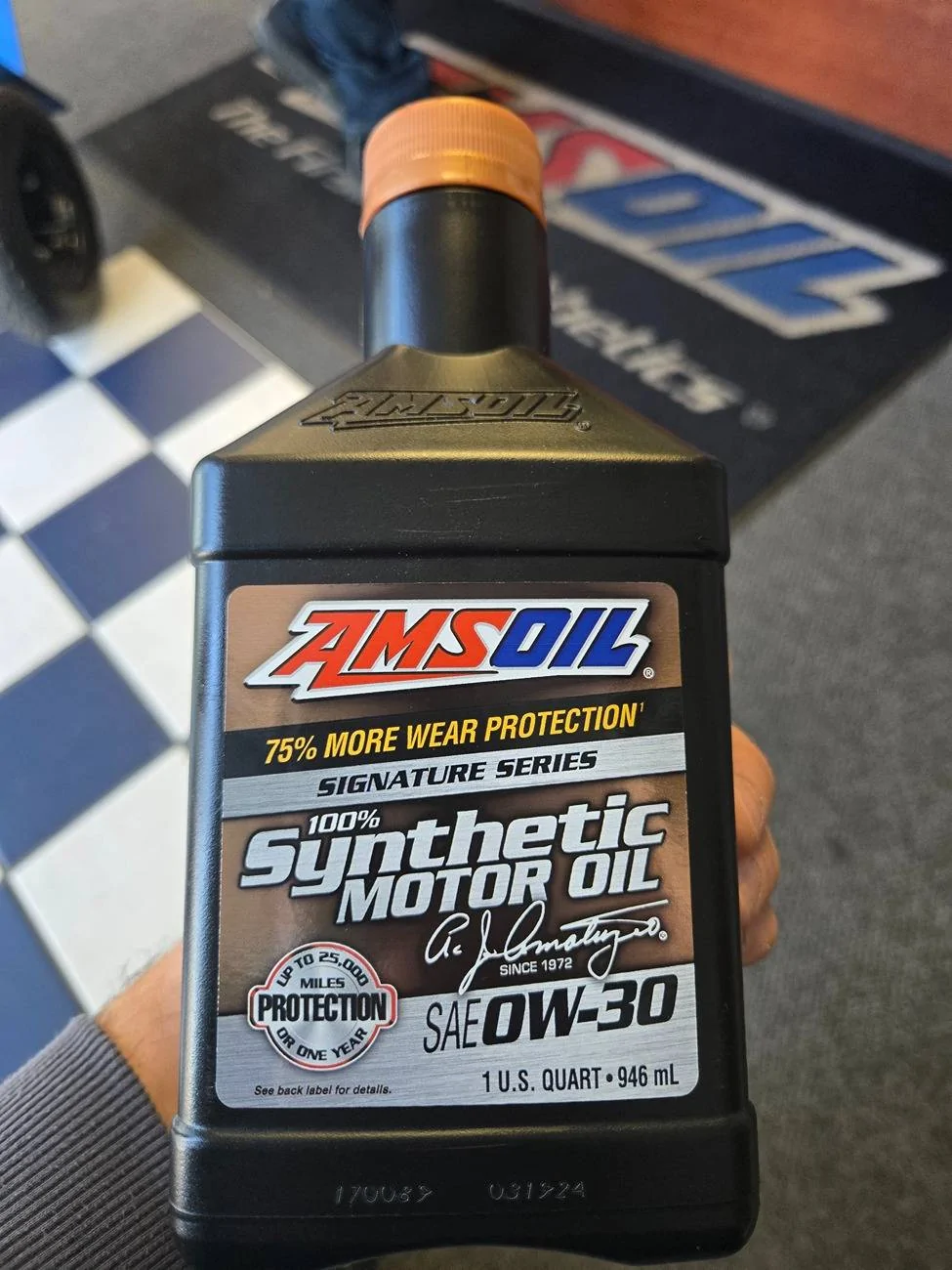

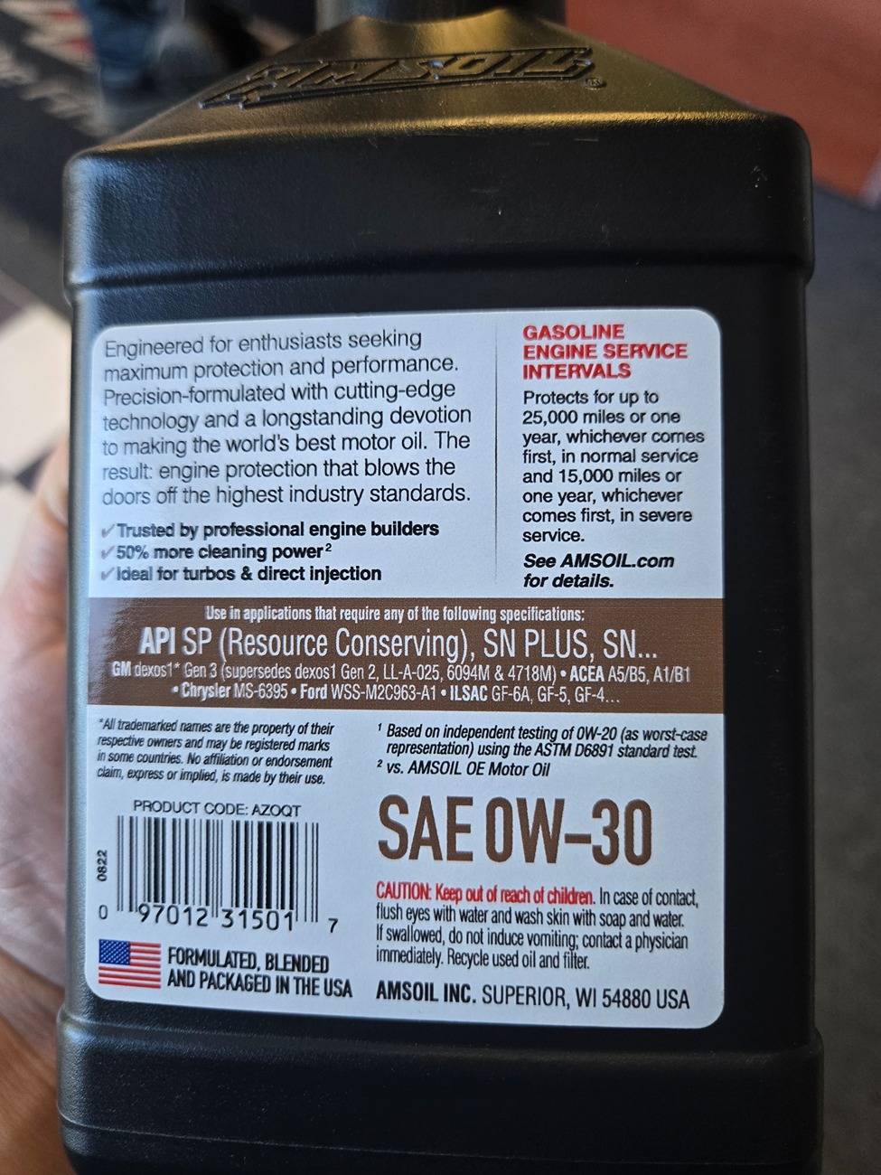

40 minutes of driving on the highway, 50-70 mph, 48 degrees outside. 3.6L, 8 speed, 4.88 and 37s. And 0w30 oil.

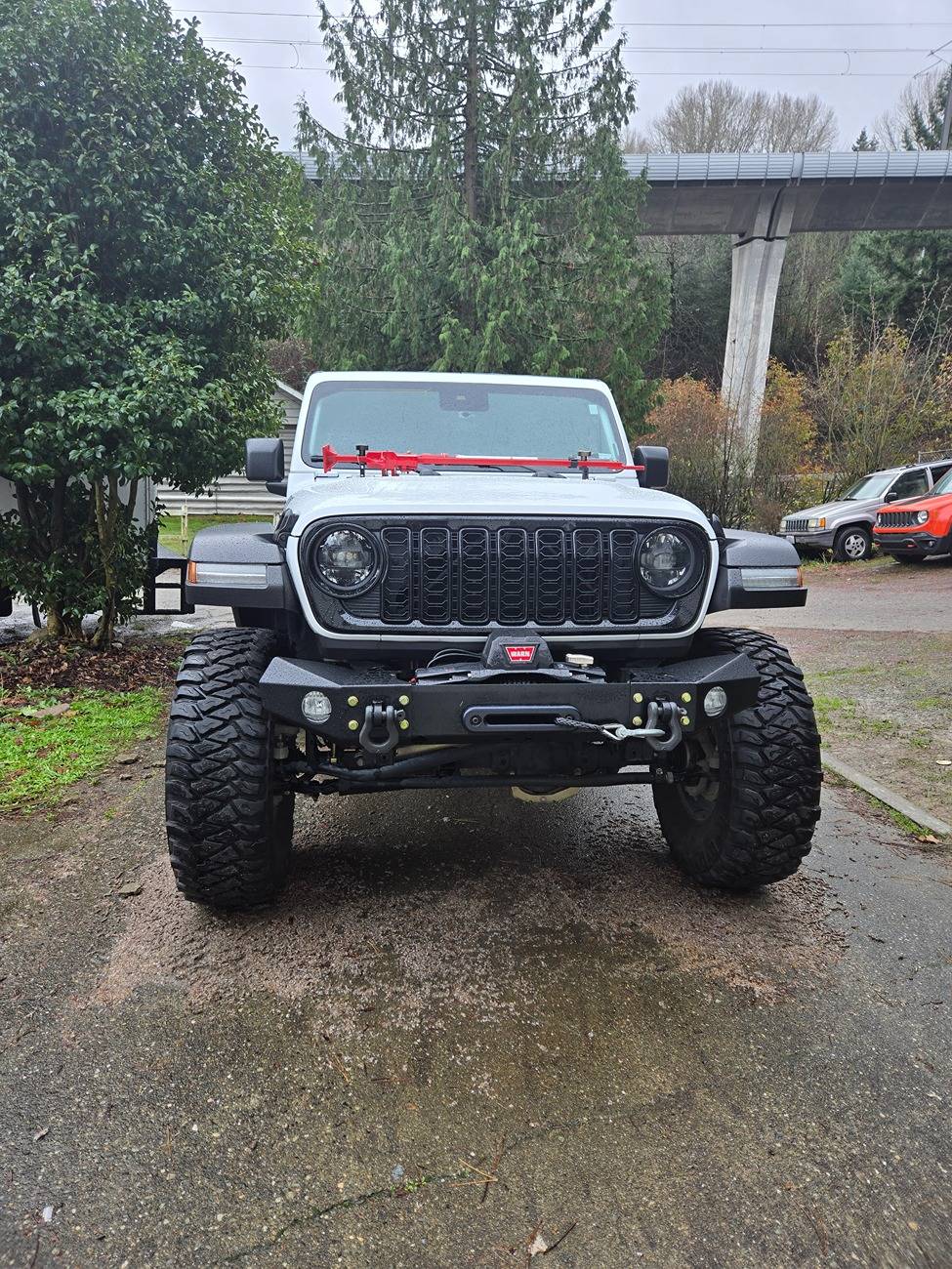

Probably. However it's far more dangerous in the event that's it's used as more than a decoration by the vast majority of folks who have them.
What other kind of Jack I could carry with me? Storage is so limited in my little two-door
