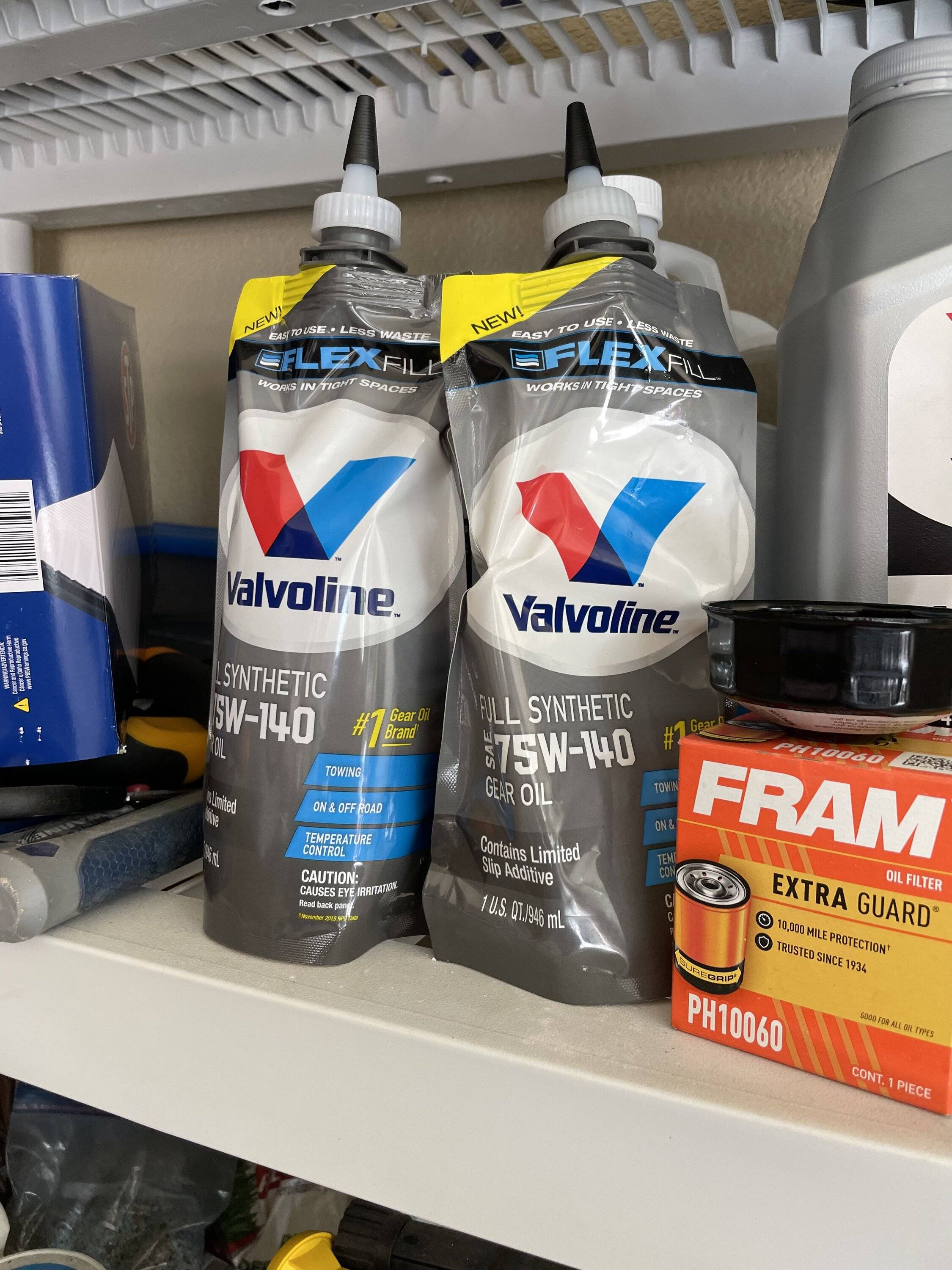

IF, if you are towing (have tow package) use Valvoline or Royal Purple 75w140 Syn. Gear Oil in the rear...
