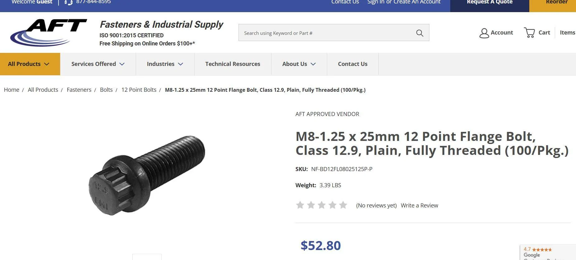

I received my Dana 44 AdvanTEK differential covers and am planning my install. I'm a bit concerned about the torque specs on the included grade 10.9 bolts. Dana specifies 28 - 33 ft./lbs. but some have reported the bolts breaking well before that amount of torque is applied. I found these 12.9 grade fasteners online and wonder if they would be a better choice? Most grade 12.9 hardware is 12 point or hex cap type. Has anyone used these or something similar they would recommend?
M8-1.25 x 25mm 12 Point Flange Bolt, Cl 12.9 | AFT Fasteners

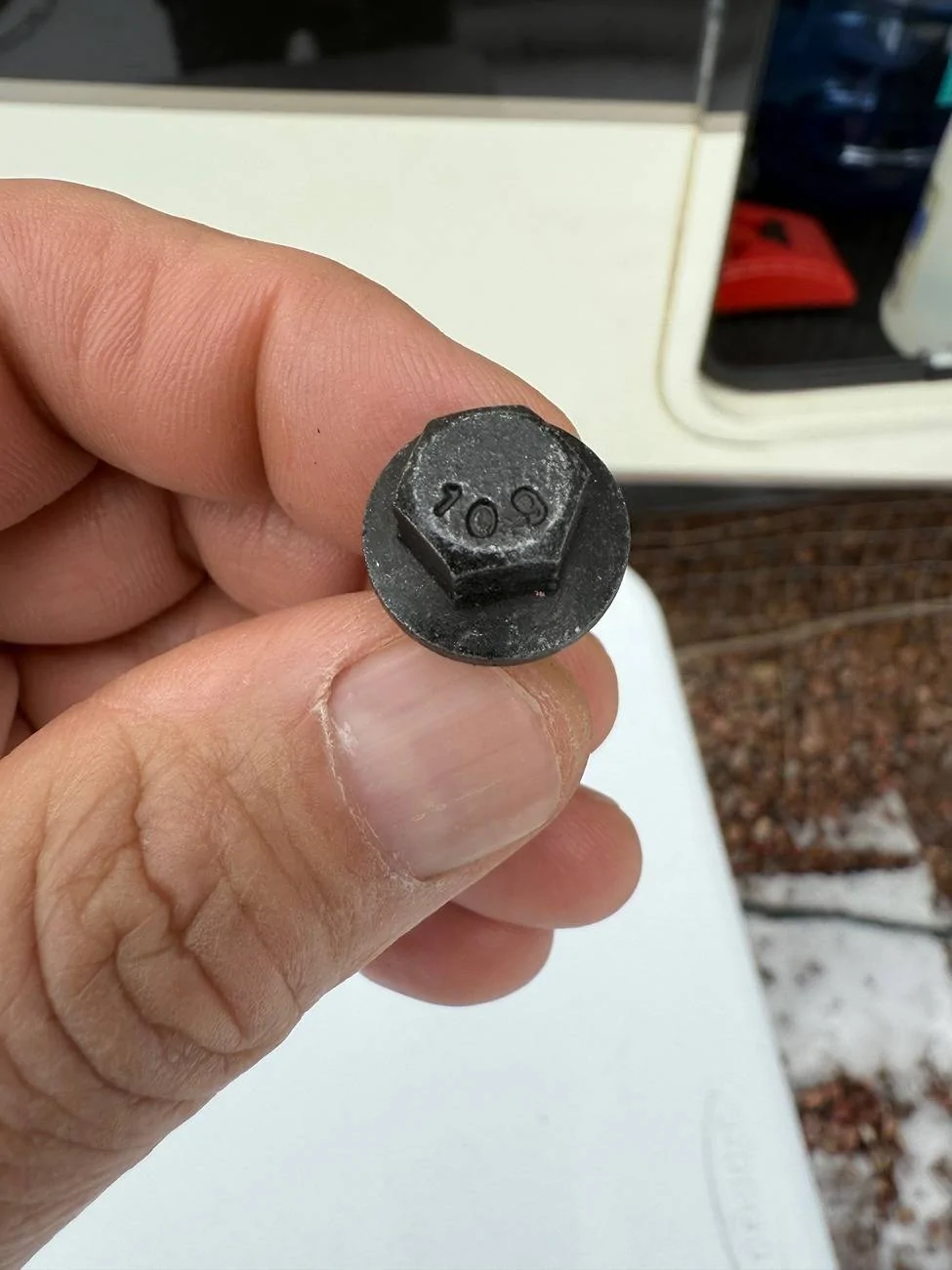

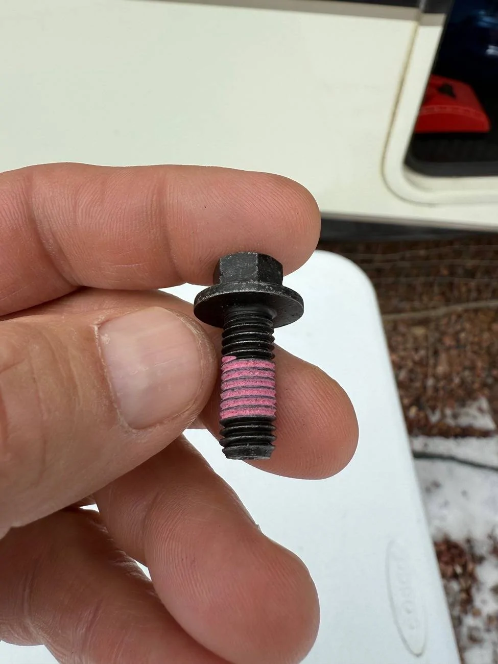

The supplied bolts have a type of pink thread lock which is dry to the touch. These are the bolts that people have reported snapping.

I would just torque those to 24 ft/lb and call it done. They won't back out due to the threadlock and plenty of clamping force to not leak.

Also FYI - I would not go to 12 point heads. Means extra tools needed on the trail to repair. Not likely to find someone with 12 points. If you do make sure you toss the right one in the trail toolkit.
Based on your advice, I think I'm just gonna give these a try at 24 ft/lbs. Thanks again.
