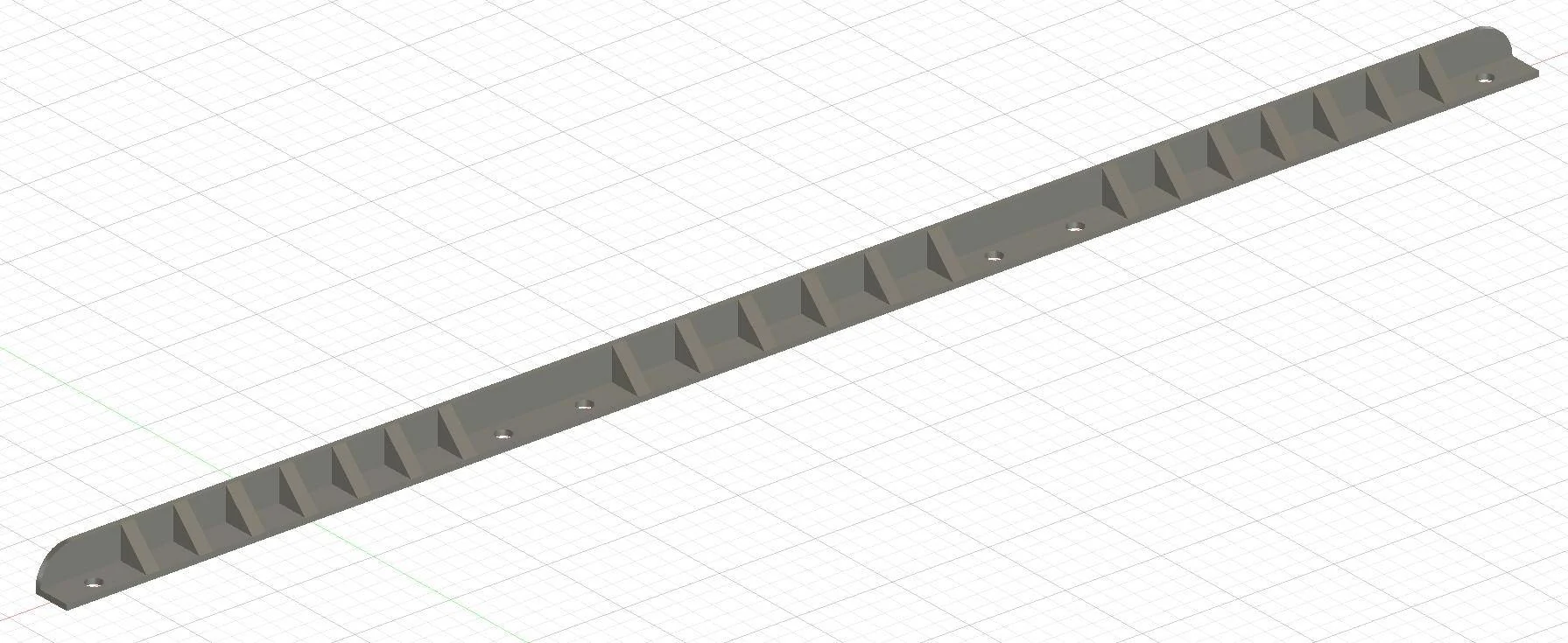

That mini air dam part number is B 2750, but I too had zero luck in getting them to sell/send me one.
Jeep Wrangler JL DEEZEE ROOF RACK WIND NOISE 1747779135749-cu
So the next best thing was to create one myself. I went the 3D printed route, but a piece of angle iron would probably work all the same. Attach with M8 bolts and nuts (the M8 bolt head is a 13 mm, which slides into the T-track).
Jeep Wrangler JL DEEZEE ROOF RACK WIND NOISE 1747781774175-0q
Tested the rack with this up to 80 MPH and no whistling or whooshing noises that I could hear.
