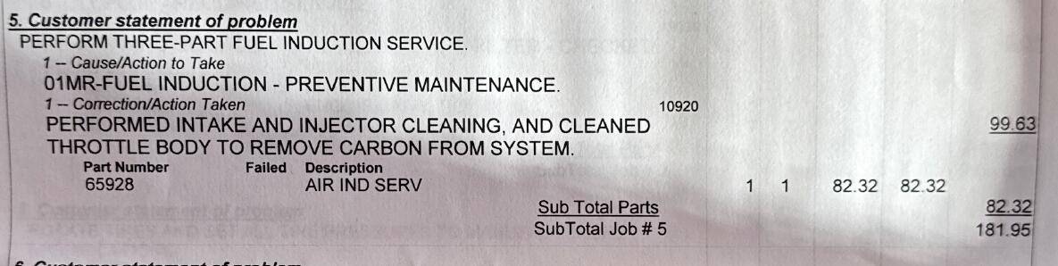

I have been "sold" on the throttle body story before, and I have paid for it and learned it the hard way that they dont do shit other than pouring a bottle that they buy from walmart like previous poster mentioned. Below is the line item from my Ram:
Jeep Wrangler JL DEALER RECOMMENDED SERVICES - advice? 1744682138605-c2
My philosophy these days is - I will only go to stealership for warranty work and default to no for whatever they have to say for anything else.
