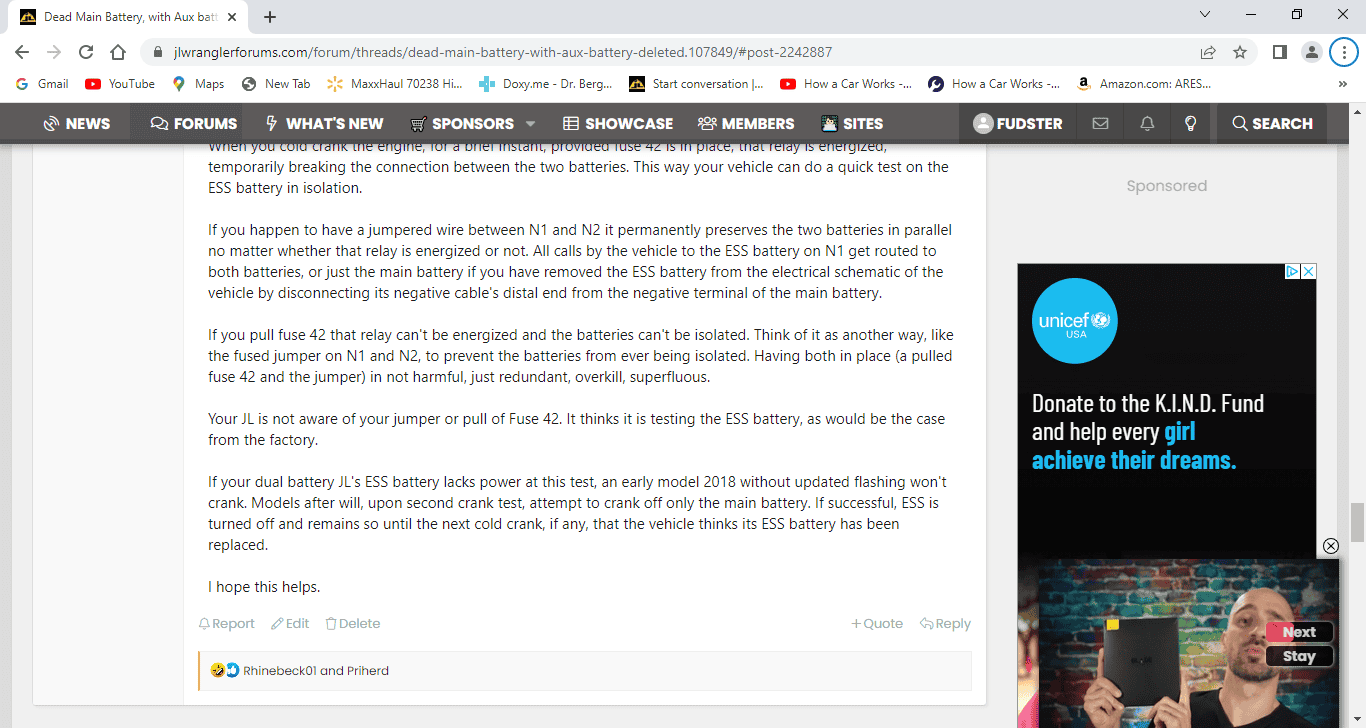

Hi again James:
I think we could benefit here from some understanding of how things work, and what's going on in addition to "James, connect this wire to this plug and be done with it."
You may know the below. I don't mean to insult. I just want to make it clear.
I'd rather not make assumptions so lets begin with what is a relay. That's an electronic switch, not to be confused with the one on the wall, which is a manual switch.
That wall switch turns on and off by you exerting energy with your fingers. A relay uses electrical current to control whether a switch is on on off, upon which an entirely different circuit that runs an appliance could arguably controlled.
There's lots of relays in vehicles and they serve several basic purposes. One allows a circuit that may contain large amounts of current to be turned on or off by another tiny circuit which just needs the energy to flip the switch. Maybe you need to control a DC circuit with AC, or vice versa. In other situations relays allow items that use different current to be energized together, even though they may operate on different current, or maybe a relay in an other situation guarantees only one thing works at a time.
Relays are classified by the current they control, the current which flips the switch, and whether the current that is being controlled is on/energized when no current runs through the switch (called a normally closed relay), or only when current DOES run through the switch (normally open.)
"Normally" means here: when the switch circuit is de-energerized, is the controlled circuit closed/on or off/open.
If you've got the 120 AC plugs in your rear, they're controlled by a normally open DC relay tied into the ignition. Provided the ignition is on, it closes a switch that allows the vehicle's inverter to convert battery power to the 120 A/C of household appliances.
In your JL is a normally closed relay that is energized by 12V DC and connects the two 12V DC batteries in parallel. When the relay is not energized those batteries are connected in parallel, such as while parked, and driving. The only time that relay is energized is for an instant at crank, and I believe during ESS events.
When you cold crank the engine, for a brief instant, provided fuse 42 is in place, that relay is energized, temporarily breaking the connection between the two batteries. This way your vehicle can do a quick test on the ESS battery in isolation.
If you happen to have a jumpered wire between N1 and N2 it permanently preserves the two batteries in parallel no matter whether that relay is energized or not. All calls by the vehicle to the ESS battery on N1 get routed to both batteries, or just the main battery if you have removed the ESS battery from the electrical schematic of the vehicle by disconnecting its negative cable's distal end from the negative terminal of the main battery.
If you pull fuse 42 that relay can't be energized and the batteries can't be isolated. Think of it as another way, like the fused jumper on N1 and N2, to prevent the batteries from ever being isolated. Having both in place (a pulled fuse 42 and the jumper) in not harmful, just redundant, overkill, superfluous.
Your JL is not aware of your jumper or pull of Fuse 42. It thinks it is testing the ESS battery, as would be the case from the factory.
If your dual battery JL's ESS battery lacks power at this test, an early model 2018 without updated flashing won't crank. Models after will, upon second crank test, attempt to crank off only the main battery. If successful, ESS is turned off and remains so until the next cold crank, if any, that the vehicle thinks its ESS battery has been replaced.
I hope this helps.
