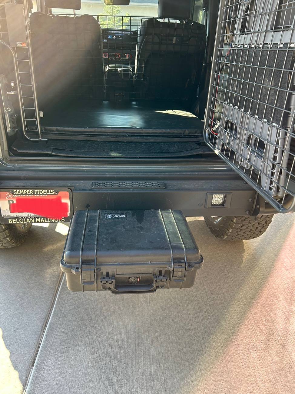

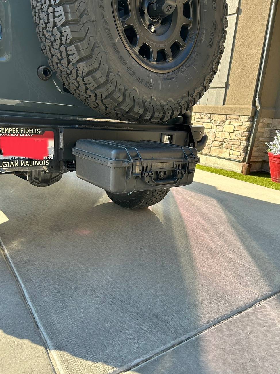

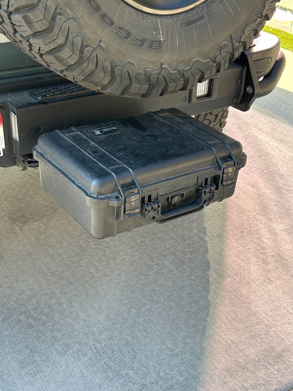

I am trying to come up with a storage solution, but before I begin, because I don’t know shit, some of the nomenclature will be off. I had the male end of what is inserted into the trailer hitch, the part where the ball is installed, ground off. I then had a 1/4 inch thick metal plate welded to the bottom of the part that was ground off. Visualize a hitch step, but larger. After it was powder coated, I attached a Pelican case 14Lx12Wx7H, to the metal plate. I used rubber washers to keep it water tight…..tested, via car wash. My intention is to use a much larger case, this was just a test. It worked wonderfully, EXCEPT the back up alarm activates when in reverse. I thought I was a brain surgeon when I surmised that an adapter plugged into the 7 pin trailer gizmo next to the trailer hitch would fool the computer into thinking a trailer is attached and deactivate the camera. WRONG! How can I keep the backup camera, but deactivate the alarm? I have a Pakmule for longer trips. The Pelican rig is just designed for day trips. I hate Roam boxes attached to roof tops and my motivation is to circumvent the rooftop thing. My dogs can also use the Pelican as a step.

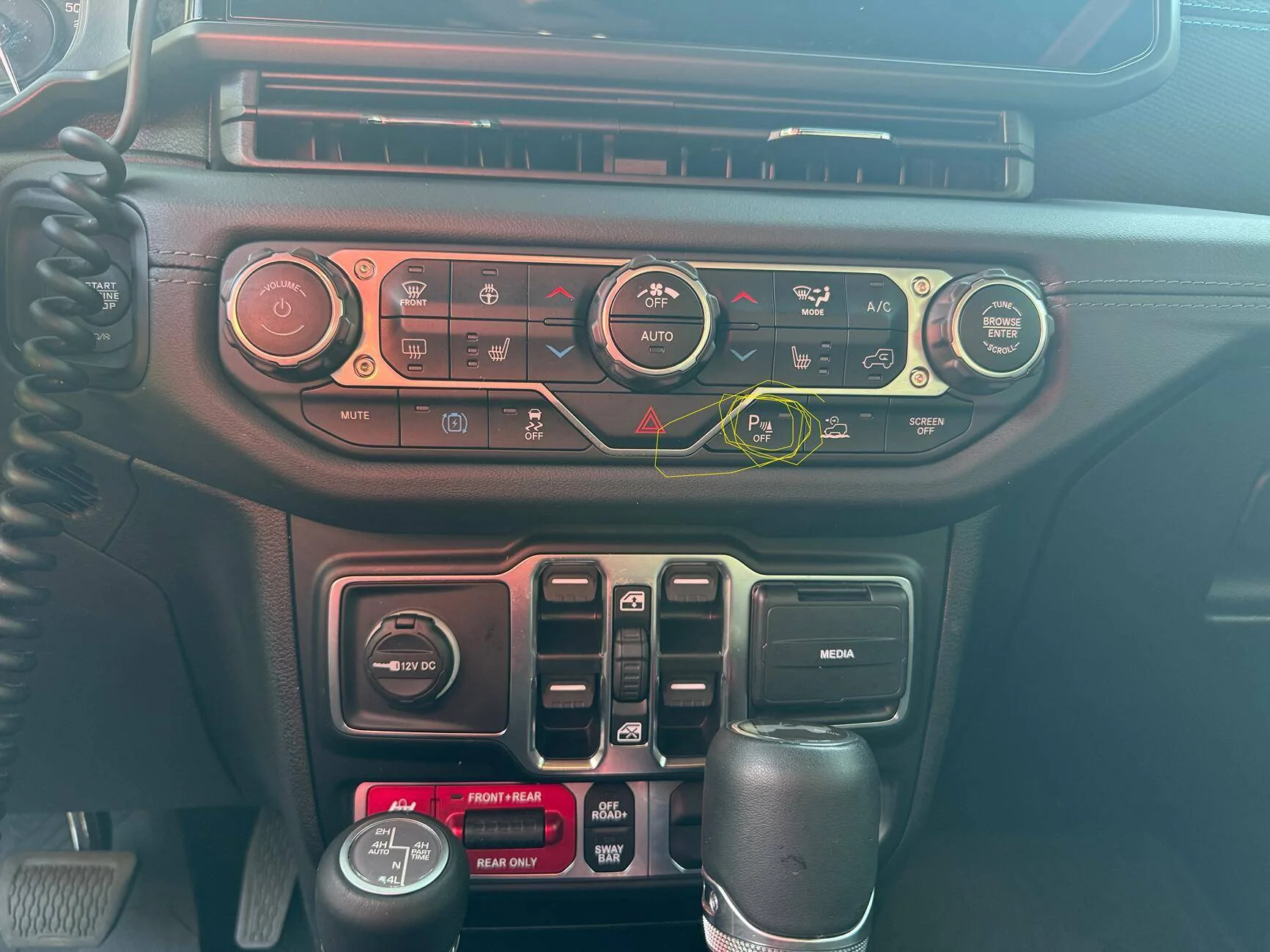

You could use the button on the dash to turn off the park assist, but it is possible that it will just turn back on when you next start the Jeep. I believe with the Tazer you can disable it as well.

Where exactly is the button? I’m pretty sure my 2024 does not have it.

That button is indeed for the four little sensors on the back bumper. Idk about the two in the taillights.

Got it, but the button doesn’t turn off the back up alarm, but I believe it deactivates the cross traffic alarm. I had my wife test it😎
It disables the proximity backup alarm. It stays disabled until you hit the button again.
