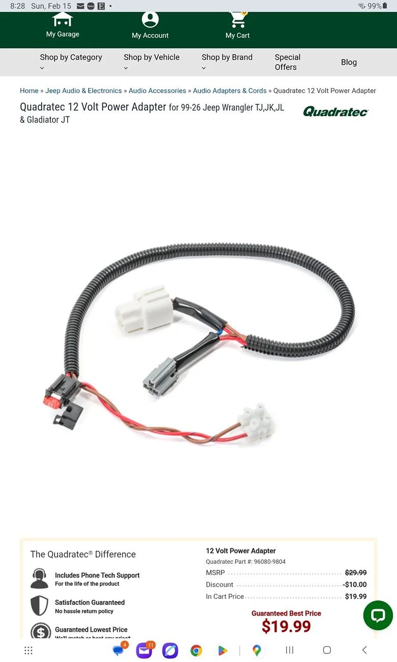

I've used the power adapter that was posted by @lsufan. It's a little more difficult to install on a post 24 Jeep but it works well on the front and rear 12v outlets.
