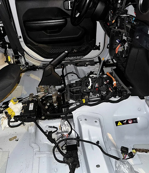

There is no dealer in my country and no new parts for this car, just donors.

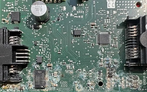

I cleaned all the parts, connectors and harnesses, the only thing I found was a corroded RF Hub.
Jeep Wrangler JL Damaged Modules 265c73e5-cf41-424f-9ec7-ab3aee6c1d8f copy
I can open and close the doors with the key fob, radio, air conditioner and power windows working, but car won't start.

If the RFH is corroded like that then it indicates the entire interior was submerged. Your wiring will be heavily compromised, and all electronic components below that water line must be replaced. You will not be able to visually find all the damage, and once corrosion has begun you cannot clean it. It is a chemical reaction and will return. Stuff that works now will fail in the near future.
If you have like-donors you will need to transplant the entire interior. Some modules can be properly re-configured with Jscan, but immobilizers like the BCM and RFH must be replaced with new and programmed using the factory wi-tech scanner.
I do not know where you are located or what your current circumstances are, but it would be significantly cheaper and easier to repair just about any donor vehicle than to tackle this repair. Using MSRP prices you're talking tens of thousands in parts, not including labor. Unless this is a passion project, then by all means go for it. Cips posted a good run down of a similar repair. Most exterior items are weather sealed other than stuff like the PDC.
