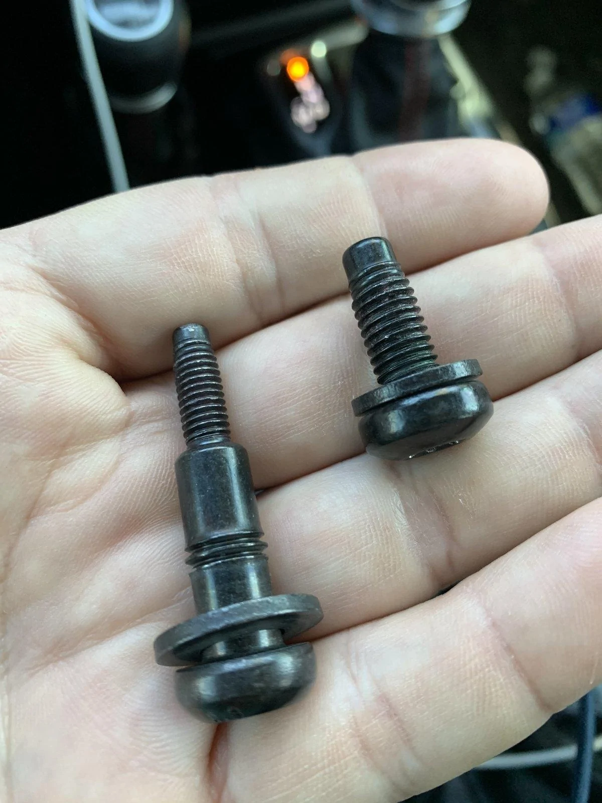

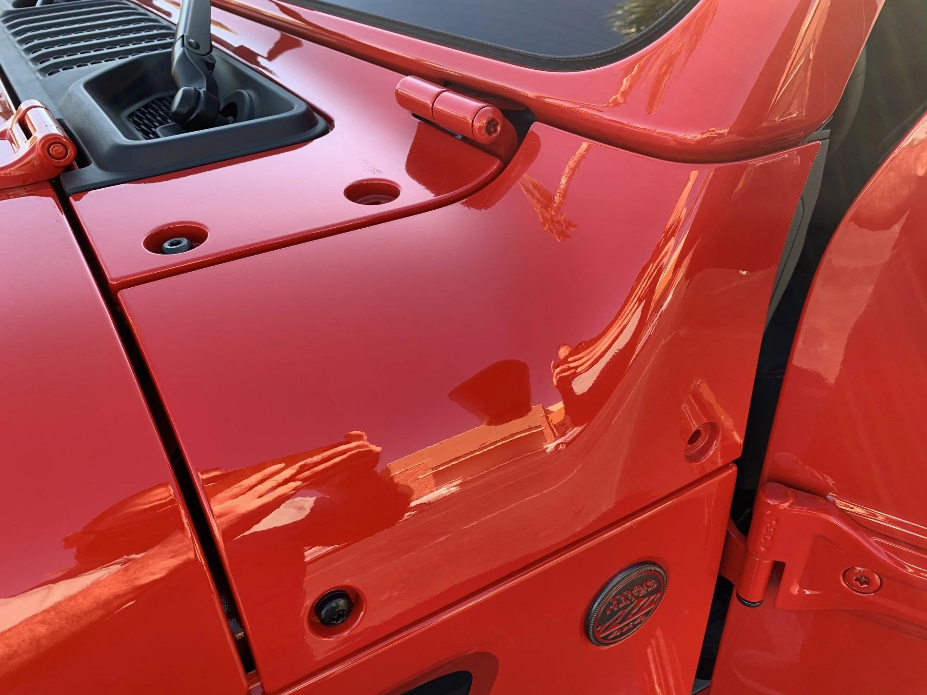

Figured it out. The sizes are M6x1 and M8x1.25.
I’m trying to figure out what the specs are for these two screws. I thought they were M6-1.0 and M8-1.5, but I bought screws in those sizes at Lowe’s to test and they don’t fit. I want to order some security screws for my pillar mounts.
Any help is appreciated.
Part Nos.
06512441AA
06512430AA

If I remember correctly your listed sizes are what I used.
I ended up just replacing the smaller one with security bolts as I couldn't find anything to match the odd shoulder set up on the longer one.
