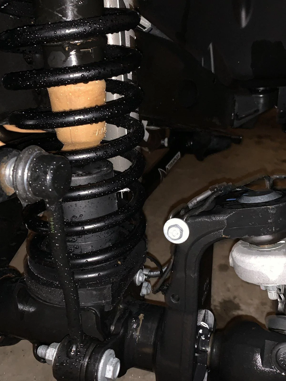

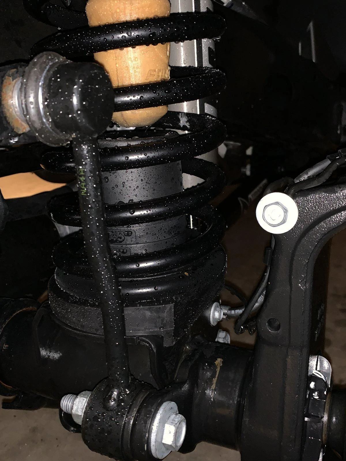

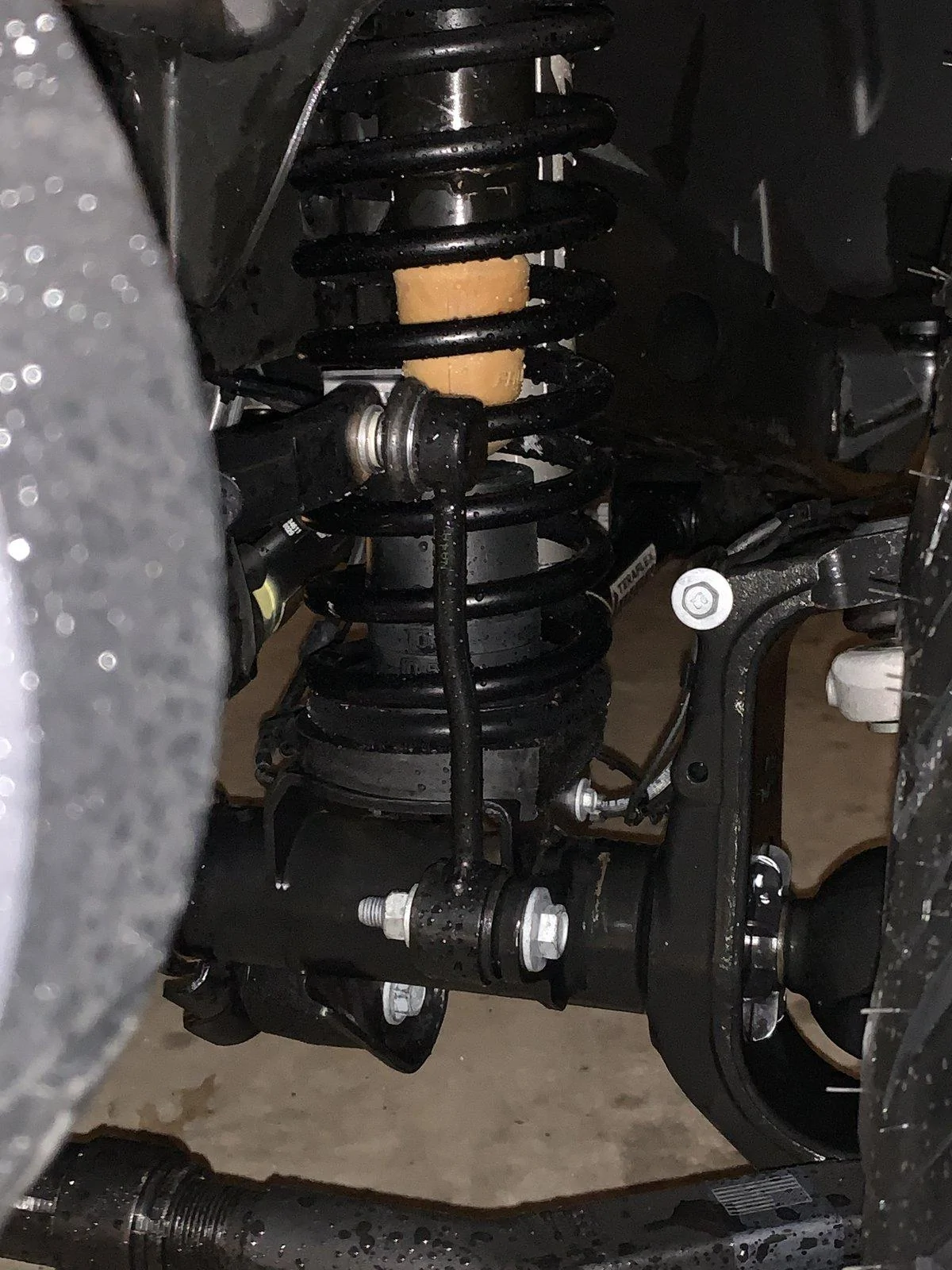

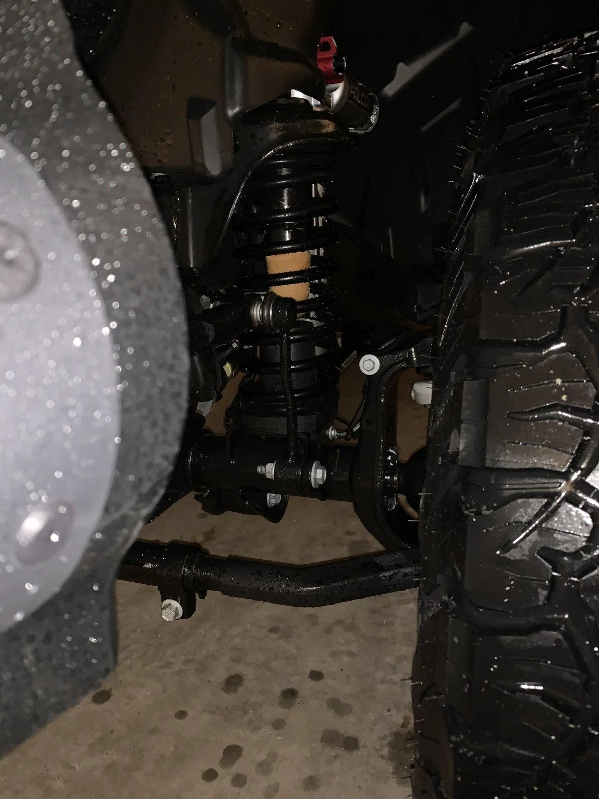

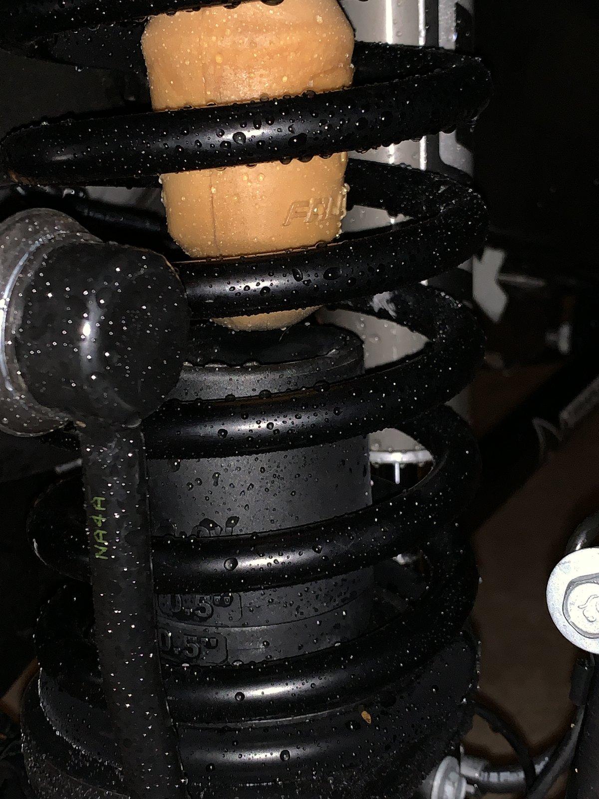

Had my teraflex 2.5 installed last week.
Does this look right for the bump stops and jounce bumpers? Shop is telling me the jounce stops coming off the bump stops are progressive and are disigned to make contact. To me them see to close.

I have the same setup and they are really close, hasn't been an issue with some mild wheeling, but I think TeraFlex should specify if you use those progressive jounce things with the 2.5 you might go to a lower bump stop, I did the same as you in the front and left .5 inch off there rear since it didn't come with that many, and that has plenty of up flex in back.

Spoke to Teraflex this morning. Was told there is one too many shims in it. I still think that makes it too close. Going to take one out and see. But i agree the instructions to say if you plan to use the progressive bumps then do “X”. Maybe someone from @TeraFlex can jump in and give some insight.

That makes the most sense, further confusing to me though since I am a MOAB and don't have the high flares so the instructions say to add extra for me, oh well, guess we can just run what looks best

Rubicons will need 1 of the small spacers for 37" tires and the Sport/Sahara use 3 spacers.
Remember that those jounce bumpers are meant to compress a decent amount (roughly 75% of their size under compression) so even with it touching regularly, it shouldnt translate into the cab for most users (everyone experiences ride quality differently)
