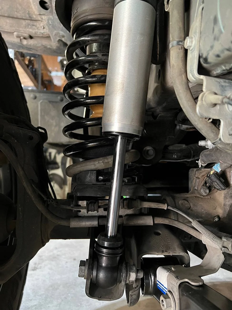

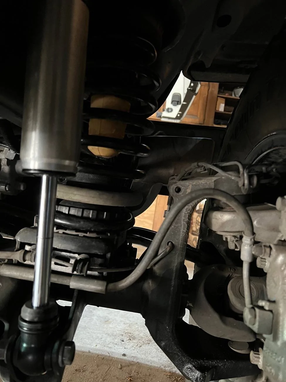

Jeep Wrangler JL Teraflex ST1 Extended Bump Stops IMG_7782
Jeep Wrangler JL Teraflex ST1 Extended Bump Stops IMG_7783
First picture is drivers side with 1” extension.
second picture is passenger with 2” extension.

The chrome shock shaft has approximately 5" of up travel until the rubber stop hits the shock body, that's what I originally called shock compression. I'm probably using the wrong terminology but imagine if the foam "jounce" was not there and only the metal tube was there. The distance between the metal jounce tube and the 2" extended stop is approximately 4.75 inches. With the 1" extended stop it is approximately 5.75 inches. With the foam jounces inserted there is approximately 1.5" of space between the jounce and the 2" extended stop and 2.5" with the 1" stop. I tried to capture the distance in the pictures.

Ok, gotcha, the numbers weren't what I expected until I realized the Fox shock jounce wasn't included.
I would personally go with 1", the TF progressives with the Fox jounces should offer adequate protection in even front compression.
Is that enough for clearance for your chosen wheel/tire combo? I think you'll be okay with the shock in flex, but gets kind of funky since the pads and jounces don't hit square. Even then, you'll likely be okay because it will be significantly lower speed.
