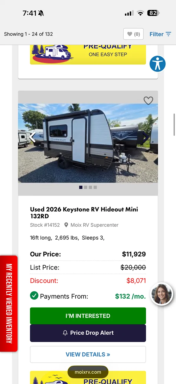

I have a 2026 JLU Sport and we are wanting a camper. But I’ve read SO MANY opinions about it I don’t truly know what to do. If I get it, I’m getting trailer brakes installed for it, but I want to be safe and not destroy my powertrain haha we love to camp, but it may not be wise
I do have 285/70R/17s on the jeep with stock suspension— falken wild peaks m/t

Looks like from info on Blue Compass RV website:
Empty weight 2595 lbs, with cargo weight of 1305 lbs, for 4500 total gvw. Tongue weight is 335 lb rating, (loaded correctly).
You at least those numbers for tow rating, and hitch rating.

Your JLU Sport is rated to tow 3,500 lb.
Per the camper advert, it's 2,695 lb.
That gives you 805 lb. of load in camper. This includes everything you put in the camper - food, clothes & bedding, dishes & cooking, etc. And, Any water at 8.34 lb. per gallon.
Your JLU Sport is rated for 350 lb. tongue weight. If you spread your load, this shouldn't be a problem. But, you're still going to want to use a weight distribution hitch to keep the Jeep from squatting.

I've just taken a look at hitches. There are many on Amzn in the $35 - $60 range that will technically work. But, max out at exactly the capacities of your JLU (3,500 tow, 350 tongue). These hitches leave No safety margin. Please, spend a little more and get a Class III hitch. Although it falls short of a true Class III, Here is a hitch rated at 5000 tow and 500 tongue, and is the highest rating I can find for the JLU. I guess the JLU frame strength (or lack there of) makes a true Class III (8,000 tow, 800 tongue) an unnecessary waste of strength/weight.
BTW, the 2,695 camper weight probably does not include the LP tank or its contents (40 lb). The 12v battery weight is not included either. Grand total around 100 lb.
