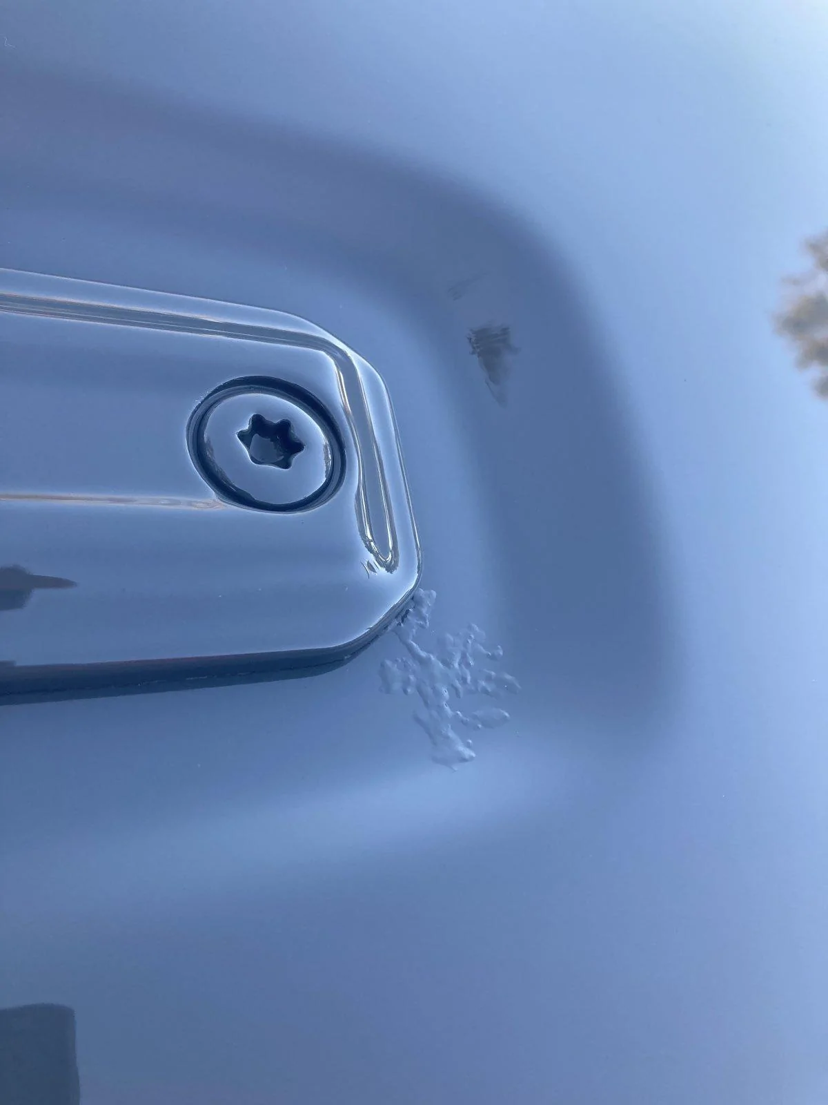

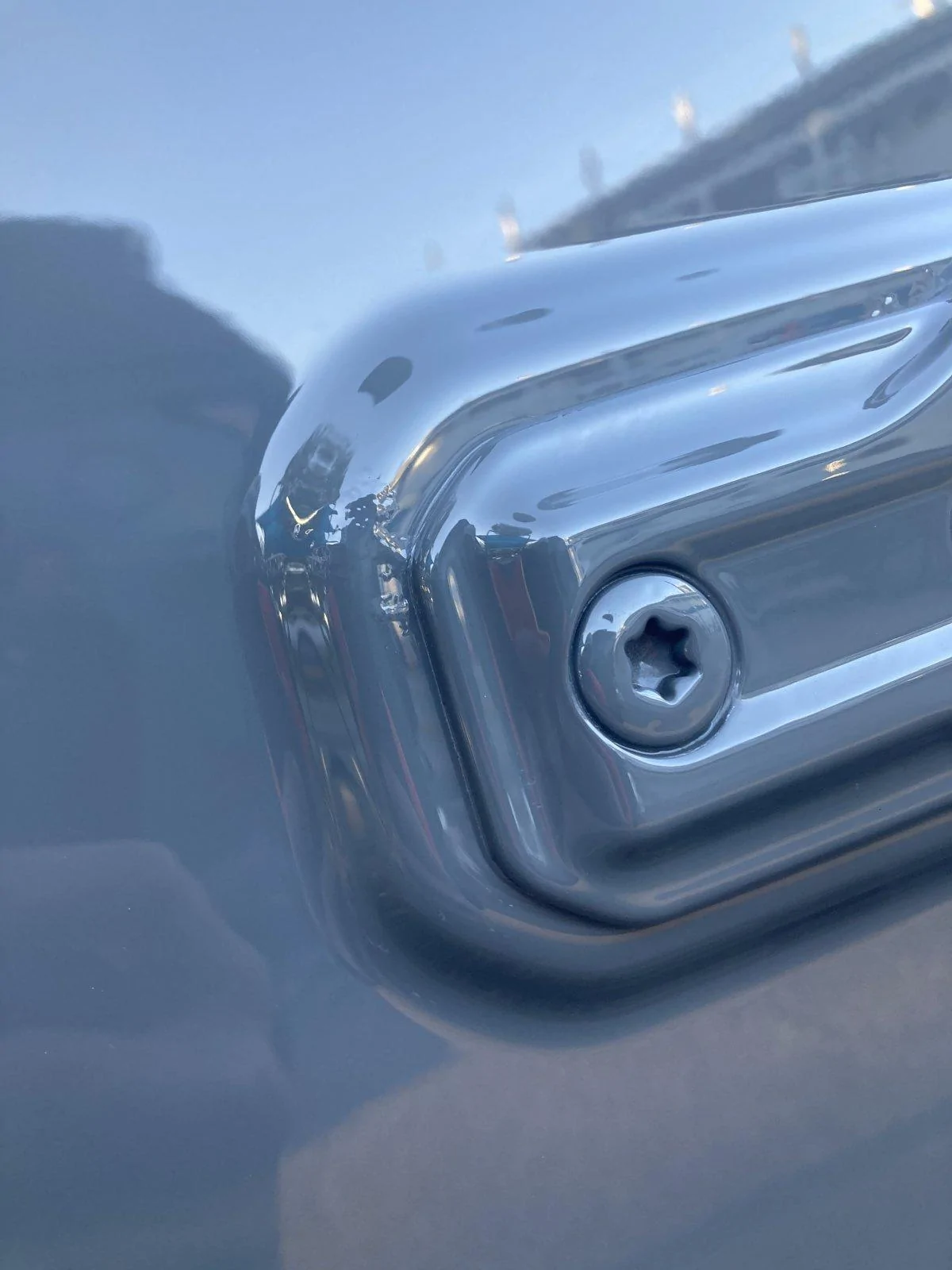

My 2020 Jeep is my 6th and by far the best minus a few things but the most disheartening is the corrosion. I noticed the hood hinge only months after owning it but it’s out of sight out of mind but now the doors hinges are corroding and I’m not happy at all. Here’s the most expensive Jeep ever using the most sophisticated assembly lines, paint processes and materials but never before has a prior Jeep of mine done this so quickly. I baby my Jeep like most others so it’s not from neglect but poor design, process and execution. I have the stingray color, love it and the clear coat shines like no other so the fix Jeep has put in place to repaint my Jeep is completely unacceptable because I can spot a car that has been repainted a mile away and seeing mine when I walk up to it daily would irritate me knowing it has not been in an accident. Matching the clear coat texture, color and blend on 4 doors would be obvious and not fair to any owner who buys a brand new vehicle to have something that looks new. If we bought used that’s one thing but we didn’t so has anyone been successful in a full door replacement? Sadly even a née door is a temporary fix until they get to the root of the problem and fix it but it seems Jeep has just accepted the poor quality seeing this was happening 2 years before mine was made on 9/20. Thank god I leased this one, I can see it hurting the resale and if they don’t take care of it I have the luxury of handing them the keys and getting my deposit back, well at least I would try ?

My 2018 JL has what appears to be rust under the paint just below the window on the driver rear. I took it to the dealership for this and a steering issue last week. The body shop manager told me that due to the location and the fact that its rust they will not warranty the repair and would be requesting a new door from FCA... Well he called me yesterday to tell me that FCA denied the replacement, and that they informed him that I needed to take the vehicle to another Jeep Body Shop that will warranty the repair...
Has anyone experienced this run around? Its annoying enough that a jeep with 10k miles has a phantom steering issue and corrosion already, but FCA's response is to tell me I need to shop it around town for someone that will assume responsibility. This is my first Jeep purchase and likely my last after all this.
I just took mine to see if they guarantee mine
Same problem
Corrosion in the hinges
The dealer told me, they don’t do it any more, because they don’t have a solución
Any one knows something I can do
Or where to go
Same problem
Or where to go
just got mine back from the dealer they sprayed both sides of all the hinges, but has to go back due to orange peel and some fisheye....Im over it to be honest Ive never had a car that has this issue....so frustrating....really thinking about getting rid of it.....and never buying a mopar product...spend half my time going back and forth the dealer not my idea of having a brand-new vehicle

Im literally on my way to pick mine up right now from the body shop they covered everything under the power train warranty it took about a week I had this issue on all 4 doors and a little on the hood so maybe you should try another dealer
