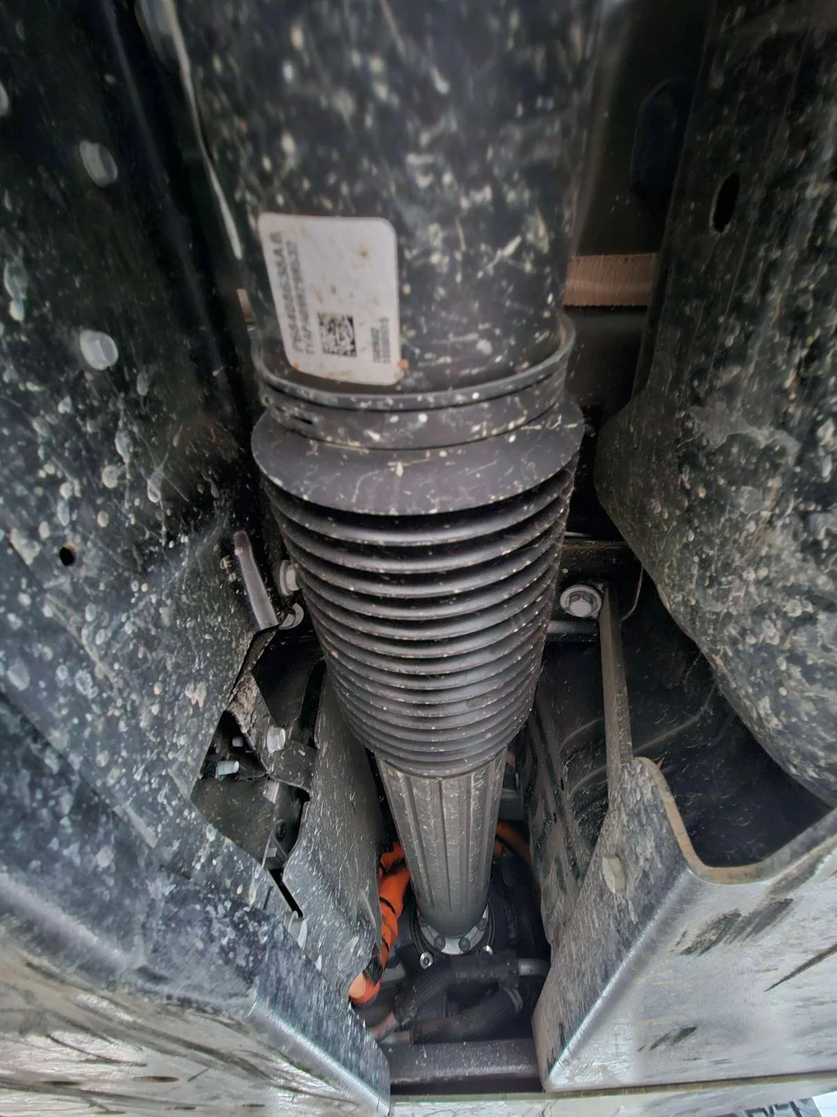

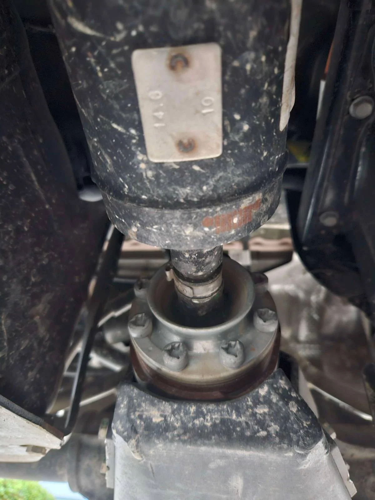

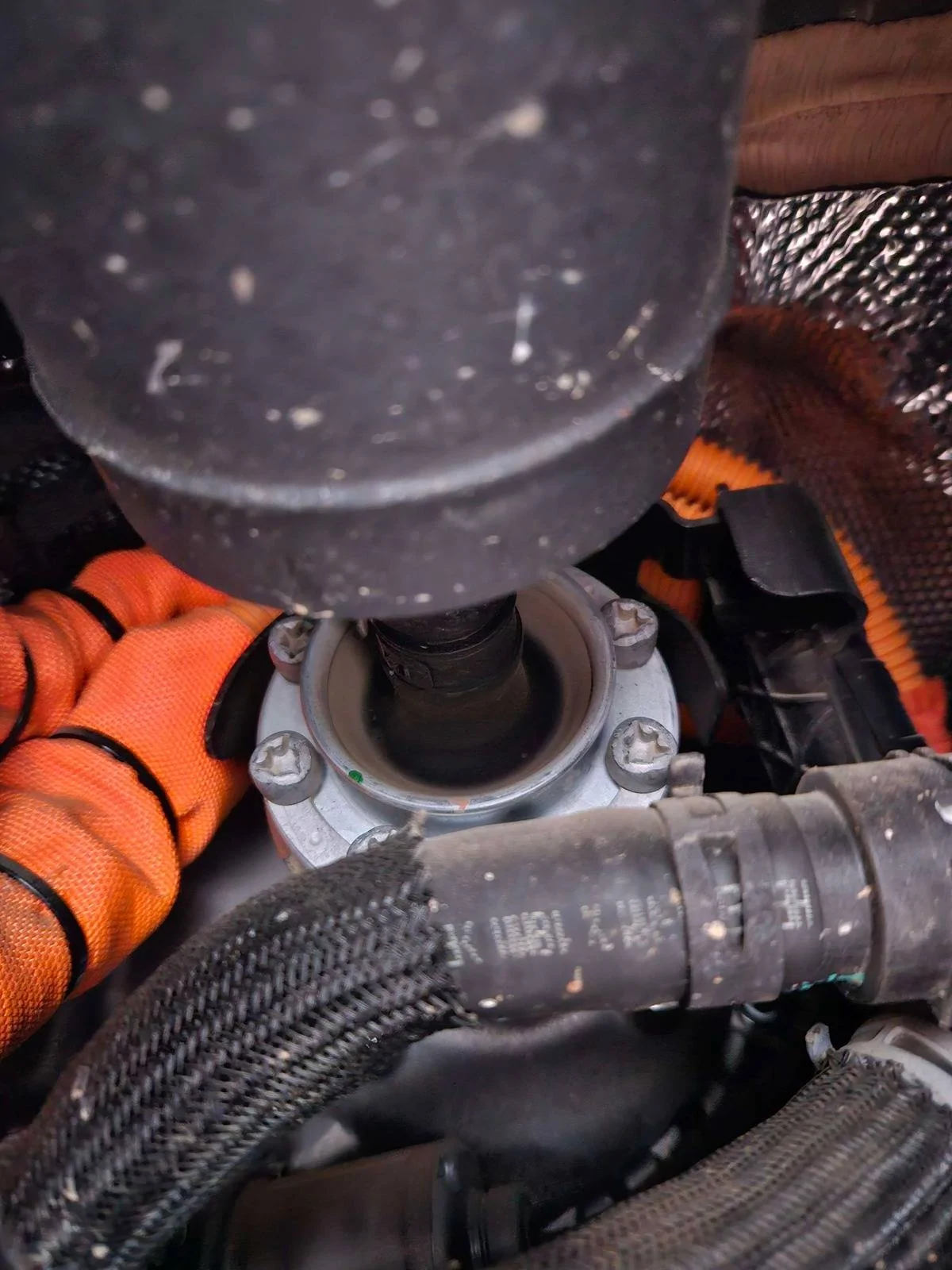

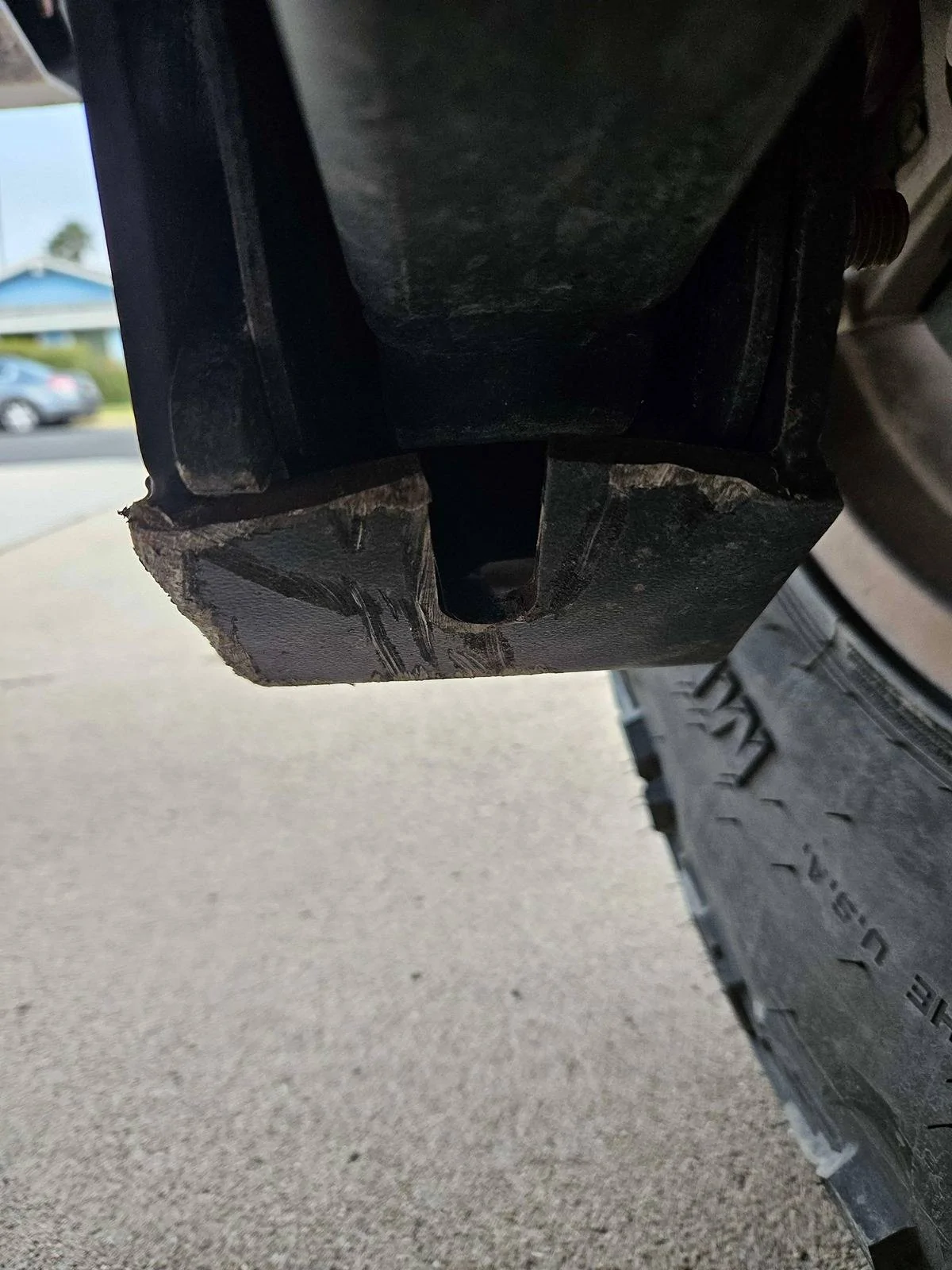

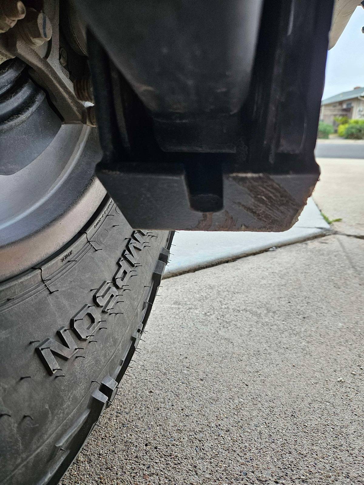

Yeah, I have a Tom Woods front driveshaft, but still rocking the stock rear. Not ruling anything out, but with the surrounding skidplates and no visible damage to the rear driveshaft, I think it's unlikely. I see some ripped up residue where some wheel weights used to be so I am hoping that's the issue. That said I did bonk my driver-side rear LCA skid pretty good, so much that it deformed.
Stock Rear Driveshaft, no visible damage

Driver rear LCA skid plate damaged

Passenger rear LCA skid plate for comparison

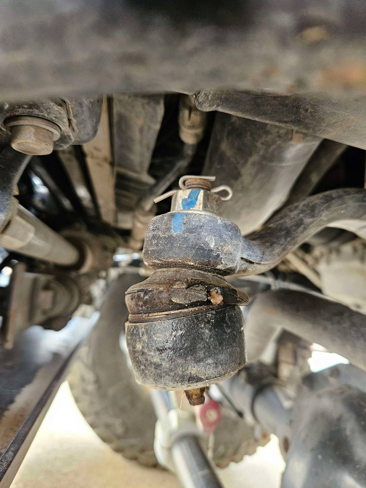

Crawled underneath before my scheduled inspection tomorrow and I am pretty sure I found the culprit to my highway vibrations. A torn drag link/pitman arm boot.
