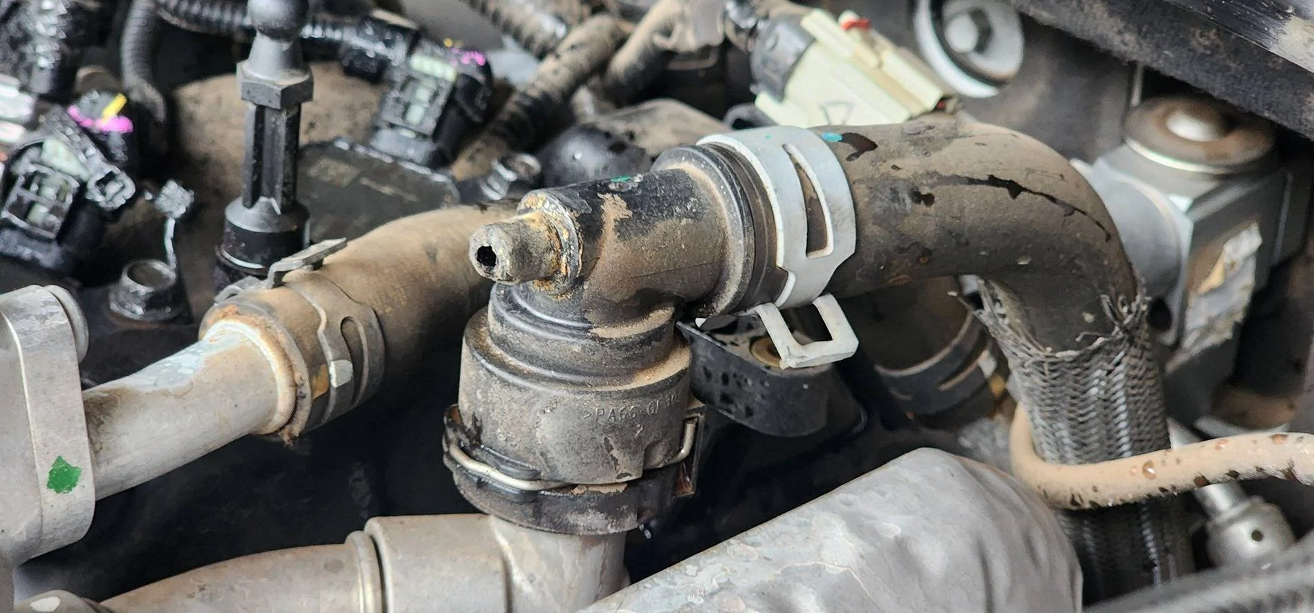

Changing out the spark plugs and snapped the coolent hose connection just under the manifold where it gets small and routes out.
Do I need to order a full coolant hose assembly to get the T connector and insert it? Or can I just order the T itself? The rest of the connection is fine.
In one of the photos, the red circle is where the break occured. Also, now assuming air is in the system, any advise on burping is welcomed thanks.
2019 Jeep 2L Turbo.

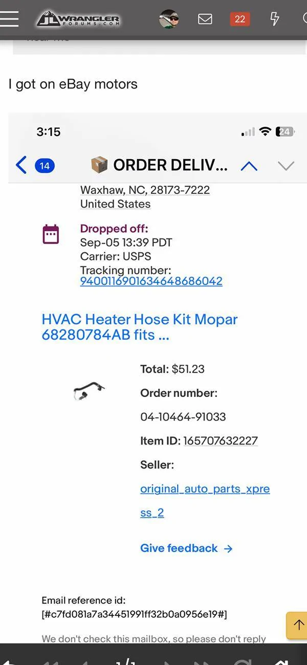

lol I did the exact same thing!!!! 2019 JLU with 2.0 …this is what you have to buy. It only comes this way is what I found couldn’t just but the valve….hope this helps

Thank you!. I ended up just ordering this now and thankfully the shop down the street has one. Such a stupid design, but then again there's a lot of stupid things about this engine.
Luckily I'm already at 60,000 mi so I'm just going to do a drain and flush I guess of the coolant now. Some silver lining.
