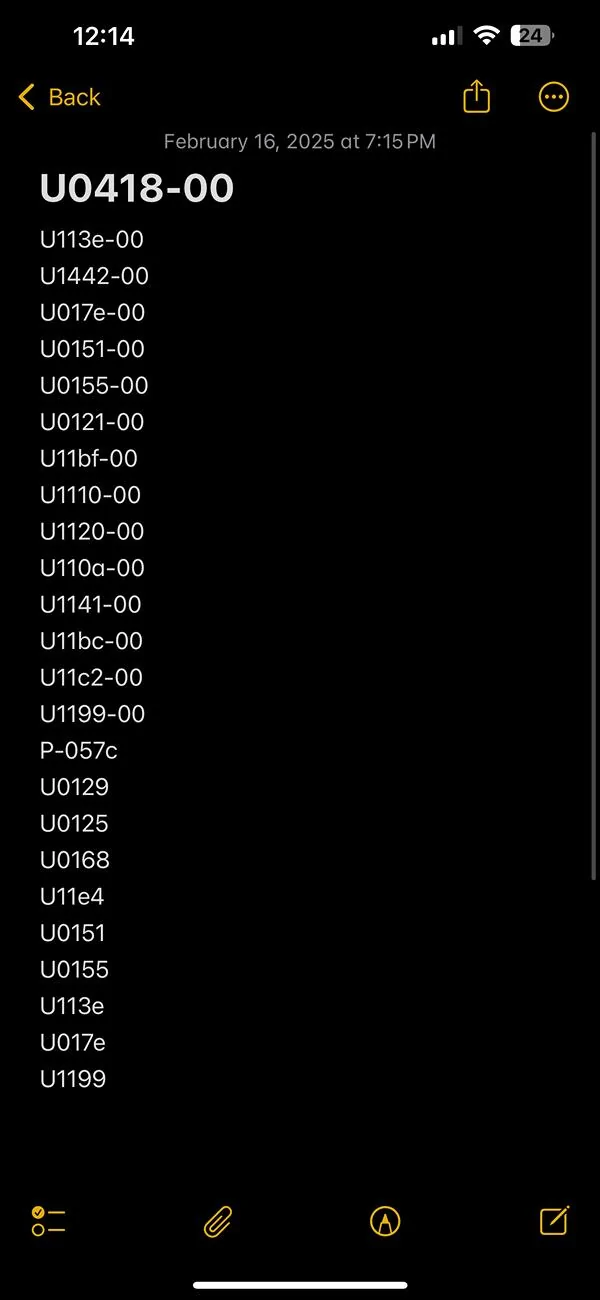

Hi, I’m at an absolute loss here. Since march of 2023, my now ex husband has put in LED headlights and ever since then no matter what myself or a dealership does, I’m constantly throwing codes and it eventually makes my 2019 unlimited sport useless. The headlights have been rewired, everything is wired correctly, and I have anti-hyperflash modules on the wa.y. Tonight my wrangler threw 15 codes, some talking about my CAN BUS and one talking about my LIN BUS systems. I will post the notes screen that I have of every code it has thrown from the beginning to now. I really need a fix to this and soon. Side note: the light bar and cube lights are NOT connected so they can’t be an issue as of now. I just started a new job and I really need reliable transportation.( this is my only vehicle) I don’t have money to take it to a shop, so if I can do anything at home, please let me know. I have three mechanic friends who work on mopar that can help me, I just can’t expend so much in a shop fixing it…

Replace the green star connecter located behind your glovebox. Common issue on 2018/2019 model years. Remove the glove box and it's right there, easy 5 minute replacement.

thank you thank you!! I’ll get this and see what happrns!! Hopefully the next update is positive!!🤞🤞
