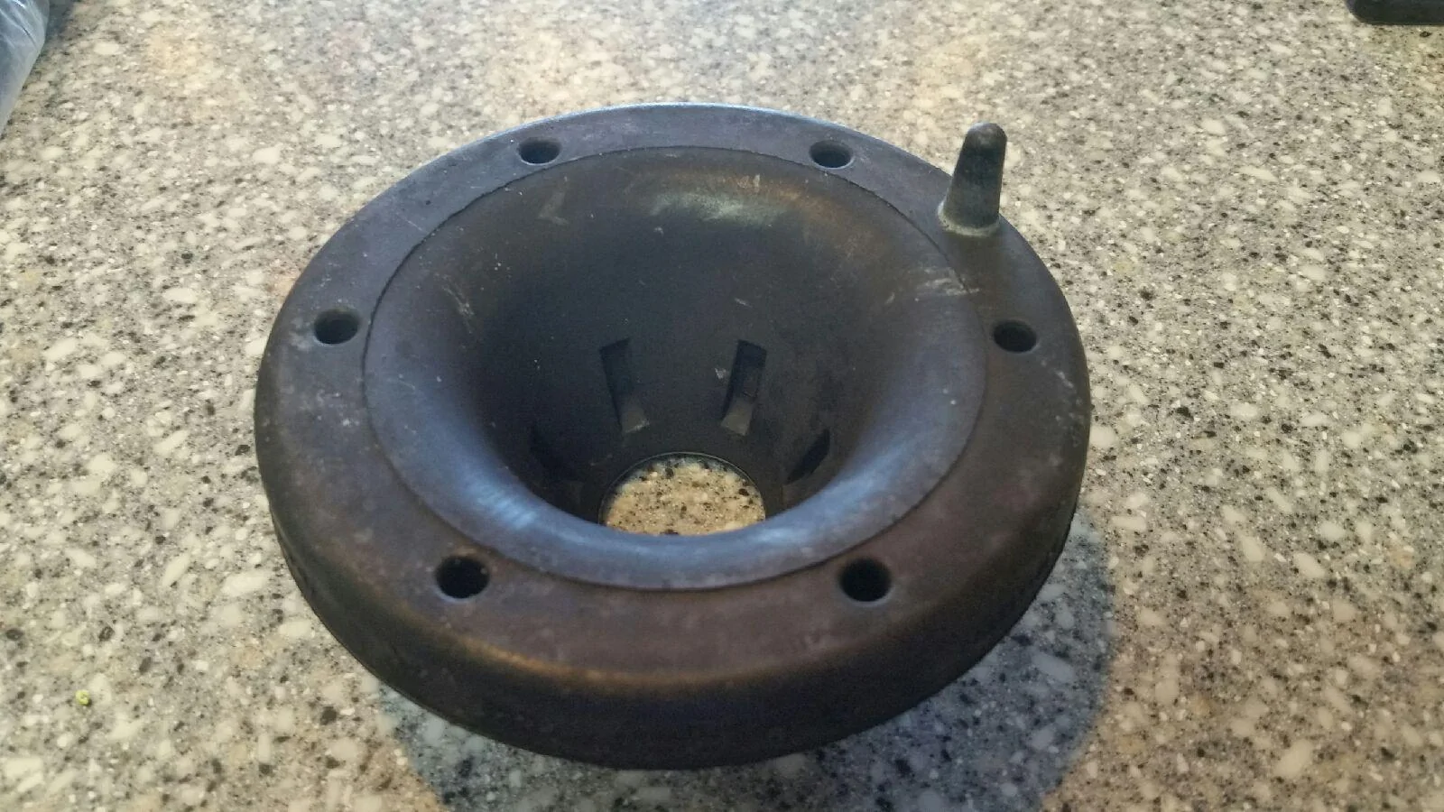

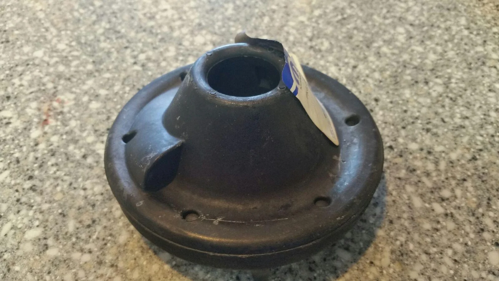

The "ISOLATORS" are designed to "CENTER" and "SECURE" the coils in there assigned positions--
If you "SHAVE" off the cone that does the major alignment of the isolators--the coils are going to change there upper positions--
When you "FLEX" the axles the mounted coils are "TESTED" in their position and I've had coils "MIS-ALIGN" without any isolator changes--
I wouldn't recommend altering the isolators AT ALL--either get taller rear coils, or cut 1" off the front coils--
Good luck
