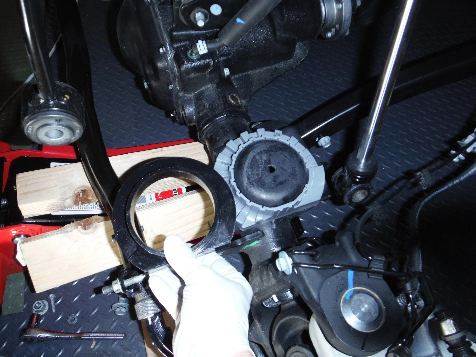

Tip for anyone thinking of ordering these, part no. 61003 for Mopar lift kit. Don't. I have two sets and both LH pads are wrong. USA Alloy nicely sent me a replacement set, but that was wrong. I read somewhere about these being wrong. They have contacted me on helping them figure it out but I find it odd that I am the ONLY one that has tried to use these and found them wrong.
Has anyone used these and have them fit the Mopar lift springs?

I had the same problem.. Ordered from Quadratec first set were wrong; requested replacement and between the two sets I have one set of the correct spring pads. Now waiting on additional suspension parts.

You need Part # 07005 for both sides not # 07007... Hope that helps:like:

Ok, I have another 7005, so yes that will work. Why can they not figure that out? (USA Alloy). I wonder how these differ from Mopar since if you study a Mopar it does not have a gradual curve, but a "bump" in the curve which makes no sense with hard spring metal. Yes that helps, as I thought it was just that the 7007's were wrong and 7005 was specific to one side only.

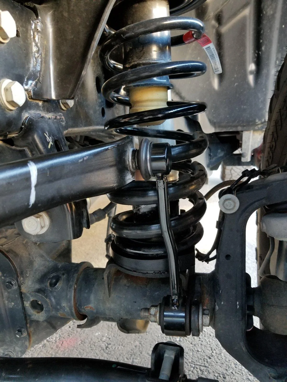

sorry I didn't realize you were using USA Alloy kits as I thought you said Rock Krawler kit.
The RK kit works perfectly with the Mopar lift. We're using it on our Jeep with no issues.
