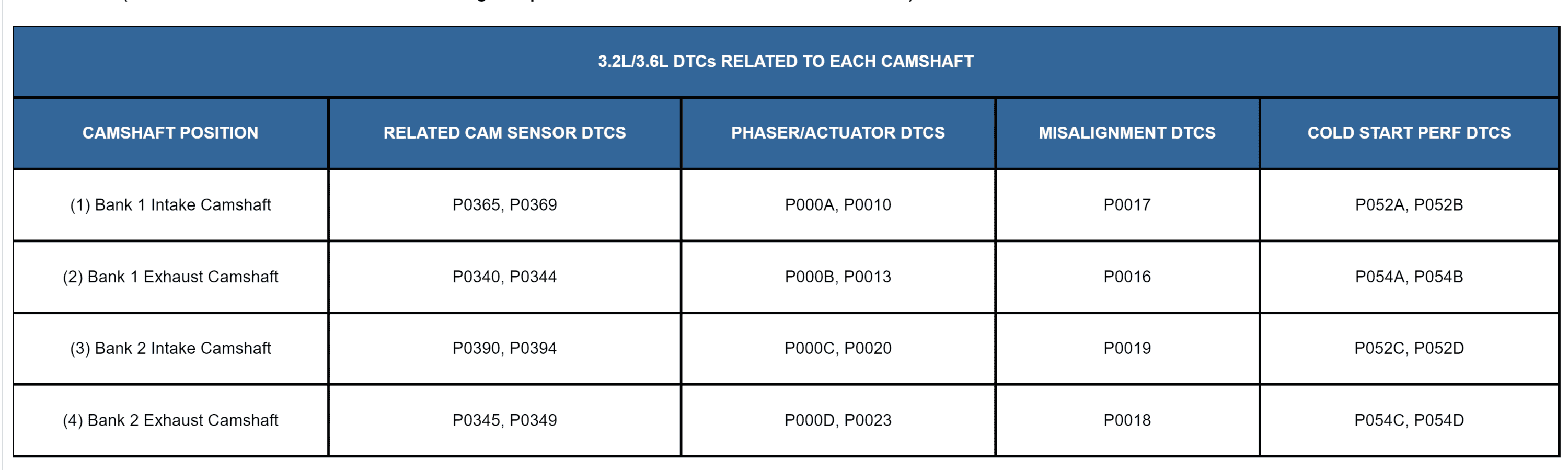

P000C indicates your left bank intake camshaft. If you've had the right bank replaced for this code you've unfortunately wasted your money. Since you've already replaced the left bank intake cam phaser, actuator, and camshaft you're in a tough spot. Do the oil flush procedure I mentioned. If it DOES return, then replace the left cylinder head. If it STILL returns, you need an engine. I've only seen one get to the engine part. This seems to only be an issue on upgraded 3.6L, as the older one doesn't have this issue. This chart should help you and others in the future with cam DTCs.

The DTC itself is thrown because the VVT solenoid is actuating the phaser and the cam sensor sees it doesn't respond fast enough. The phaser is actuated from oil pressure that runs through the camshaft once the solenoid pin is released.
Anything that interrupts that oil flow will cause the DTC. Unfortunately it's hard to determine *what* oil passage is clogging or why. It could be a manufacturing defect, long oil change intervals, metal build up from rocker arm failure, or something as simple as a poor quality or faulty oil filter. Considering you've got the sensor, actuator, phaser, camshaft, cylinder head, and finally the engine block itself allowing this system to function you have a decent range of failure points.
My recommended diagnosis upon seeing this code is to do the following in order; informing the customer of the entire repair process from the start so they're aware of the potential costs.
1. Get the engine oil hot as hell then change it with a new OEM filter
2. Swap cam sensors between banks to rule out a faulty sensor
3. Replace camshaft, phaser, and actuator. The lifters/rockers are unrelated to this function.
4. Replace the cylinder head
5. Replace the engine
This is listed in cheapest/easiest to most expensive. While the cam sensor swap doesn't cost anything parts wise (unless the code chases), the labor required is significantly more than the oil change. I've encountered this code and the other verities of it about two dozen times or so at this point over the years. Since you say the code comes and goes you can see how it's definitely a partial clog type of thing.
