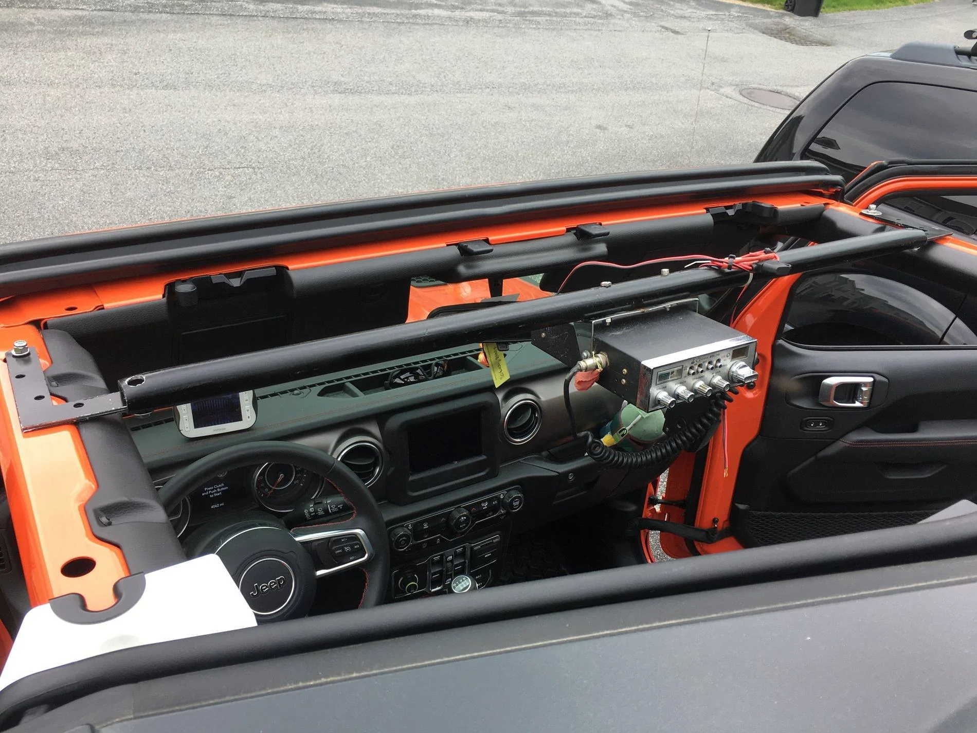

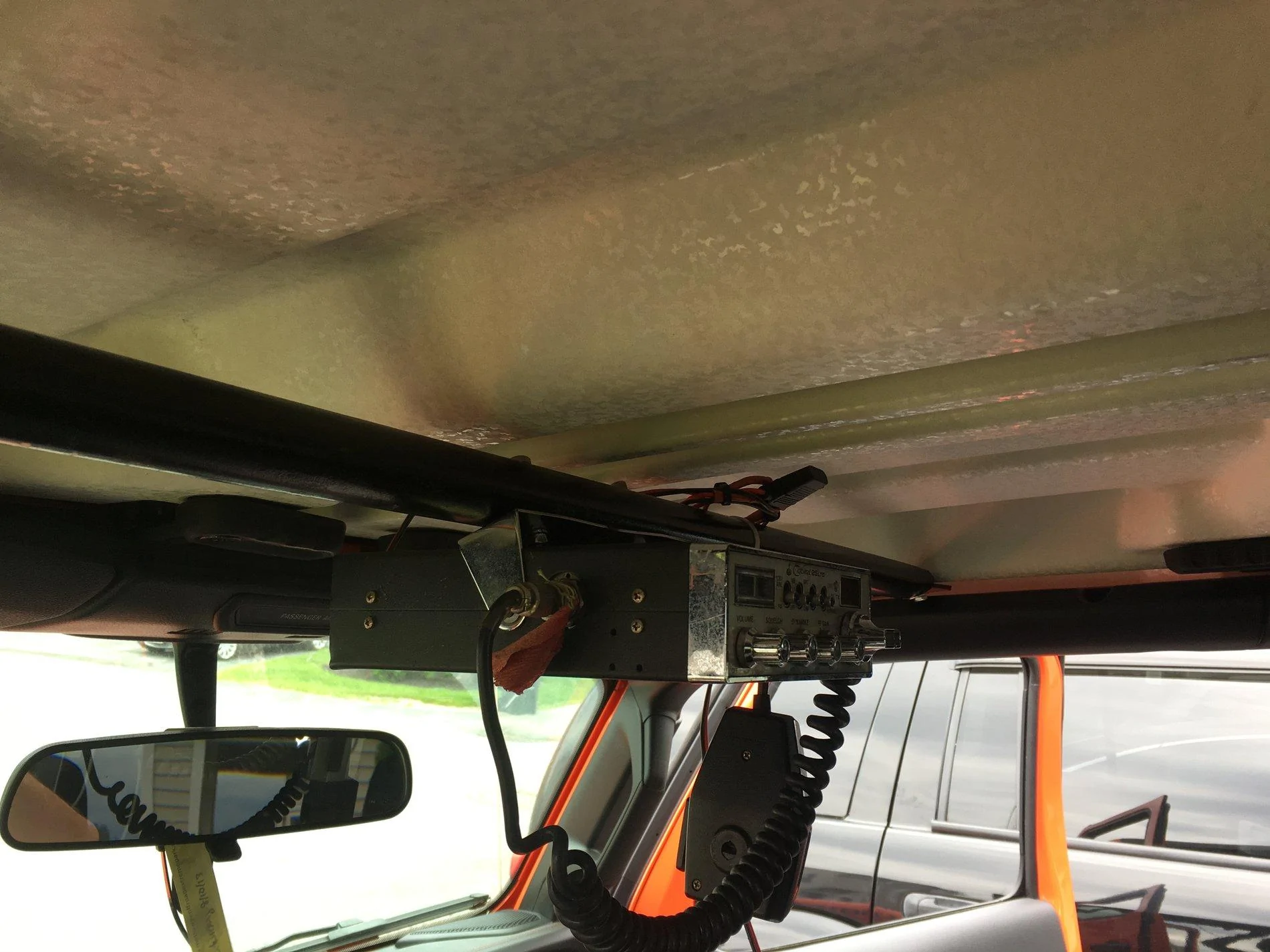

I had one for my TJ, modified it, and it was great. Then I put on the soft top and realized I needed to make some modifications. The issue I ran into is the L brackets I used for the CB bracket were only about 1" wide and the top of the roll bar has ~1" hole that a plastic nub on the door surround sits in to line it up with the bolt hole for the bolt that holds the door surround to the roll bar. So, it's currently in my garage waiting for some alterations. I bought some large hardware that should work but I need to drill some holes and bolt some things. Between work, family, and Thrashing to get my Jeep work done before vacation, I haven't had the chance to sit down, upload my pictures to my lap top, and do some write ups. I promise, I will have one in my build thread. Update to cost: It cost me a little more than $23 now that I needed to buy some new hardware and a Step-up drill bit. Still, cheaper than some of the online alternatives.
I wanted an overhead mount so I could hear the speaker while tooling down the highway with the top down. I didn't want to deal with any aux speak jacks, wiring in extra speakers, or wiring my CB into my infotainment- or-whatever system. I've used mounts that mount radios lower in the cab, but I've always had issues with hearing those clearly, which can be problematic when you're giving directions to a trail head to a large group over CB.
Finally finished mine! I’ll have to do a write up with more pics at some point if anyone is interested. I already had the steel tubing from my previous mount so it cost me $23 and a grinder wheel.

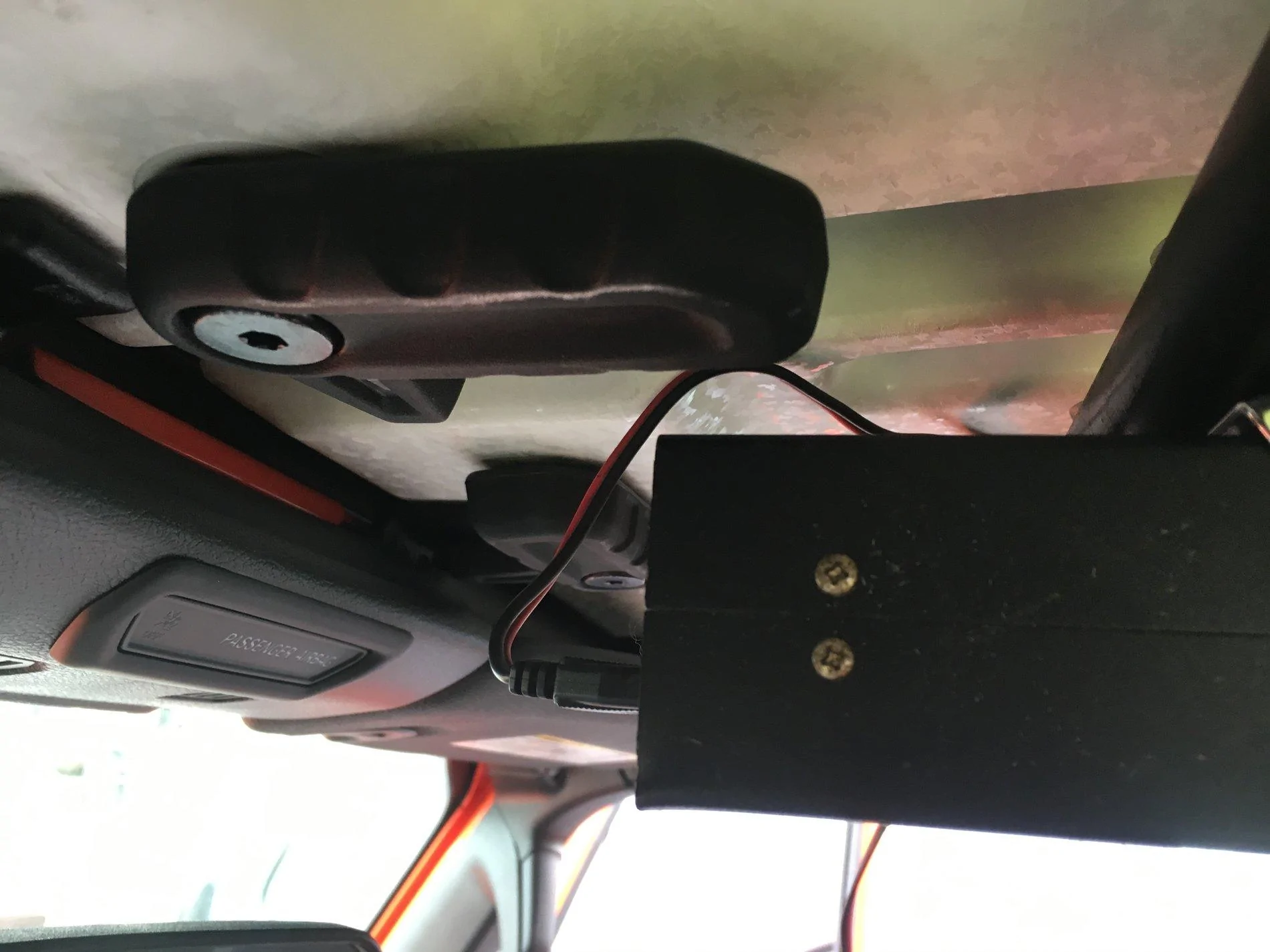

Clearance of the Freedom top latches

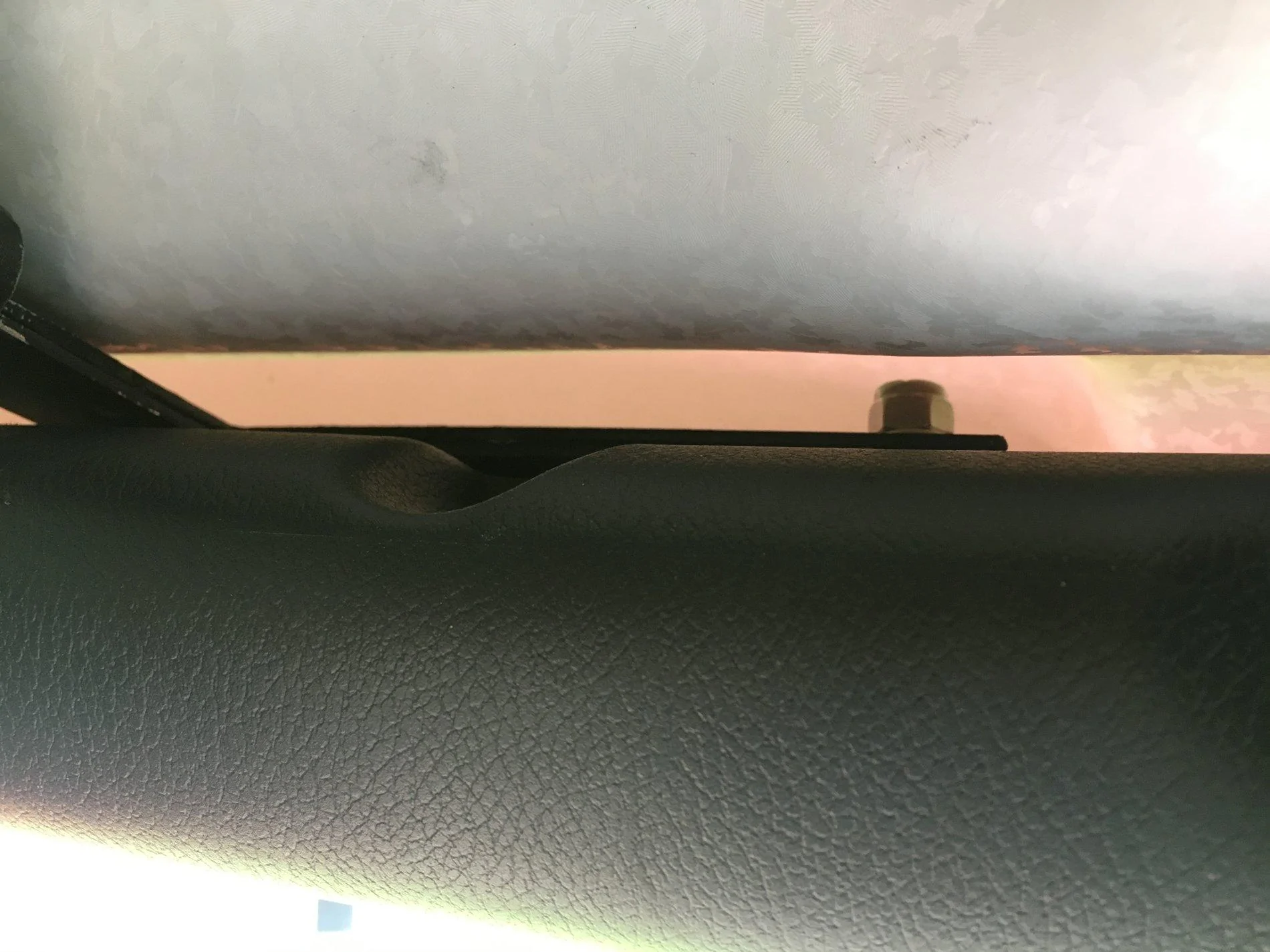

Clearance of the bolts under the hard top panel

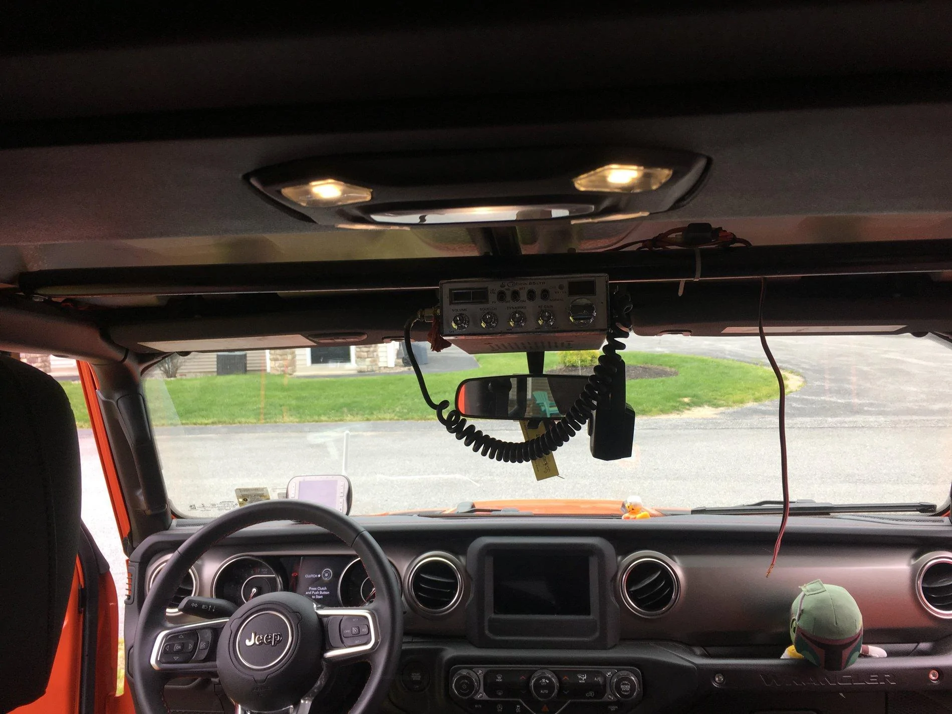

Here, you can see how low it hangs. mirror is still useable. I tuck the mic cable up top when I'm driving.
Overview, with panels out. I'll try to post soft top pics once i get that on.
