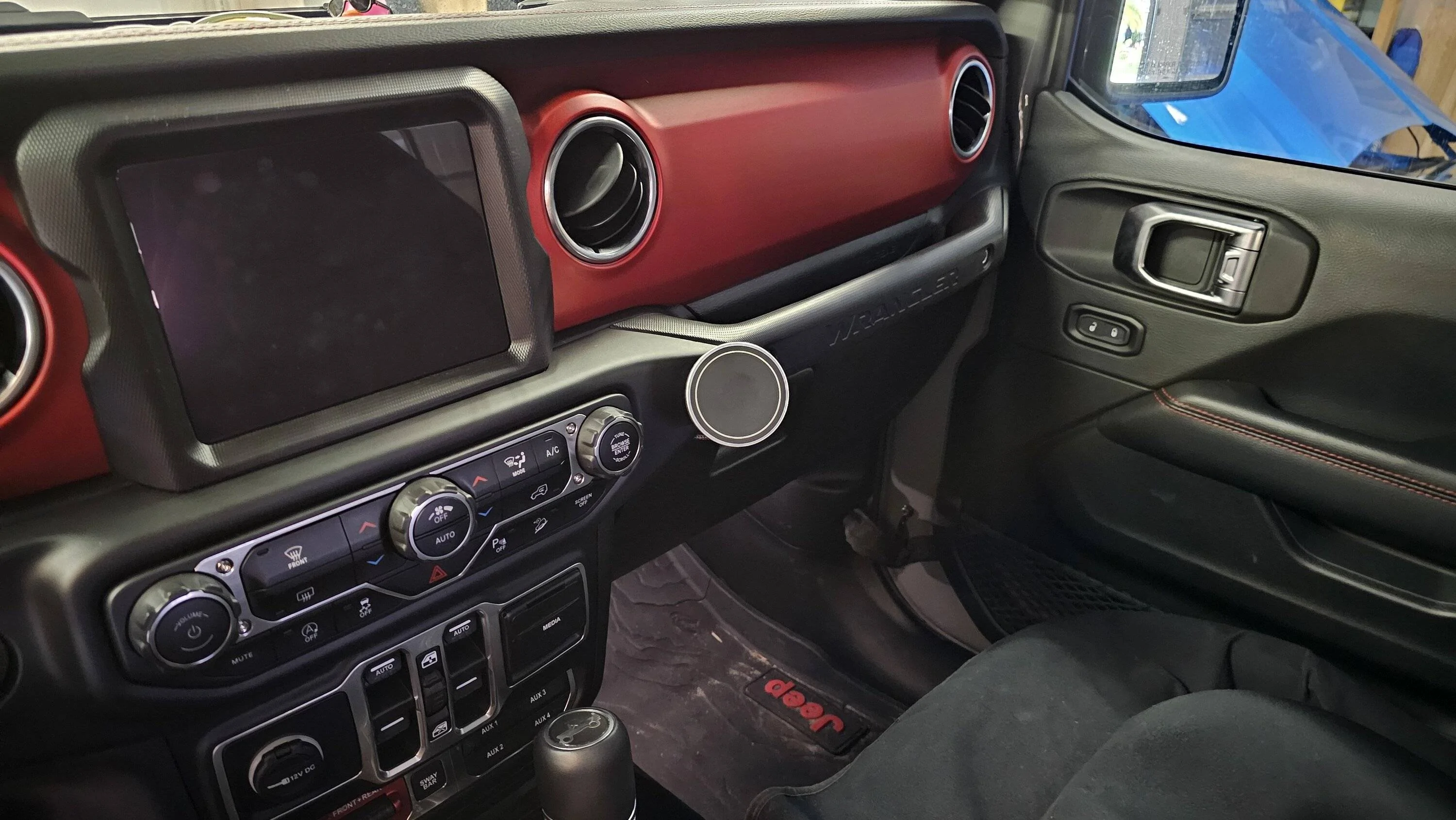

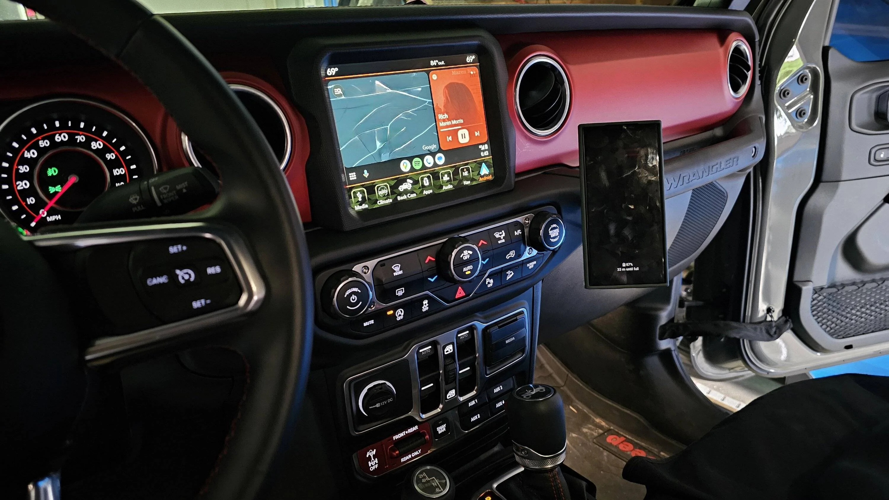

I did a lot of searching before settling on this and didn't see anyone who had done this exact thing, so figured I'd post a DIY on it.
I recently installed the Motorola MA1 Wireless Android Auto dongle and was wanting a wireless charging solution to go along with it that was clean and didn't interfere with anything, including sightlines. I really like the factory look whenever I can get it. I liked the Sanctum charger in the center armrest, but didn't want to sacrifice elbow room.
The nice thing is this can be removed or upgraded when new technology comes out. The A/C bezel is a $50 part, so it can easily be replaced to go back to factory too.

Jeep Wrangler JL Clean Magsafe Charger DIY 20230817_100534
Jeep Wrangler JL Clean Magsafe Charger DIY 20230813_115637
Jeep Wrangler JL Clean Magsafe Charger DIY 20230815_184328 (1)

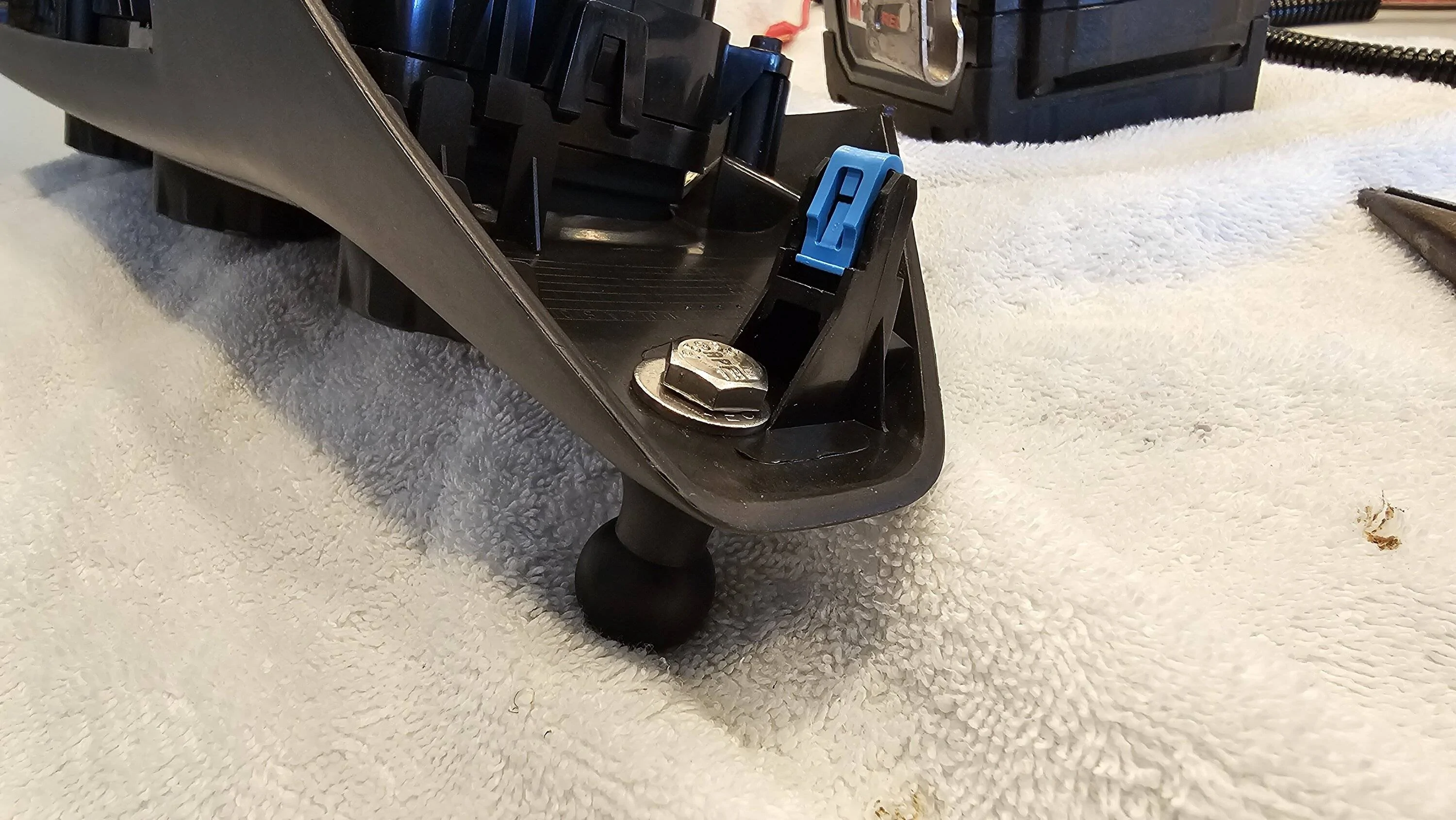

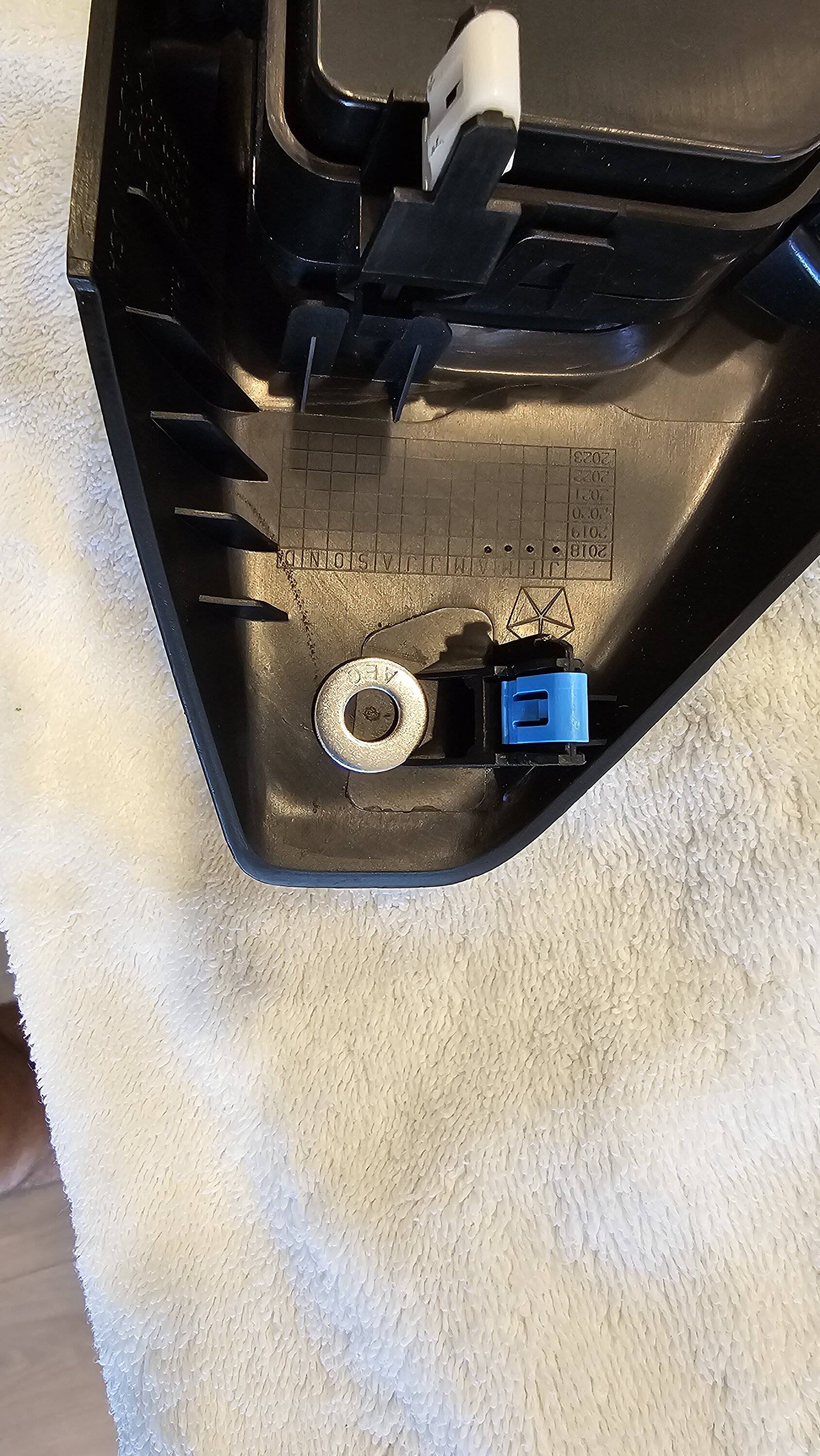

Pull off the A/C bezel. Mark the center of the washer and drill a 1/4" hole.
Install the ball mount with the hex bolt and a little locktite.
Jeep Wrangler JL Clean Magsafe Charger DIY 20230813_102745
Jeep Wrangler JL Clean Magsafe Charger DIY 20230813_105133

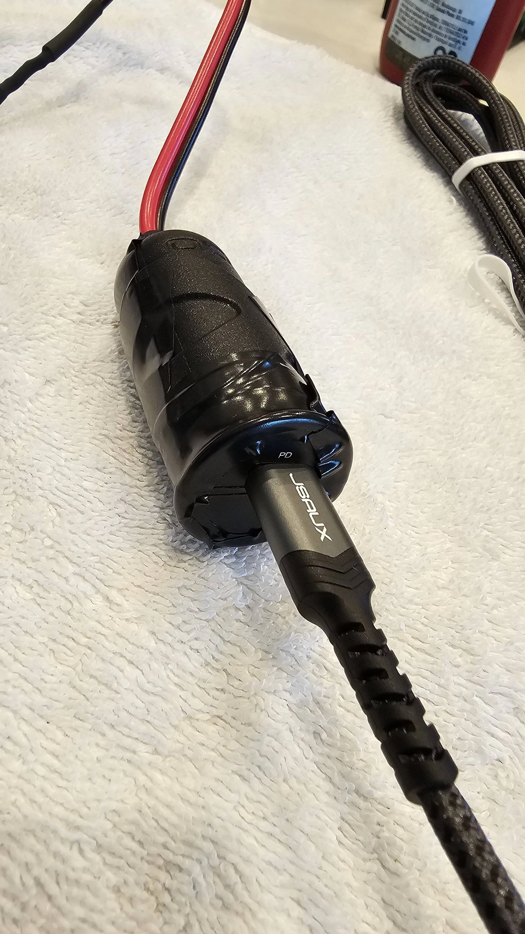

Solder the cigarette lighter adapter to the 12v harness.
Install the USB c charger. I used some electrical tape to hold it in place since it was a little loose and it will be behind the dash.
Jeep Wrangler JL Clean Magsafe Charger DIY 20230813_110644
Jeep Wrangler JL Clean Magsafe Charger DIY 20230813_110931

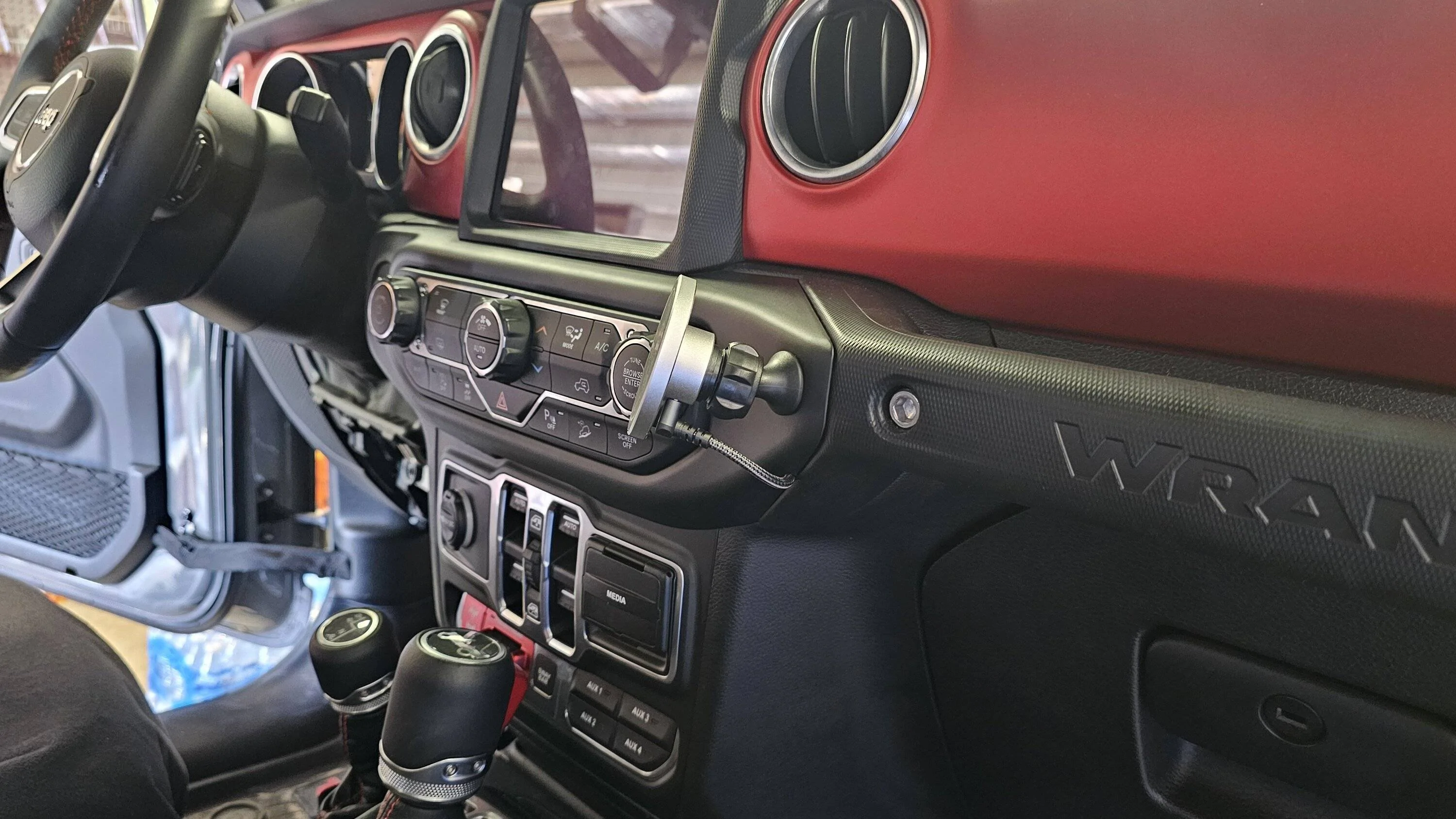

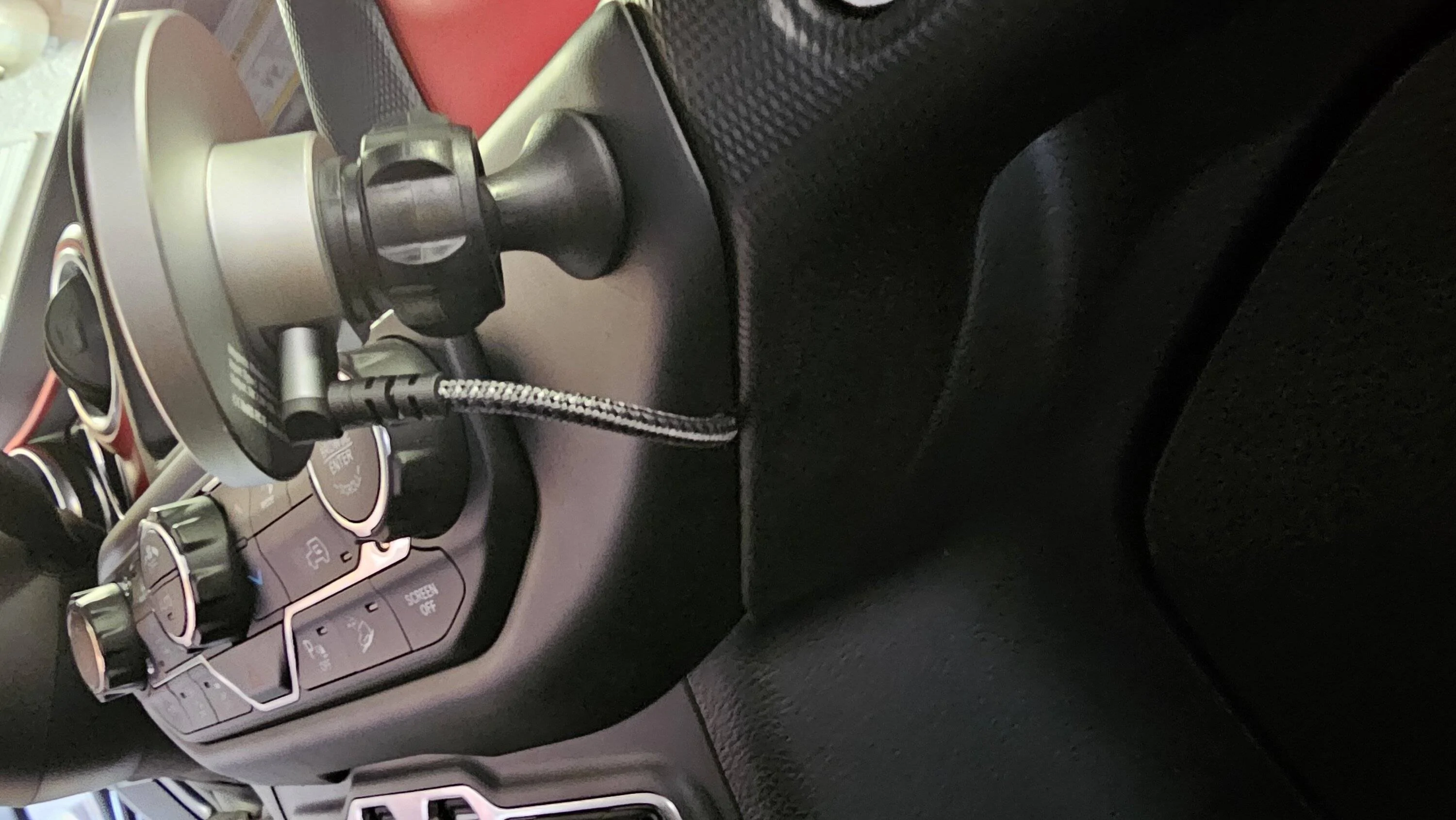

Notch the AC bezel with a dremel for the charging cable to pass through. You can really choose any position, but just make sure it won't be pinched or caught behind any clips.
Jeep Wrangler JL Clean Magsafe Charger DIY 20230813_115409

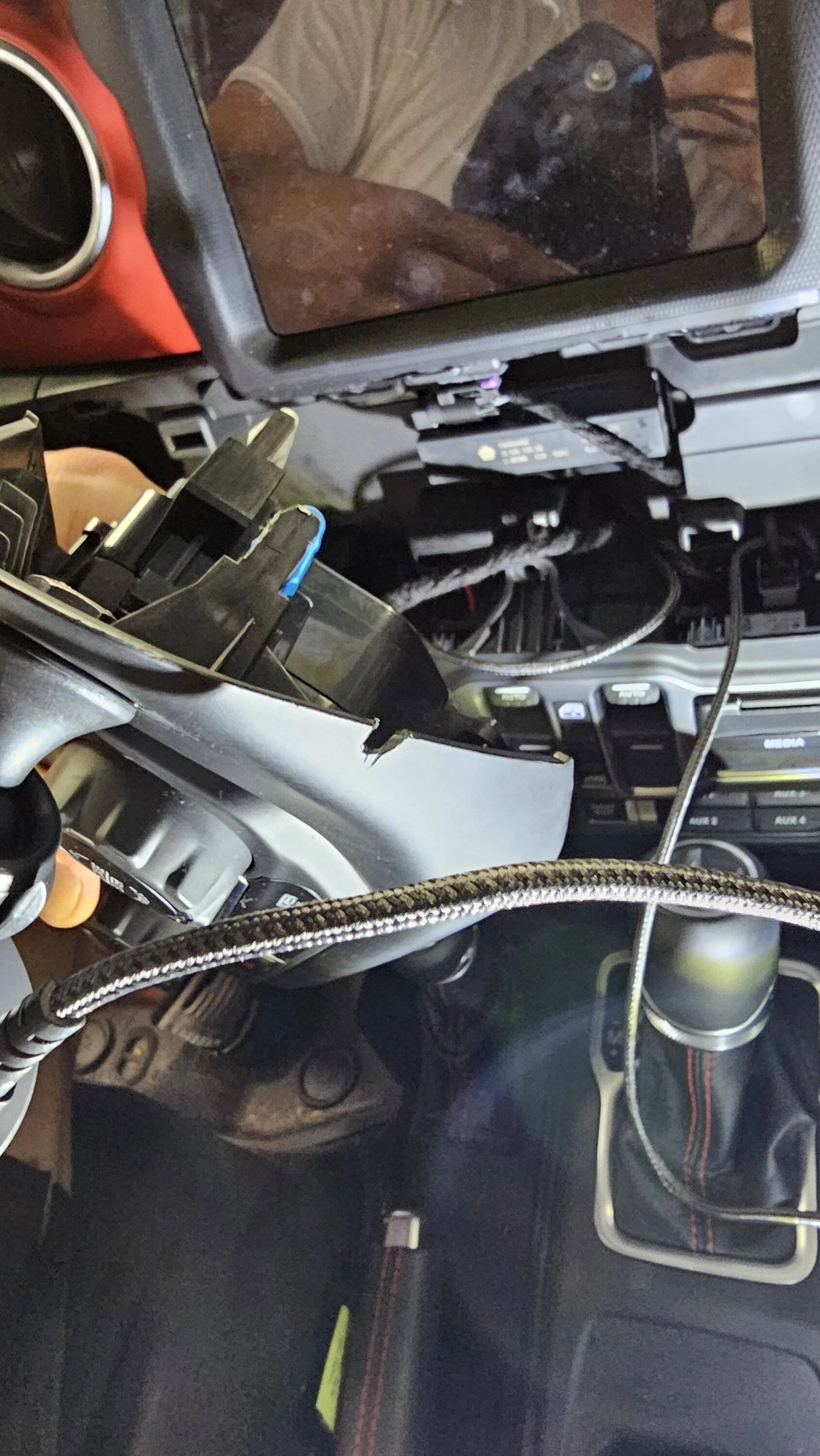

Disconnect the harness on the factory cigarette charging socket and install your harness and your USB c cable. Tuck all the wires in there and reinstall everything.
Jeep Wrangler JL Clean Magsafe Charger DIY 20230813_115641
