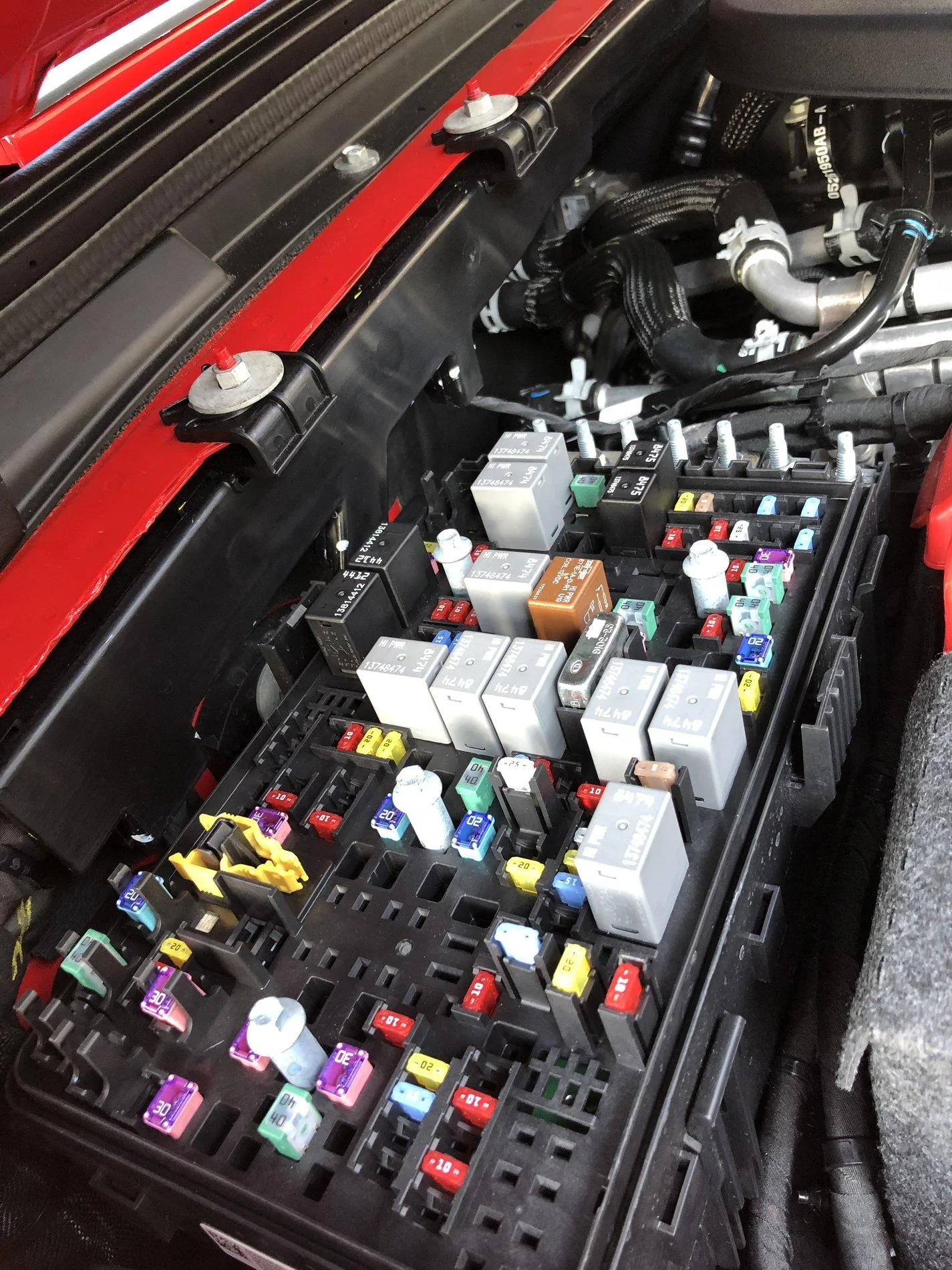

I just checked mine... 15 fuses not fully seated. Haven’t had any issues prior to doing this but curiousity got to me. Thanks for the tip. CheersWell came home this evening from work and cut grass and then a quick shower and was gonna check fuses tomorrow but my OCD got the better part of me so I went after it
Was hoping to find all fully seated or at worst case maybe 2-3 unseated but I FOUND 18 NOT SEATED !!!!!
@JeepCares you need to make the dealers aware of this so they can check the fuses before they are sold off the lot, I had no issues prior to checking other than the Uconnect system rebooting once and only once several weeks ago but a fuse not seated can be a recipe for disaster. I did find it pleasant that there is a fuse puller and a few extra fuses in holders for that just in case.
You, Sir are all over it! I read your post and thought, no... not my Jeep. Just walked into the garage, pulled the hood up, and damn... Just about every fuse and relay location was loose. Each needed to be snapped into full locking position.After reading all the stories about ESS faults and being stranded on the side of the road, a discussion about fuses not being fully seated in the fuse box came up. Easy enough, I'll just trot right on out there and see for myself. Sure enough, at least 80% of the fuses and relays were not fully seated in their sockets. Do yourself a favor and check it out real quick, it doesn't take 5 minutes to do.
ok. couple things here. i went out and gave a little push on all of the socketed devices.After reading all the stories about ESS faults and being stranded on the side of the road, a discussion about fuses not being fully seated in the fuse box came up. Easy enough, I'll just trot right on out there and see for myself. Sure enough, at least 80% of the fuses and relays were not fully seated in their sockets. Do yourself a favor and check it out real quick, it doesn't take 5 minutes to do.
Most of the fuses are purposely not seated at factory and are supposed to be performed as part of dealer prep.Can't believe it, most of mine were not seated, fire the fuse guy at the factory great thread
