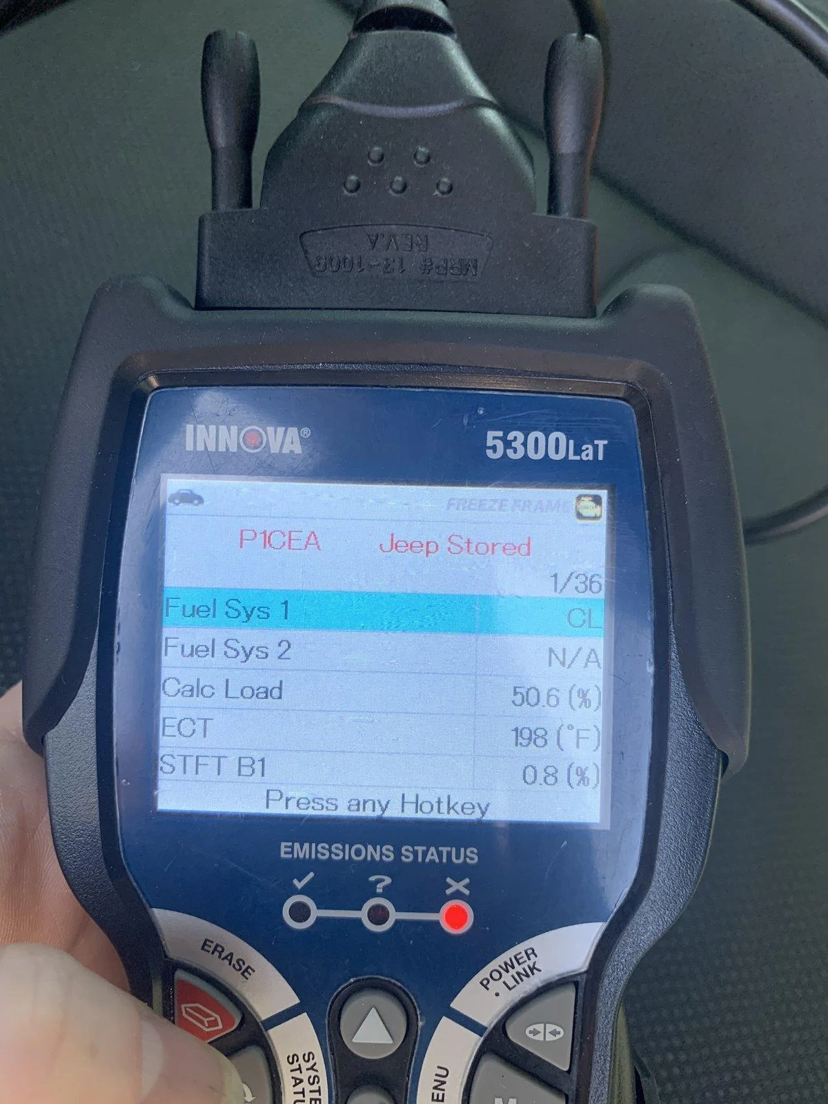

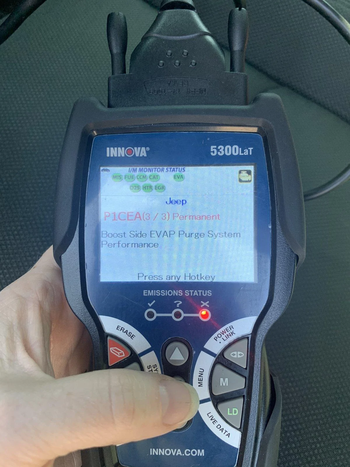

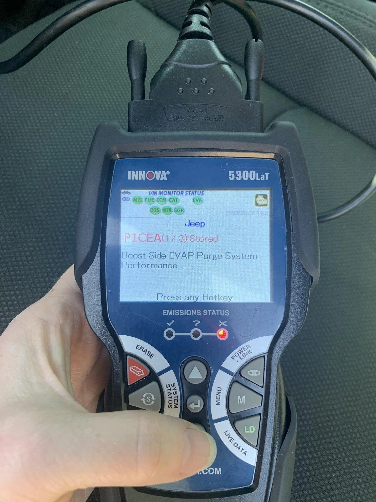

I installed an afe momentum cold air intake and now the engine light keeps coming on. I emailed afe to get recommendations, but I haven’t heard back. I know I can take the positive side of the battery off to reset it, but will this keep happening or should I return it? @afepower
I just put on the cold air intake and have the same issue. aFe sent me a new little plastic valve that I already had on the first one and said it would fix the issue but it didn’t. Have you had any resolution to the problem yet?
