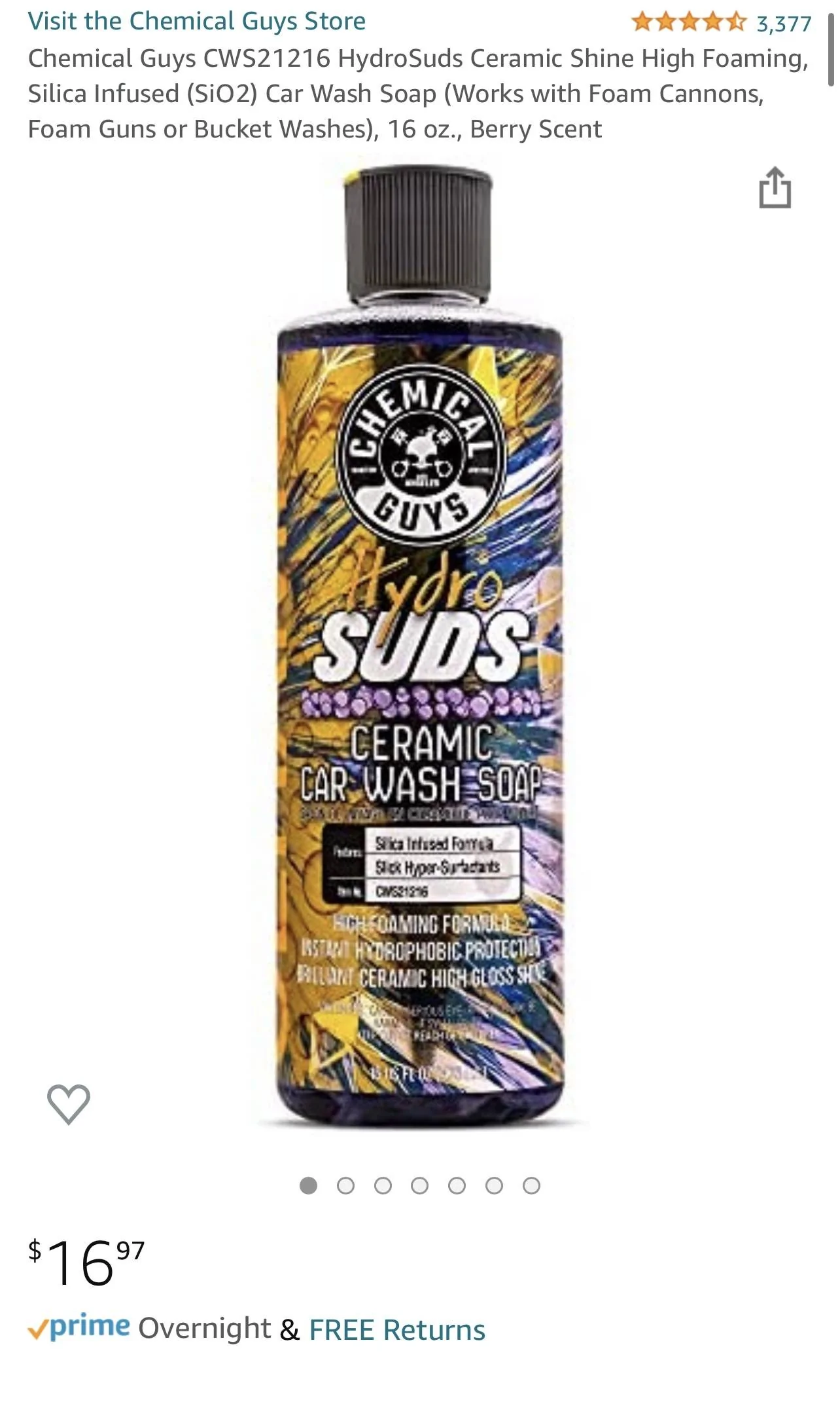

These three obviously not a huge bottle of clean slate it’s to take all contaminates off the paint. Then use a clay bar Pad with orbital polisher to remove anything left. I have had around $2-$3k in detailing stuff before buying my Jeep. With the one bottle of ceramic I’ve done 5-6 cars and have a ton left. That includes reapplying after a year.
Jeep Wrangler JL Ceramic Coating 75DB8F1A-E68C-4E2F-8625-9A059A6C0E0D
Jeep Wrangler JL Ceramic Coating C41124EB-BAF4-470C-A75F-6E3992386887
Jeep Wrangler JL Ceramic Coating B9172210-0570-4DFA-8DDB-E1A3B4328F99
Okay thank you for all this information with the products and video clips, I am familiar with Chemical guys I have used their products in the past
