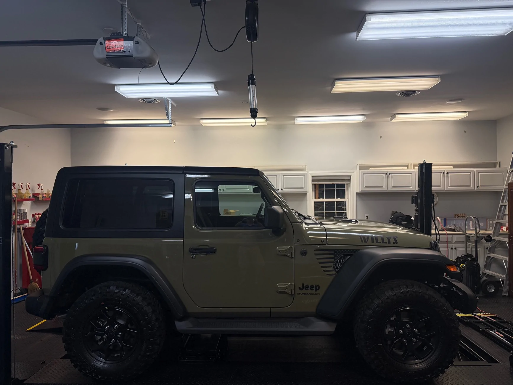

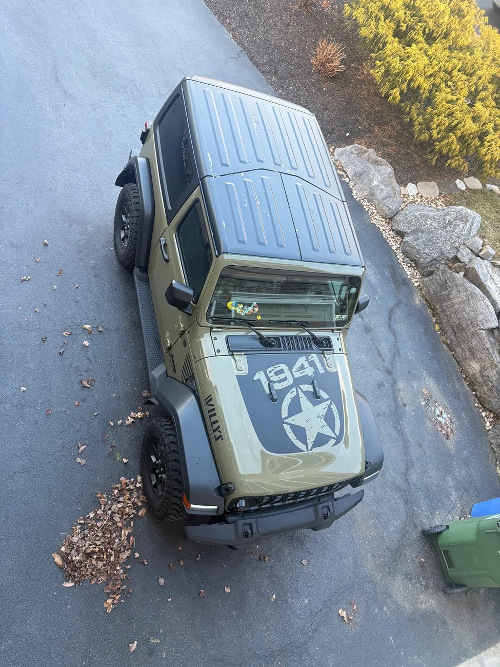

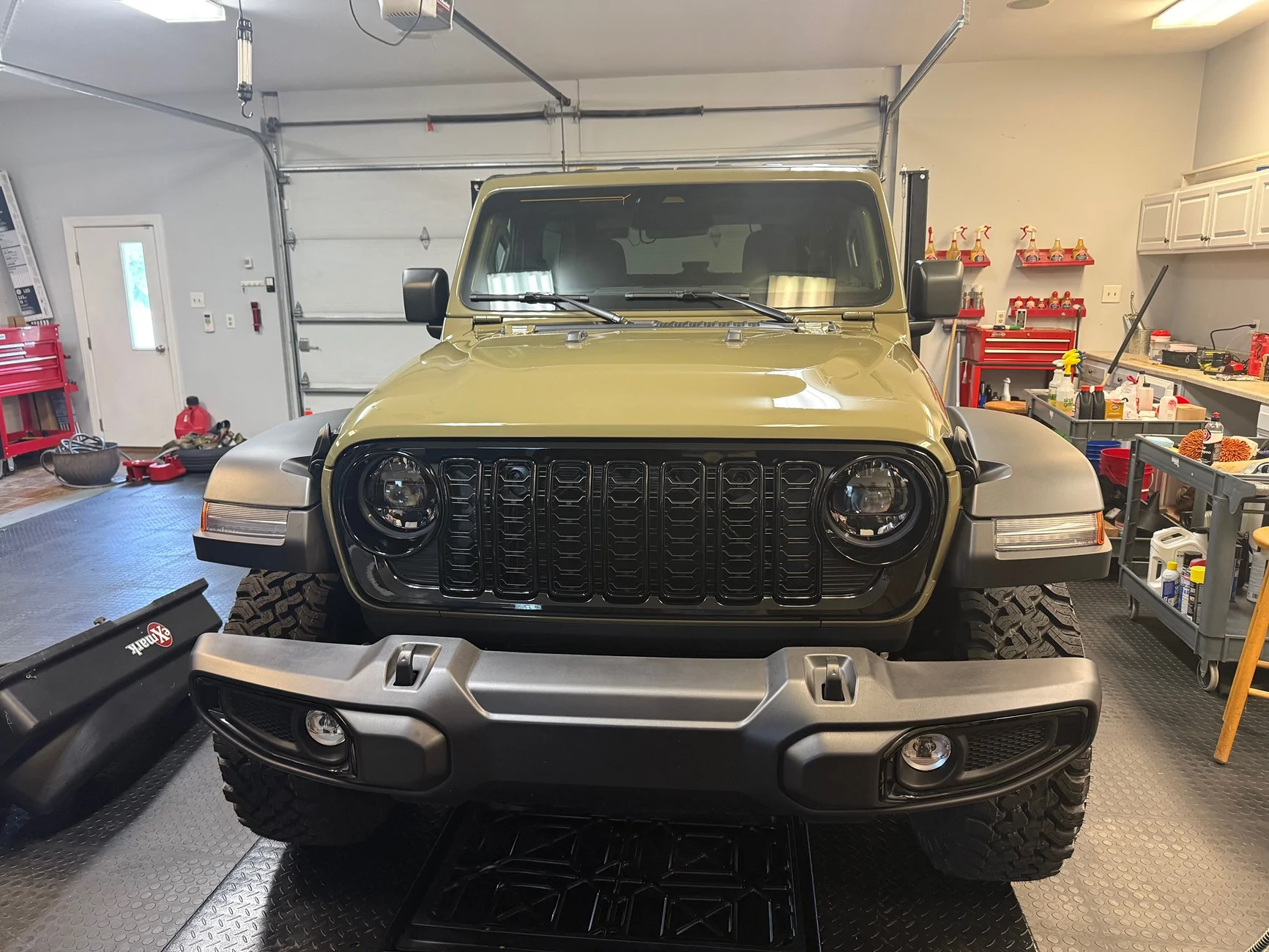

After talking to a few local detail shops and getting prices along with the prep steps they do before application.
decided to make it a diy weekend project.
I already use and have mesquites polisher,assorted foam pads and products to clean,polish, wax paint.
I plan to use mquire polish followed by clay bar followed by creacoat ceramic coating.
agree with others, the prep work is the time consuming part.

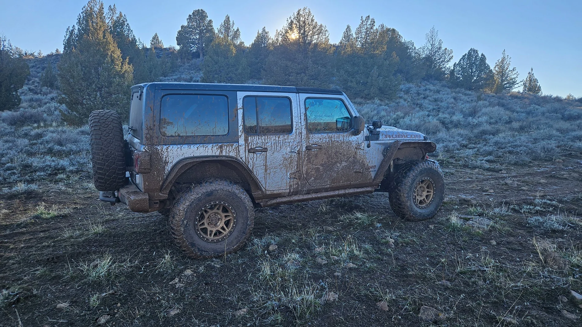

Long time listener, first time caller.
does ceramic coating actually defend against getting trail pin stripes from sticks?
No, coatings (ceramic or otherwise) are not "armor" for paint, in any way. They simply add another layer to the clear coat that fills in the (already limited) imperfections making a pretty non-stick surface even more non-stick. What they do is keep dirt from sticking, thus making vehicles easier to keep clean and stopping the damage that dirt and contaminants do when left on paint over time. Same thing wax does, just (supposedly) better and longer lasting. The real world results vary to a huge degree.
Furthermore, NO coating lasts "years". The professional coatings that claim/guarantee years of protection have to be re-applied regularly. It's what they refer to as "maintenance". You have to bring your vehicle back in for "maintenance" but what they are really doing is re-applying. I know you'll hear lots of people claim "well mine still looks as good as it did 5 years ago when it was first coated" but those are people who have major skin in the game and i've found that "looks as good" varies greatly depending on the viewer. I've seen a few of the biggest name "permanent" coatings and they all were already breaking up by the six month mark.
I would never spend more than a few hundred on a coating...I mean unless you really don't want to do it yourself, but even then, spending $2k+ is a complete waste.

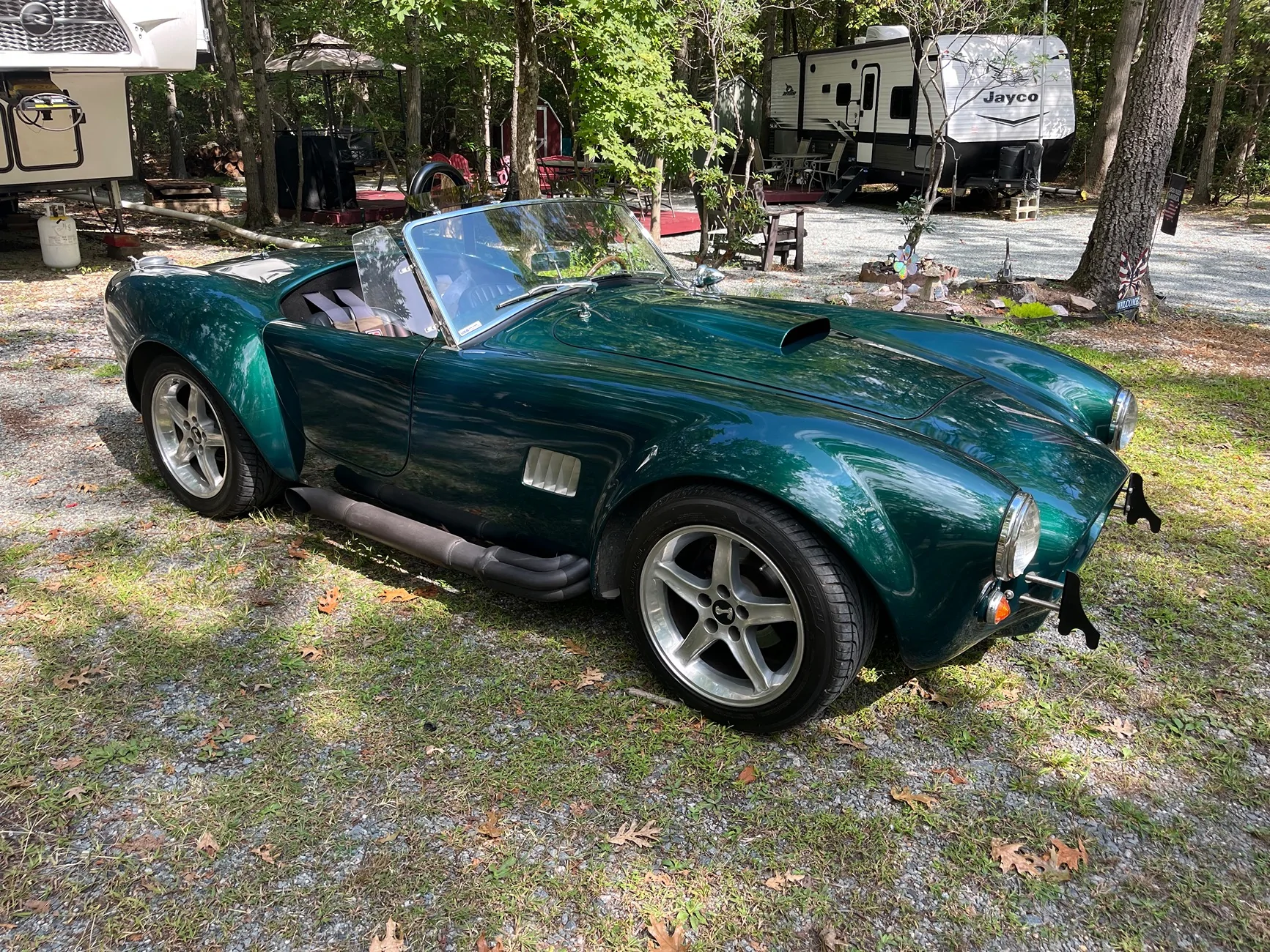

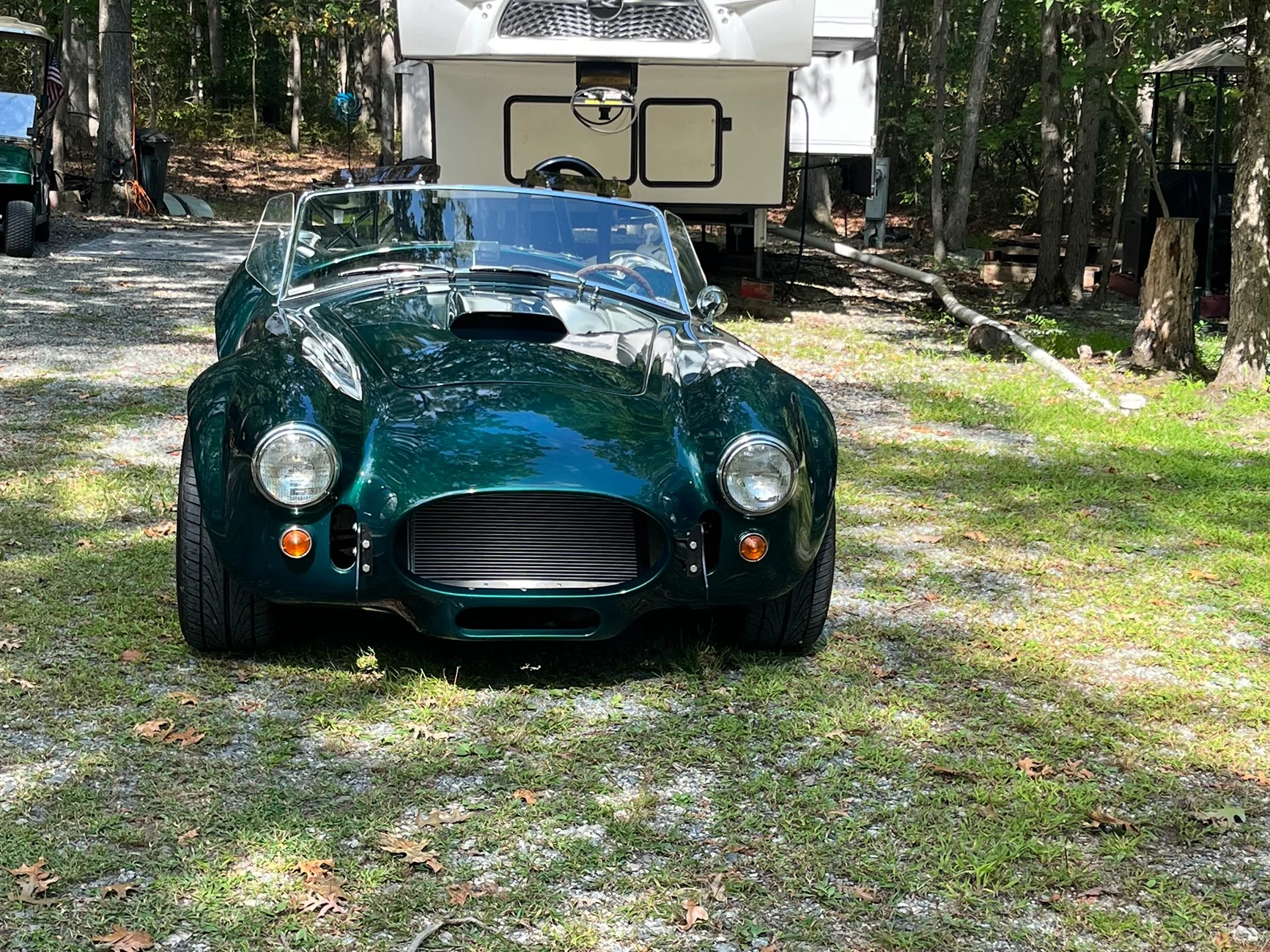

Same proceedure I use on my show/race car 😊
Which kit did you buy?
Did you have a shop put it together, or did you buy it from a shop without any indication as to which kit they used?
Also which engine did they put in it?
It's nice. My uncle has one of these. He went period with his. Has a 427 Cobra Jet in there, along with torque thrust wheels and a original white factory color. (Obviously it's a modern-day version of that original factory color, but it's still looks original even though his was built in 2003.)
In his case it helps because he flips classic muscle cars for a living, and a buddy of his got his hands on a serial numbered original Ford 427 the same time he was building his replica in his garage. Almost like it was meant to be!
https://www.shellvalley.com/index.c...t_id=414/category_id=152/mode=prod/prd414.htm
This is the one my uncle has.
I hope you didn't pay too much for it. 😬

I ppf and ceramic coat all our cars with CSL and Exo. I do the paint correction and ceramic coating myself. Do NOT use any polish or wax after paint correction. The purpose of the paint correction is to eliminate any swirl marks and all products off the clear coat so the ceramic coating can adhere.
it generally takes me 3 days to correct and do the 2 coatings. You also need to let it cure 24 hours after the final Exo coat.
it absolutely works as water droplets sit almost as a complete drop on the paint. It only prevents love marks (scratches from washing and drying) only ppf will stop trail damage. I also use a product called “bead maker” as a drying agent each time I wash my cars.
i admit I’m very particular as I have a wall mounted pressure washer and foam cannon system like obsessed garage to wash my cars.
Only if you use PPF after the ceramic coating.
