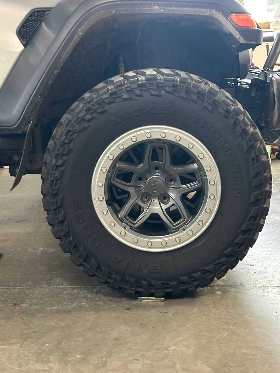

0.3mm is pretty small....If it were me I would try and find the 71.8mm as they are essentially hub centric. Or as was said look for some other wheels that you like. I am partial to AEV wheels but not they are not for everybody...
Jeep Wrangler JL Center Bore Question tempImagedBK0JB
