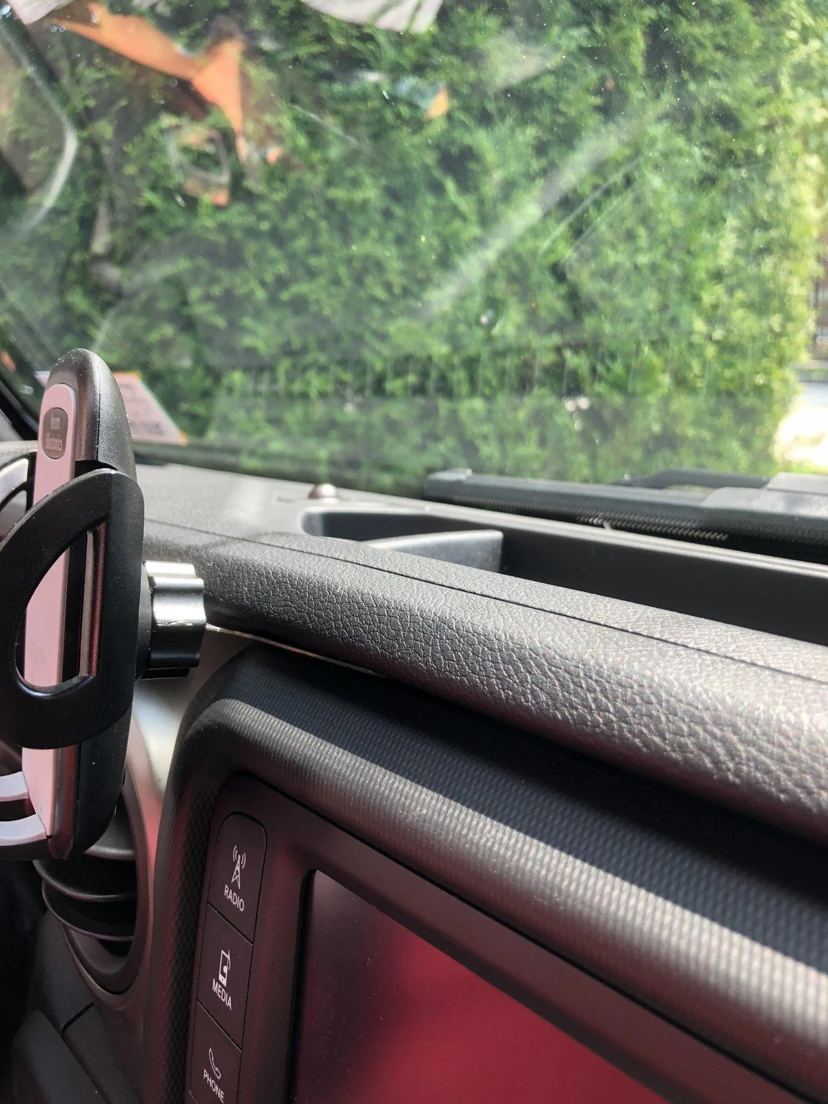

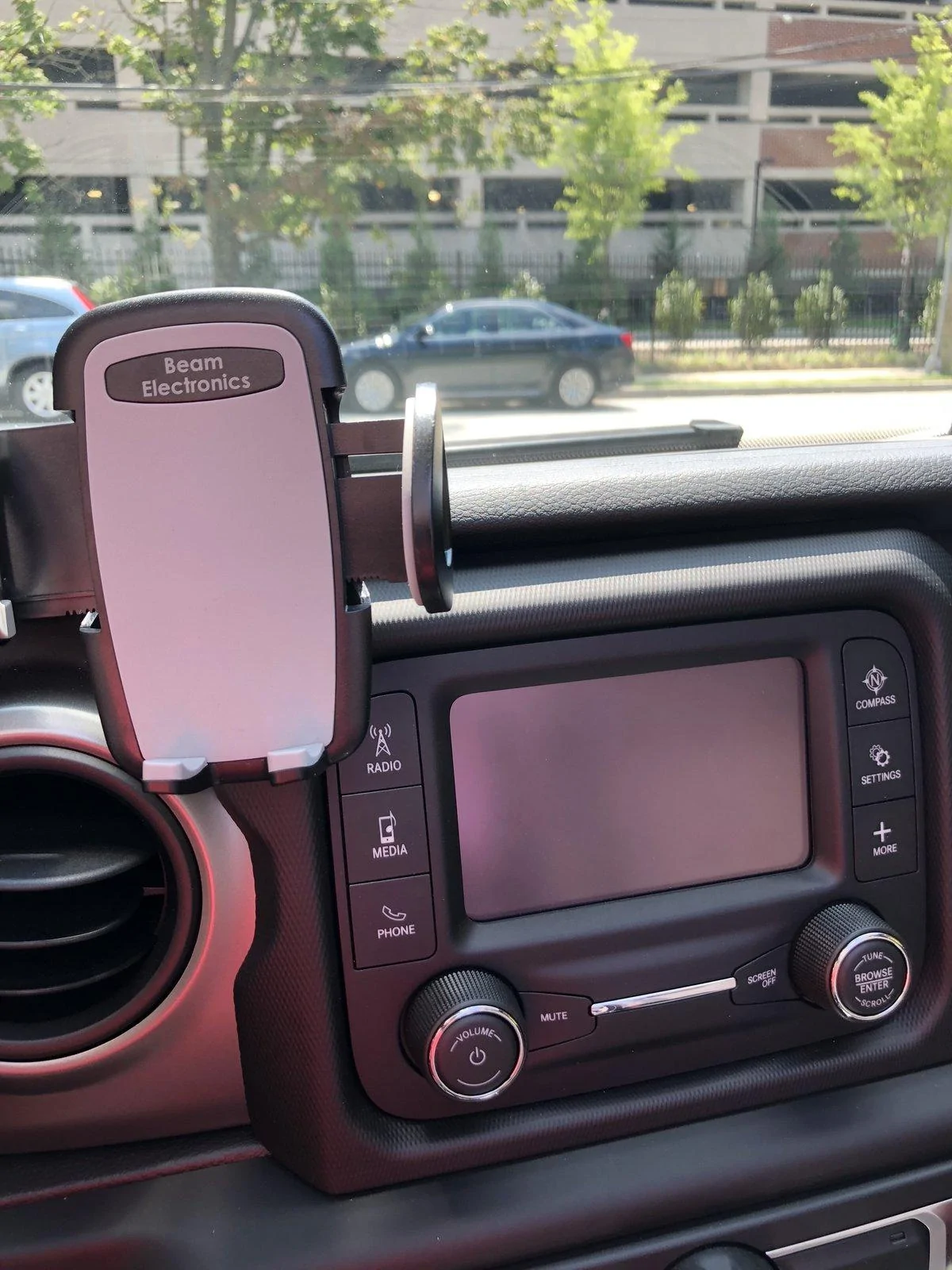

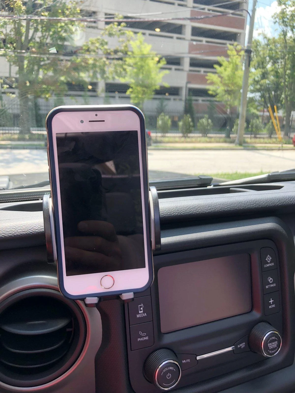

This company makes Vehicle Specific Mounts that are well engineered. Just need the holder for your specific phone.
https://www.pro-fit-intl.com/shop
Amazing mount! Installed today. I called the company and the rep walked me through everything I needed. The mount can accommodate my old holder too!
Glad someone posted this, been debating this mount for a while, but no real world install pics. Love it. Thanks!

Glad someone posted this, been debating this mount for a while, but no real world install pics. Love it. Thanks![/QUOTE
Yeah, it’s awesome! I did buy the tool to take dash apart ($5). And just YouTube “radio removal JL Wrangler” . Easy and looks amazing! Cheers!!

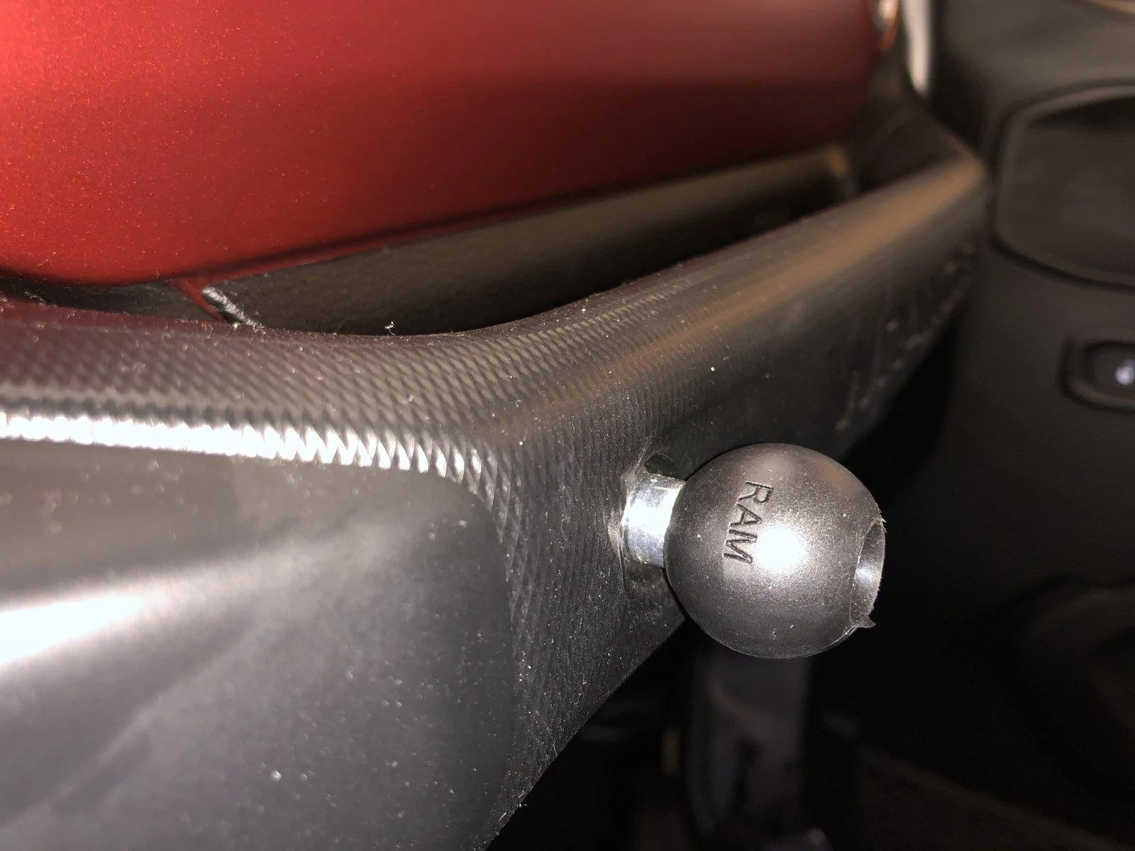

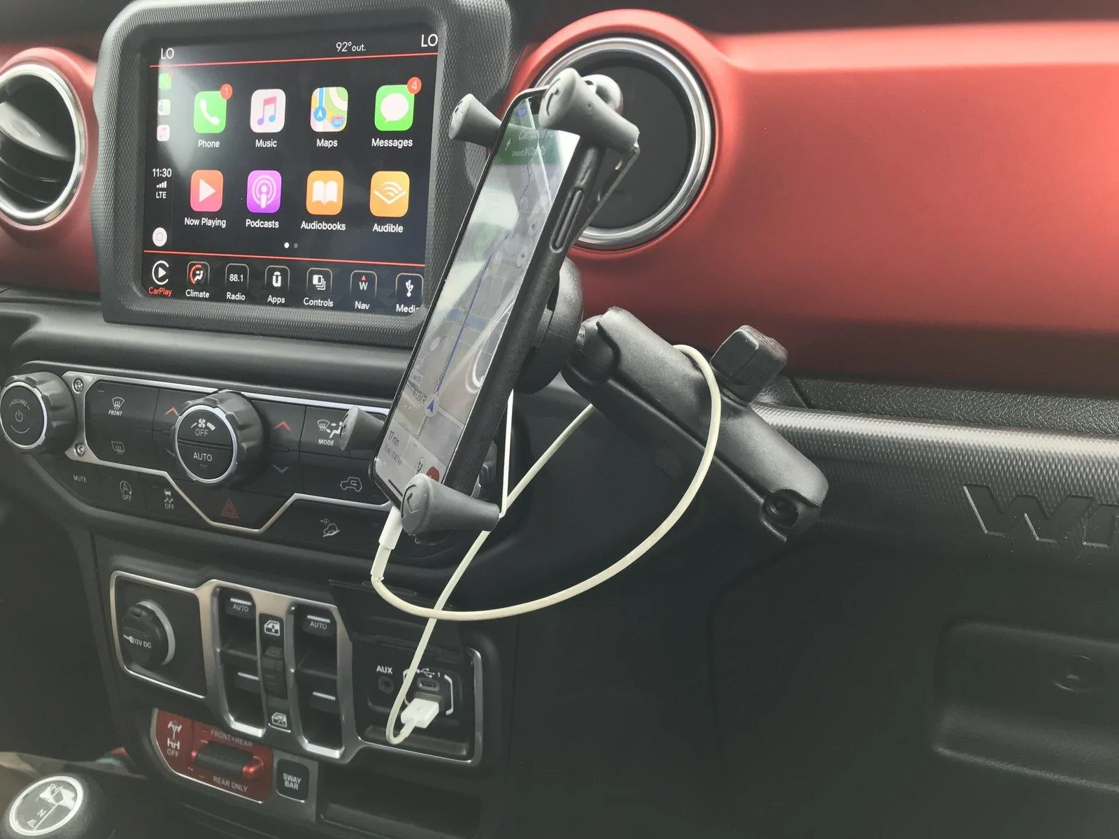

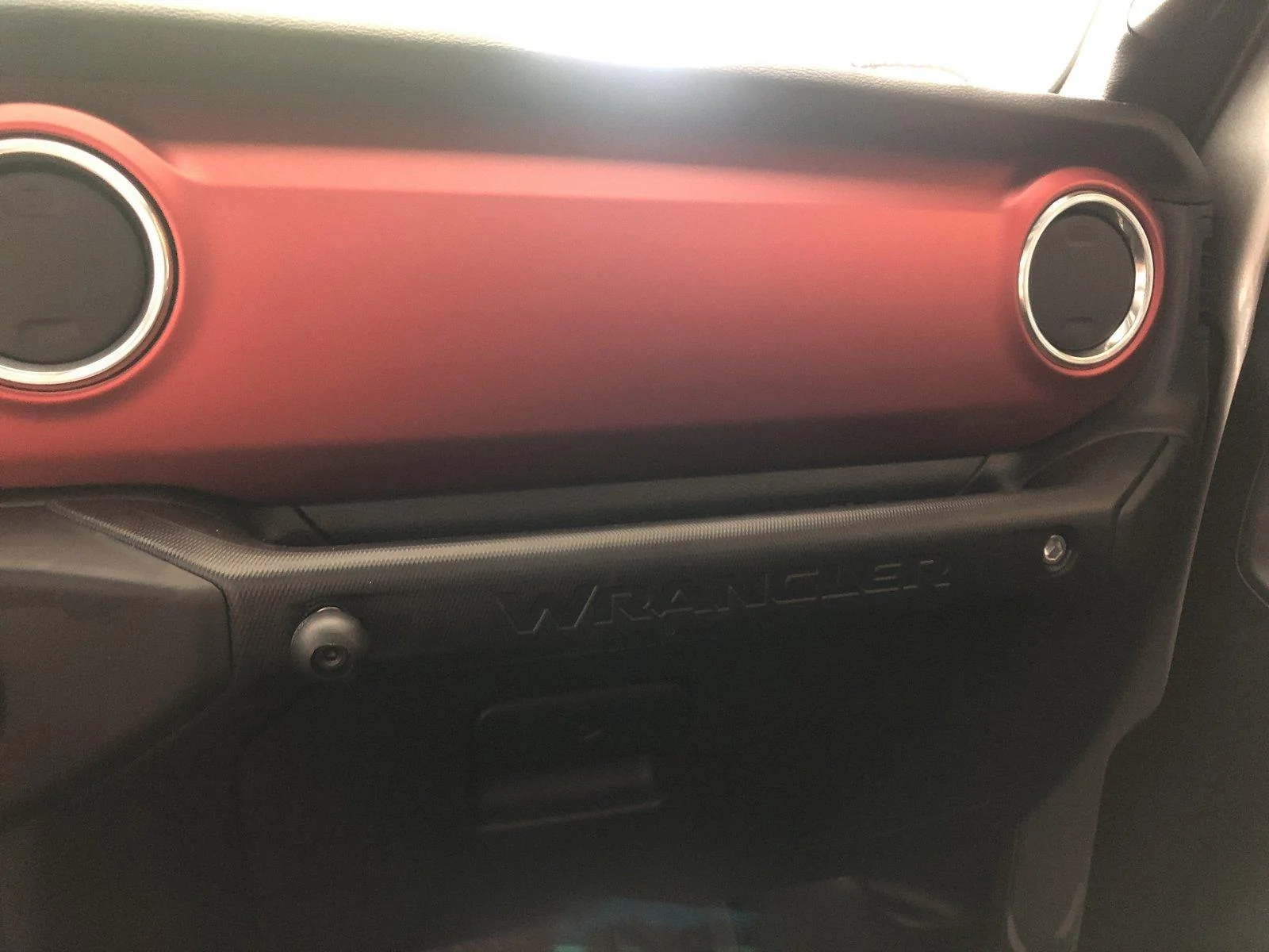

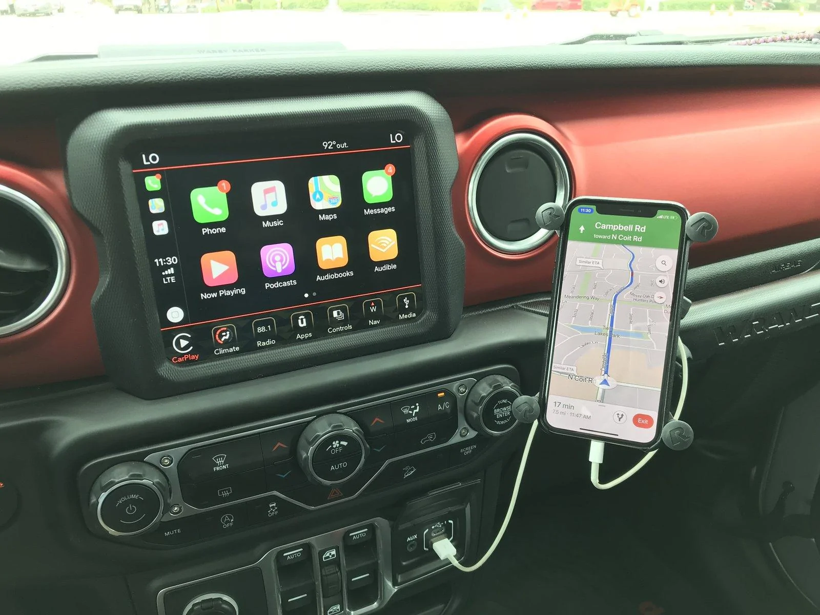

Looks good! How did you attach it to the dash? Can you post a link where you got it? Thanks so much!
Ram mount sells the phone holder, different arm lengths and the ball you can mount with a bolt to anything. I just went to ACE Hardware and got a different bolt to use with their ball that replaced the left bolt on the dash grab bar as seen in the picture that also secured the ball to the dash. If not in use you just remove it all and the ball doesn’t look to bad. And if you ever want to go back just stick the factory bolt back.
Also for the cord just get a short apple cord sold at the Apple store, if you have a iPhone. The length is perfect an wraps around the cradle but is there if you or passenger need to use it off the holder without unplugging it.

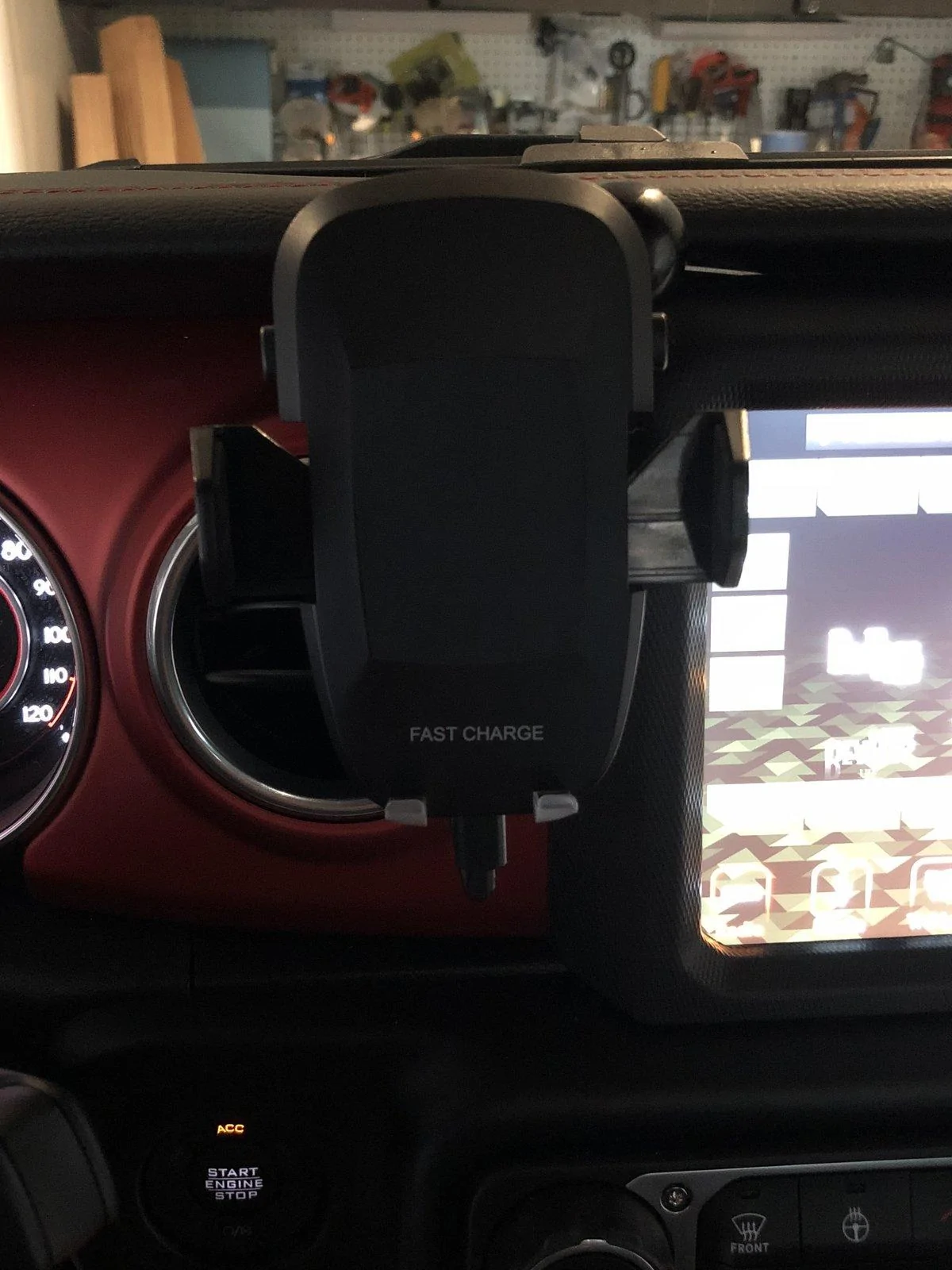

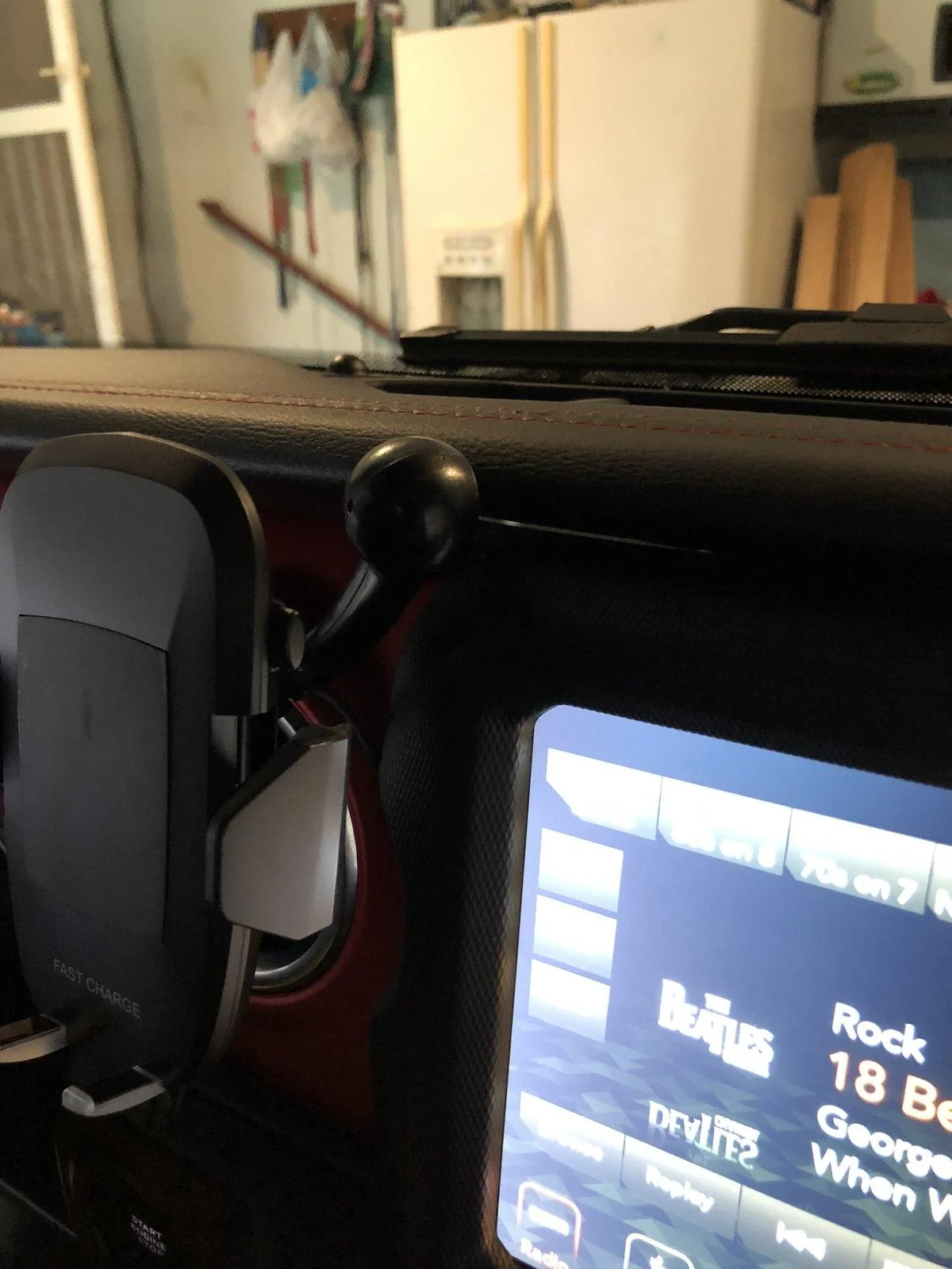

Installed the pro fit mount. And a wireless charging mount that I already had. Ran the wire behind the radio bezel. Used the ignition switch wire from the aux wiring on passenger side.
How in the hell did you get the J-stem on your mount? I thought i was going to break something trying to force it on..
