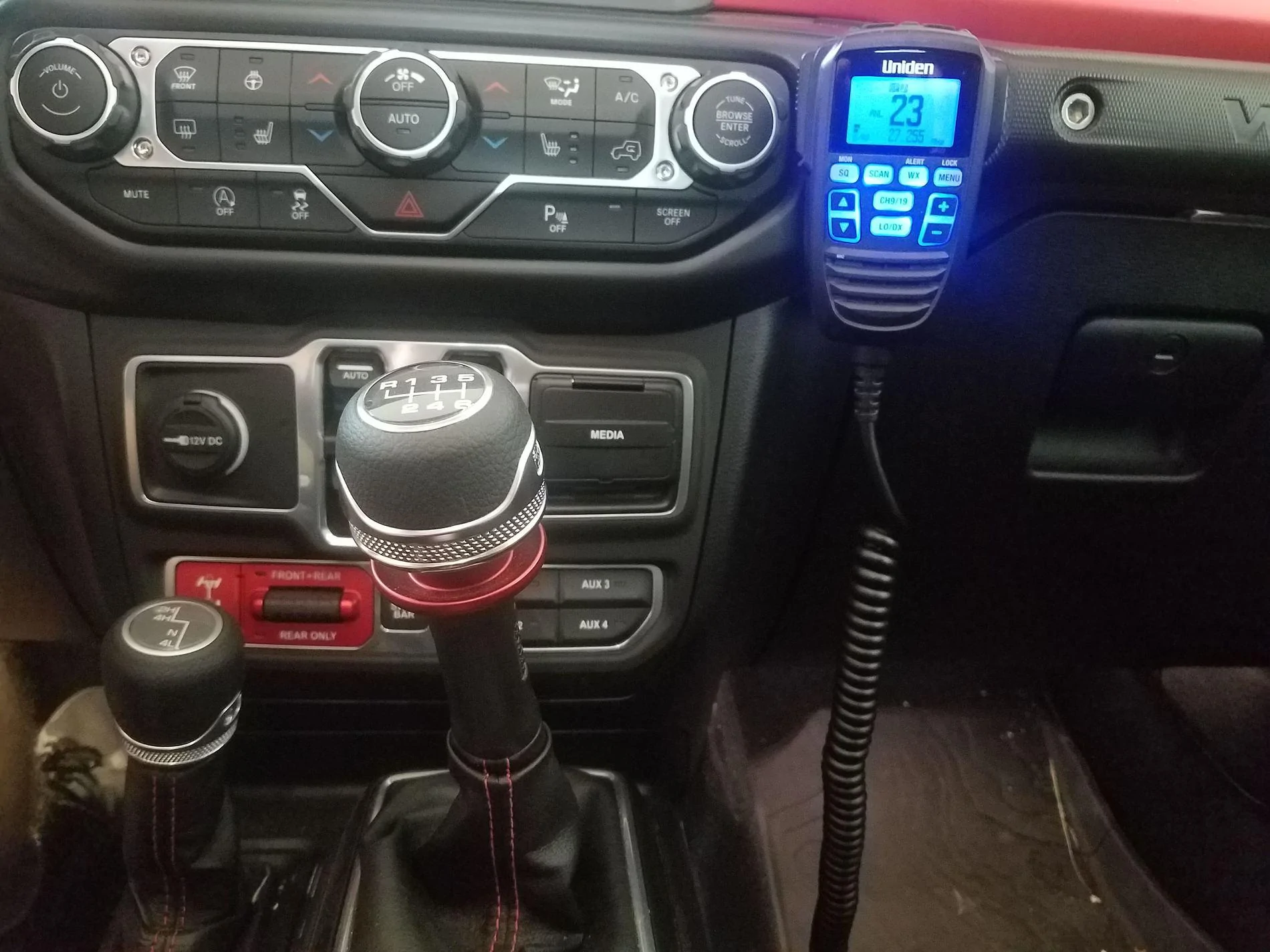

I've got the 760, and love it. The 560 will be the same, other than a couple features like changing the backlight color. I mounted the box under the passenger seat with velcro, on the carpet, so there's no drilling. You can also set it up where you only put it in there when you use it. The microphone cord extension is an especially important feature that comes with it. If it did not have that, I would be complaining about the cord length. I also like the weather radio feature, even though this Jeep almost lets you program the weather yourself!
Here is a pic of my setup. I did move the microphone mount up a little, using the Cooltech mount. I'm not sure I love that setup, though, so I may move it back down to where it is in the pic.

I have a similar setup to DanW above. I’m running the cmx560 and using the cool tech antenna mount and handset mount. I placed the “brain” of the cb setup in the glove box - using the Scotch “extremely strong” plasticy-like Velcro stuff to “mount” it in the glove box. I only use it for off road and hide everything when not in use - seems to work for me.
