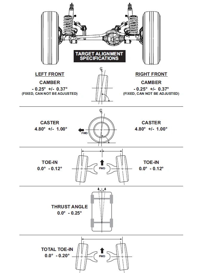

So I bought a take off suspension off a 392 xr I got a net of almost 4 inches hight I realized that things were off so put a leveling kit on I also changed both track bars front and rear adjustable end links with adjustables to get the geometry corrected I’m now going to put adjustable control arms and I forgot the recommended caster angles please and thank you for help

Front axle 6°. Rear axle 1° to 2°.

With that much lift you’ll want caster around 5.5° to 6.5° for good road manners. Most people shoot for right about 6° on a JL and fine tune from there.
Too little caster and it’ll feel twitchy and wander. Too much and steering gets heavy. Once you set the control arms, get a proper alignment and you should be dialed in.

No caster in rear, just pinion angle
