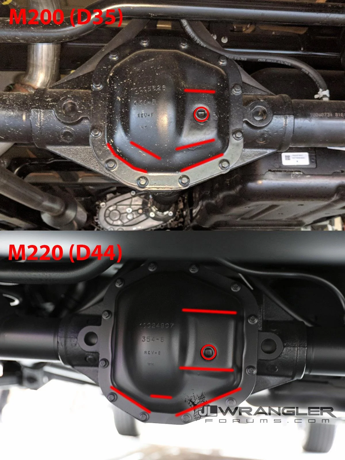

Does crawling under your jeep with your phone and this picture loaded not work anymore? Why wasn’t that step 1?
This was step two after my installer checked my vin. I 100% have that Dana 44 plate in the rear.
NO, you don’t have the Dana 44 plate. The picture above is wrong (old diffs) because the new axles are called Dana M200 or Dana M220. They have similar covers but are in fact different. You have the M200 cover, go check it out and compare to the picture below. Note the fill plug in relations to the raise portion on the diff, is it in the center or on the bottom?
Read the thread here where people were confused as well.
https://www.jlwranglerforums.com/forum/threads/sport-and-sahara-axles-and-rubicon-axles.25227/
Interesting, I wasn’t aware of the change to the D35 diff cover. That’s why in my post I asked if that picture doesn’t work anymore :like:
No you don’t, those are images of previous generation axels.

This is interesting (the last part about the new covers, not the endless bickering). I did not realize that when you optioned a LSD you automatically got the D44. (That is, if I am understanding correctly.) I just looked under my new Willys, which has the LSD as part of the option package, and the diff looks just like the M220 pic above, with the filler hole below the midline.
Boy, Dana could have helped out with a little stamp on the casing, huh? Could have brought some peace to the JL world.

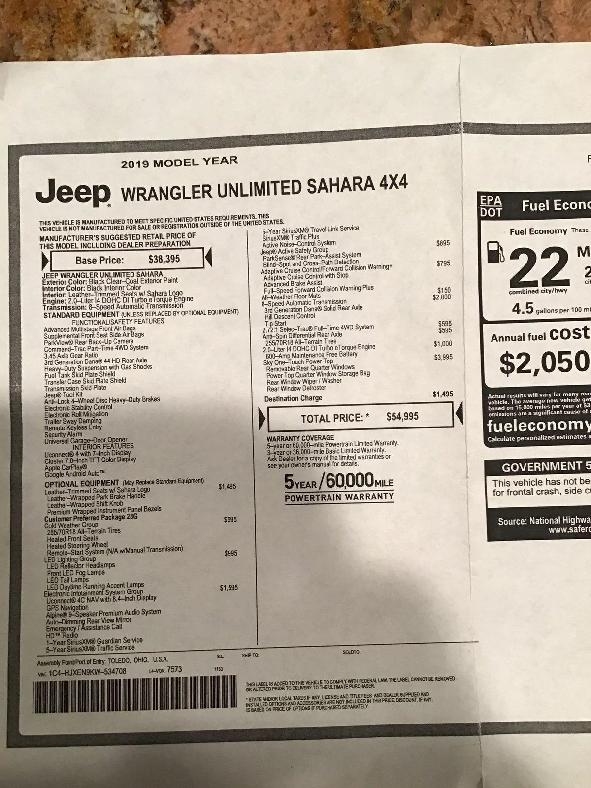

Thanks so much for these pictures! I was able to determine I have the M220 with the LSD on my automatic Sahara even though the the window sticker didn’t specify it.
Can you post your sticker? I'm curious now...
Edit: doesn't the LSD automatically come with the M220?
Understandably, the window stickers are hard to read and there are several versions. To be fair Jeep does it make it confusing by adding and removing the M220 back and forth if you optioned in an automatic transmission and/or LSD. Most people just look at the standard equipment section and thinks that’s what they are getting. A better title of this thread should be “Can’t trust your eyes”

,Here you go!
This is interesting, here is a good example of what I meant by there are different versions of the build sheet.
Mine being a 2018 Sahara definitely looks different from yours! I suspect Jeep changed it at some point to maybe avoid confusion but I guess it just created more at this point.
My build sheet (Canadian)
https://www.jeep.com/hostd/windowsticker/getWindowStickerPdf.do?vin=1C4HJXEN0JW215194
Vs Yours
https://www.jeep.com/hostd/windowsticker/getWindowStickerPdf.do?vin=1C4HJXEN9KW534708
