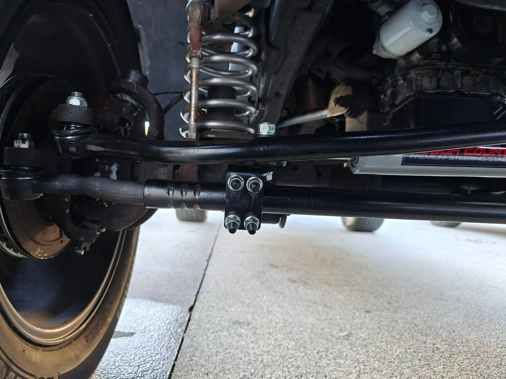

We have a 2007 Sahara unlimited. Just bought it used a month ago. Had loose ball joints, tie rods etc and was slightly out of alignment I assumed from those items. So I replace everything from pitman arm tie rod down to the left outer tie rod and also put in a rough country 2.5" lift .. the spring and shock kit. I got it close to tracking straight in my driveway and took it to NTB for alignment. The left front tie rod is turned all the way in and still can't be adjusted. The tie rods were middle ground parts from Rock Auto... Could the left outer tie rod be wrong? What am I missing? I'm not a noob, been turning wrenches since 1997 , just last 5 years I haven't been in the field... I matched everything up that was on it, everything looked the same. I understand how to align jeeps but maybe these alignment guys don't... Plus I'm on a tight budget... What have I done wrong lol...

But to your question, your jeep may have had the wrong parts on it when you got it. The tierod is either incorrect
Before and after
They are nice pictures. But they don't tell us much useful to answer your question. Did you lay the new tierod side by side the old tierod?

As I'm looking at the old and new... The actual parts are indeed different lengths.
The old right outer tie rod is 3/4" shorter than the new one .. is that my issue?

Also, sorry for posting on the wrong thread...I think I got it, Rock auto cheap parts are wrong, lol. Thankyou

JeepJL was two different length axles; depending on model. A mispackaged part is a possibility.
The bottom line is whether or not the tierod can be safely adjusted to allow both wheels to be more or less parallel (1/8" toe-in). When I say "safely", I mean when the tierod is the right length to get the wheels parallel, it still has a safe thread engagement on the rod ends.

Thankyou all for the advice, at this point and time there is no off roading, just daily driver. And yes, Rock auto cheap parts were indeed wrong. Right front tie rod was 3/4 " longer. So, thanks guys
