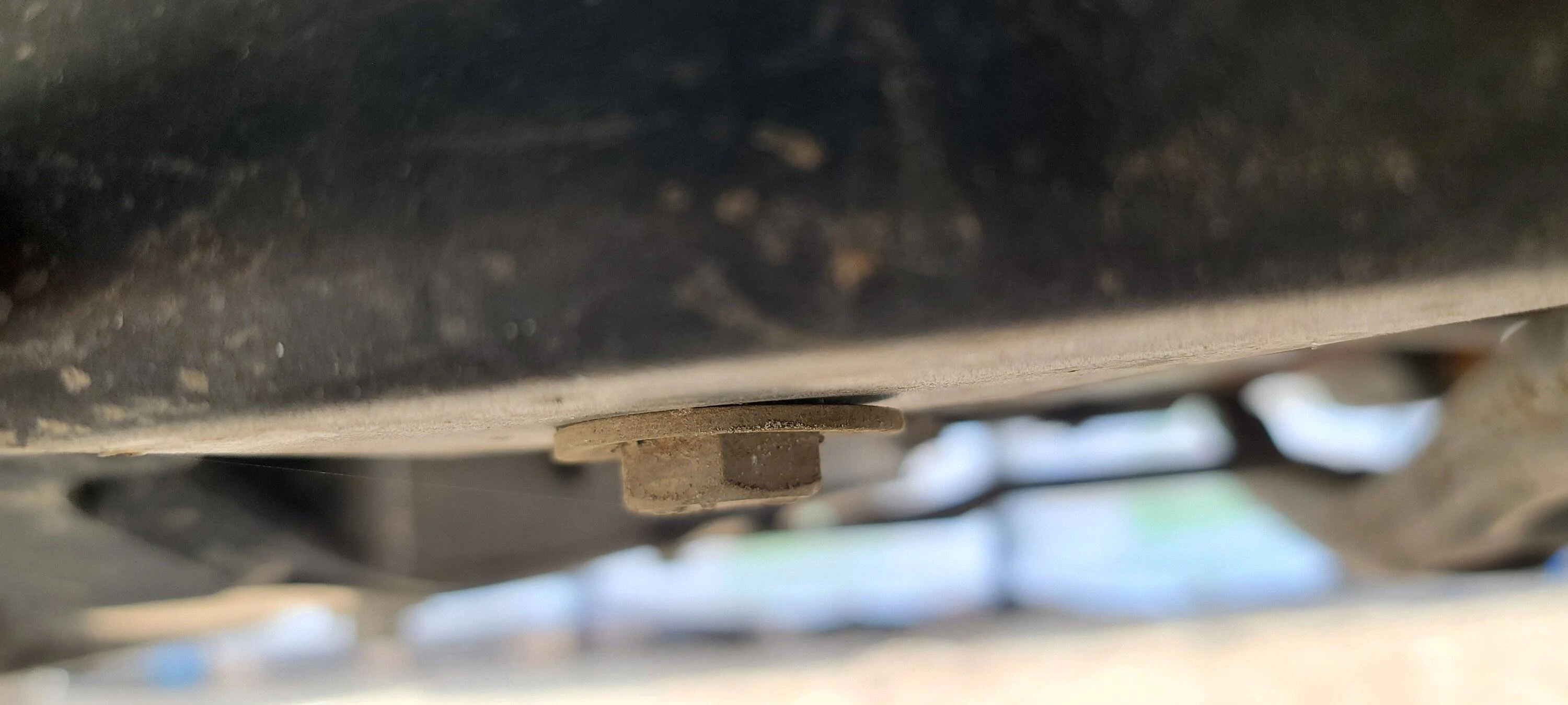

Here's an example of what happens when too thin of a washer is used in conjunction with a wiggle room sized through hole. This is one of my slider to frame bolts, which I need to make right. Same thing will happen with a slotted hole if a thick enough washer isn't used to account for the lost real estate under the head of the bolt.

If I do end up slotting the holes, the hole would be between 1.5 - 2 times the original hole. probably closer to 1.5 ...
The only thing I don't like about the DV8 spacer, is its 2" . .. Does anyone know of a 1/2" or 1" spacer ? I suppose I could have somone fab something up at some point .. sounds like a lot of trouble if slotting the holes is acceptable ..
If I understand this correctly, Assuming your bolt IS long enough to support a thicker washer .. is the fix as simple as getting the same size washer but thicker ? If so, sounder pretty simple ? Or doable for that matter. .
Oh, this sounds like the holes need more of an egging out than a full slot. Get some thick grade 8 flat washers to sit under the lock washers and make sure the bolts are long enough. Done deal. Easy peasy, lemon squeezy! ?
For the record, I don't like anything DV8, but am not aware of any other spacers. Never was something that I looked into.
