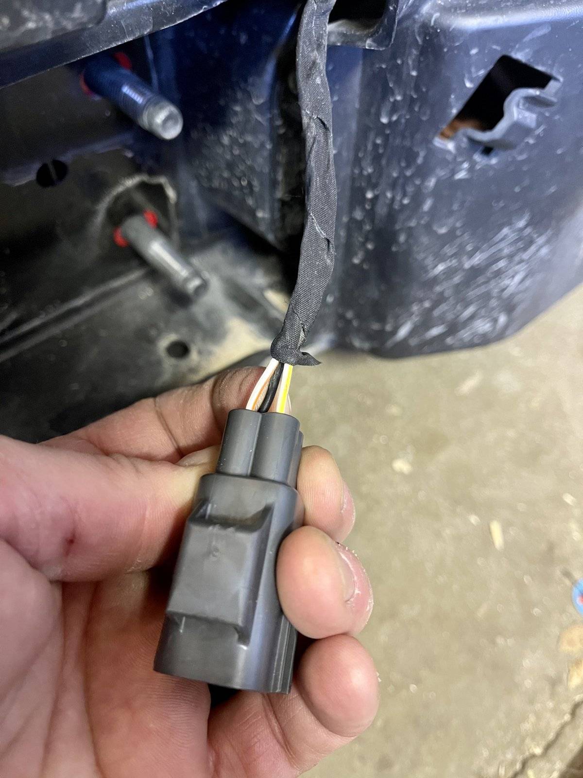

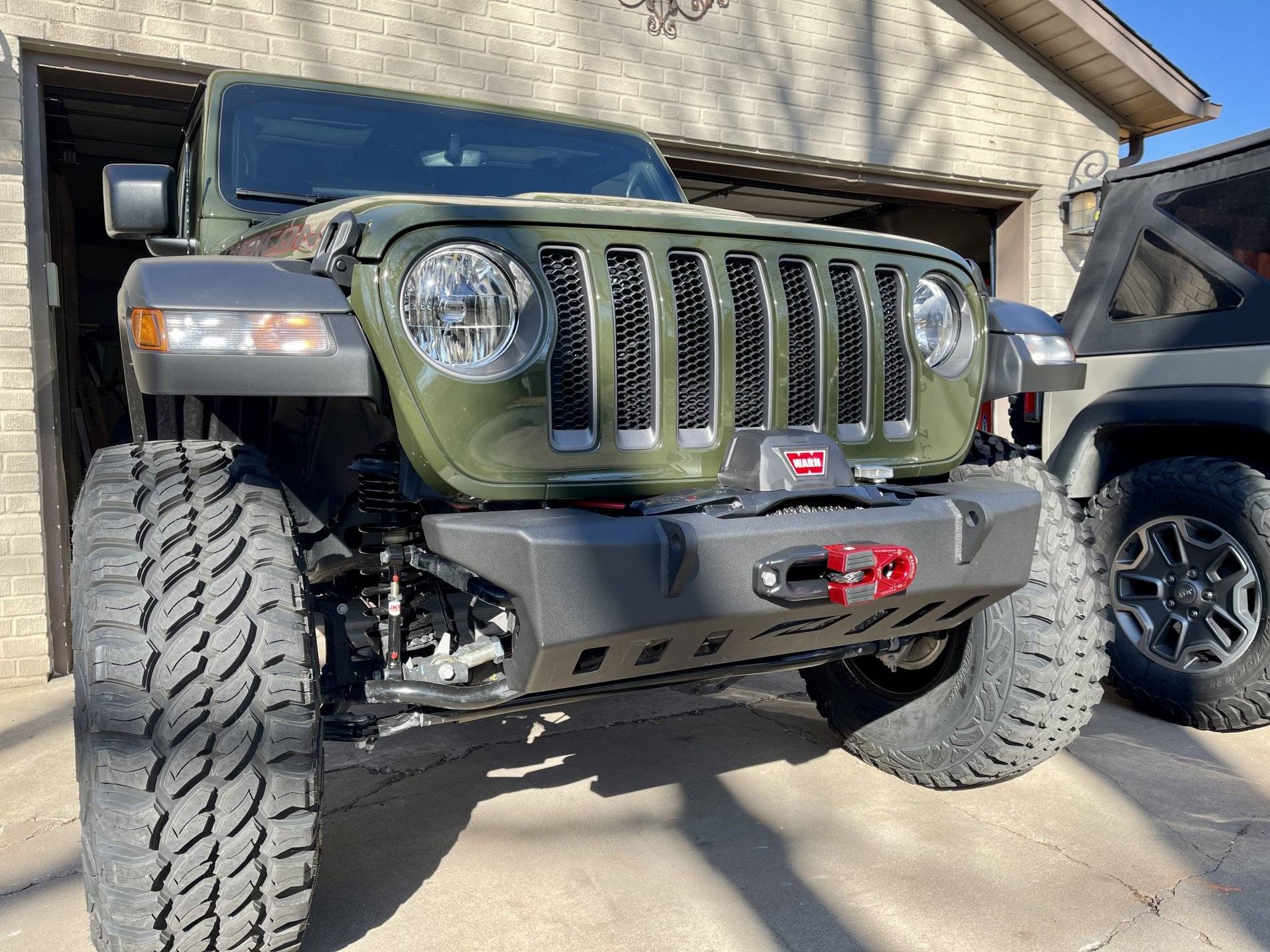

Hi guys. I just replaced my factory bumper with the Motobilt Crusher front bumper. The crusher doesn’t have a place for the factory fog lights, but I’m wondering if I can just wire some lights to the wiring harness that goes to the factory lights so they work off the factory switch. Hope that makes sense...
Do I need to stay away from LEDs since my factory lights are not LED? Pics of the bumper and bumper side wiring harness attached.

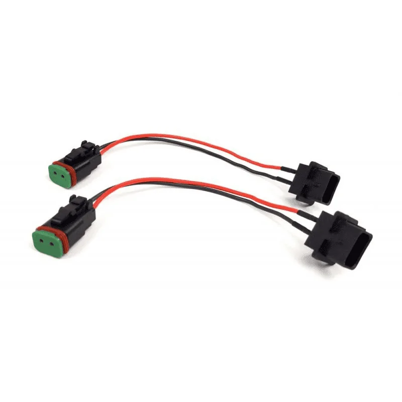

Sure, you can re-use the OEM bumper's harness and these adapters:
Jeep Wrangler JL Can I do this? 1615050456361
from KC HiLites (JK & JL are the same) to easily plug-and-play any Deutsch 2-Pin Connector lights that are near or below the factory OEM fog lights wattage.
You can go with LEDs. They draw less power so you'll have no issues using the factory wiring/harness.
