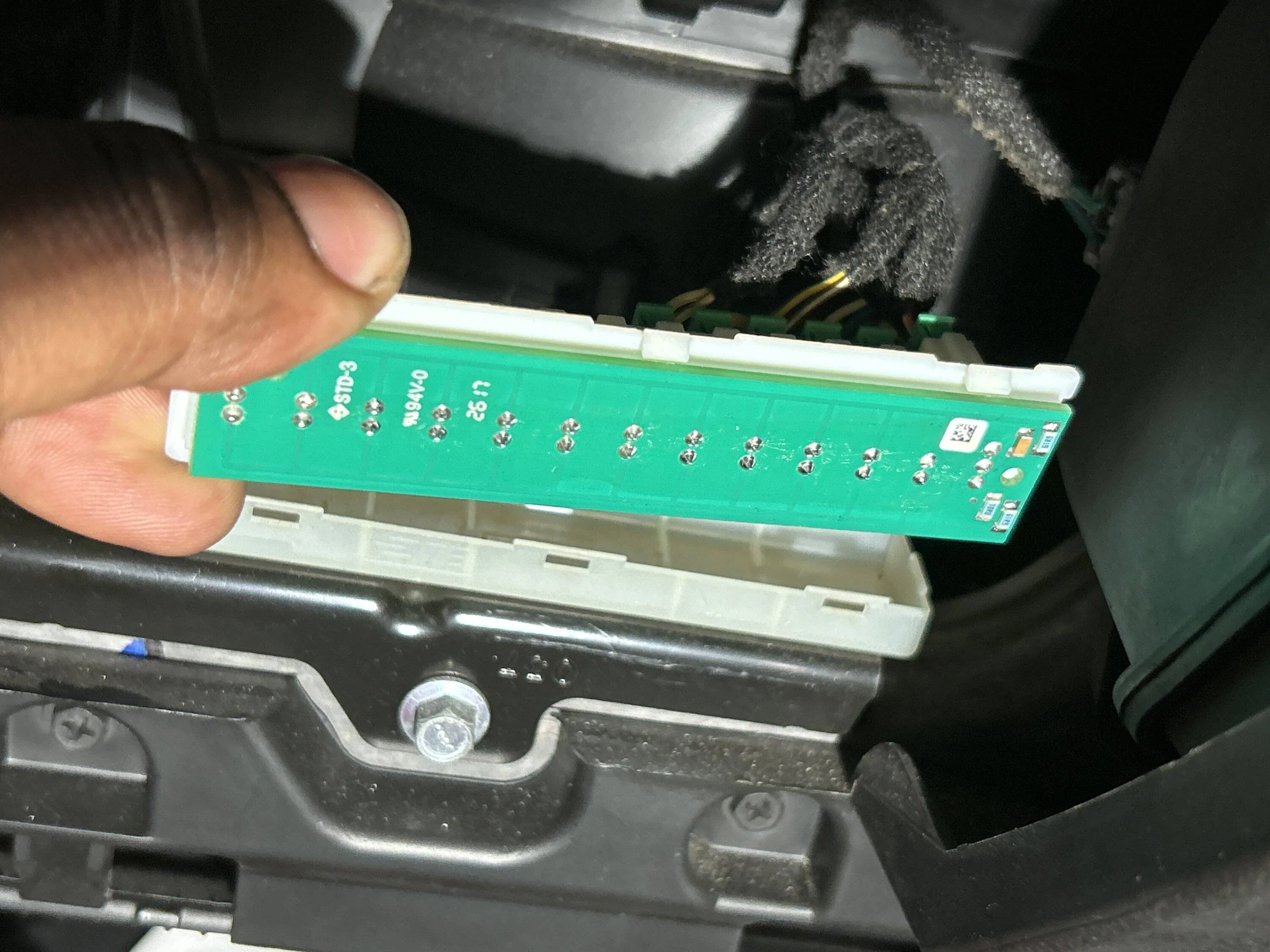

I could be wrong, but if you detach from base and flip over (while wires are still plugged in) you can test from bottom with whatever voltage setup you have.
Jeep Wrangler JL Can bus block question imag
