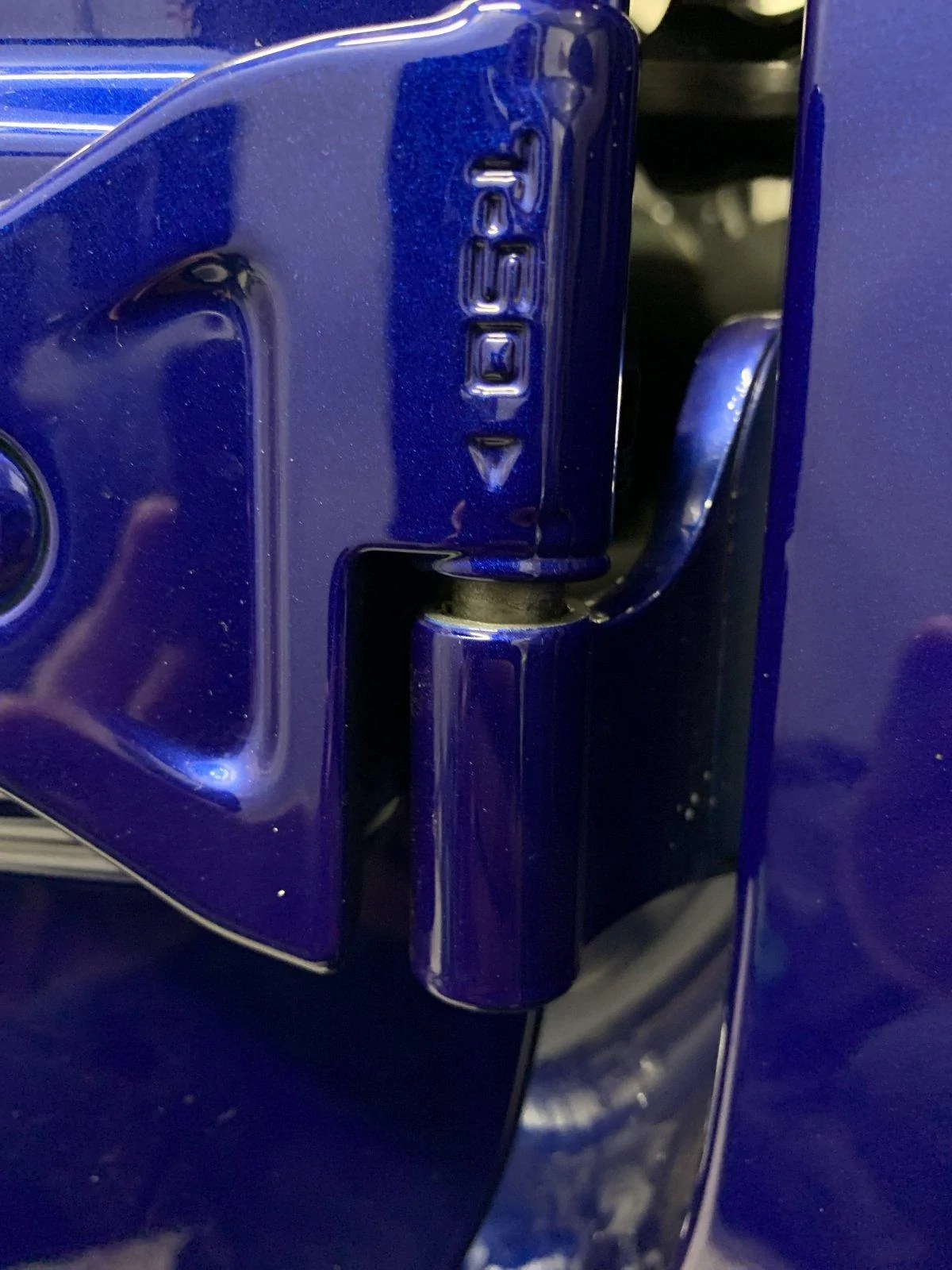

Hi all. So I’m trying to get my door back on for the first time and the bottom pin won’t go all the way in. Any ideas? The door closes but this doesn’t seem right. The top pin is perfect. . Appreciate any help thanks.

This is a known issue..
The hinge liners are not the greatest and are easy to replace, it happens a lot when foot pegs are used as the hinge liner gets damaged when you have a foot peg in there and put lateral force against it but they are fairly cheap to replace.
In older Jeep’s these were made of metal but the newer style are made of a hard nylon material

Thanks for the feedback. Any harm in leaving it like this and driving around until the spring when the doors come back off. Both front doors have the same issue and I did have a foot peg there back door went on easy.

I replaced a set on a Jeep that were damaged and left unattended and they were a huge pain to drive out with the included tool but these were the older metal ones so not sure how the newer style would do, my concern would be if the nylon liners are damaged and say broke then the hinge pin is sitting in a larger hole and it’s a metal to metal rub and it may cause excessive wear on the pin or hinge or both so IMHO I would get a set of liners and just replace the bottom ones and keep the others as spares
Also if you decide to replace them before tapping then new hinge liners in make sure they easily slide over the door hinge pin and sand the pin as necessary, it’s easier to do before putting them in trust me , also grease the pin and liner sleeve well before hanging the door
