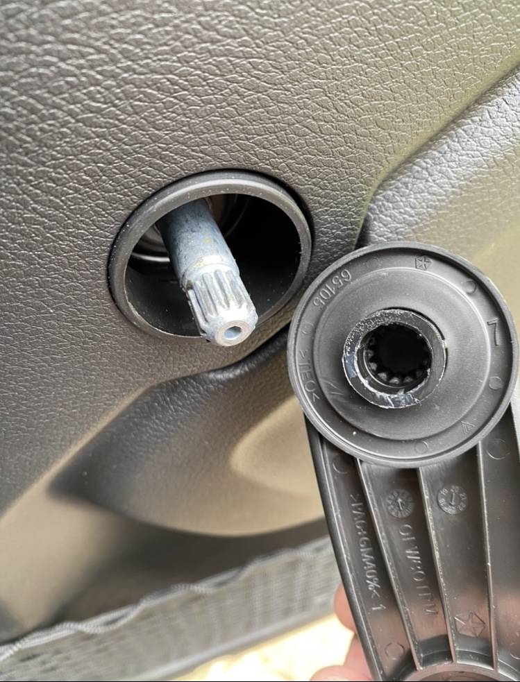

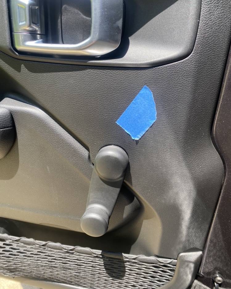

Took the Jeep to the dealer for 1st oil change & asked em to clock window handles where I put the tape. They said it can’t be done.. Are they for real?

No. I've had 8 doors with cranks replaced and the positioning of the cranks has been random on the replaced doors. It's fairly easy to do yourself with a window crank removal tool.

Depends on the shape of the shaft. I’ve seen some that are square, and obviously there’s only 4 possible positions. However, most are splined and have probably 15 or 20 possible positions.
Splined on the Jeep, and they use like a slip ring thing that hold them in place.
Remove, place where you want, and smack back on.

I used a towel when I adjusted mine. I positioned mine so they point up.
I think it's straight up with window fully rolled up and slightly forward with window rolled down.
Used to bang the fuck outta my knee off road otherwise.
Same thing here, being 6'5", my driver side window handle is set in the one position where my knee doesn't bump into it. Every other window handle position is set to match the front driver's door.
