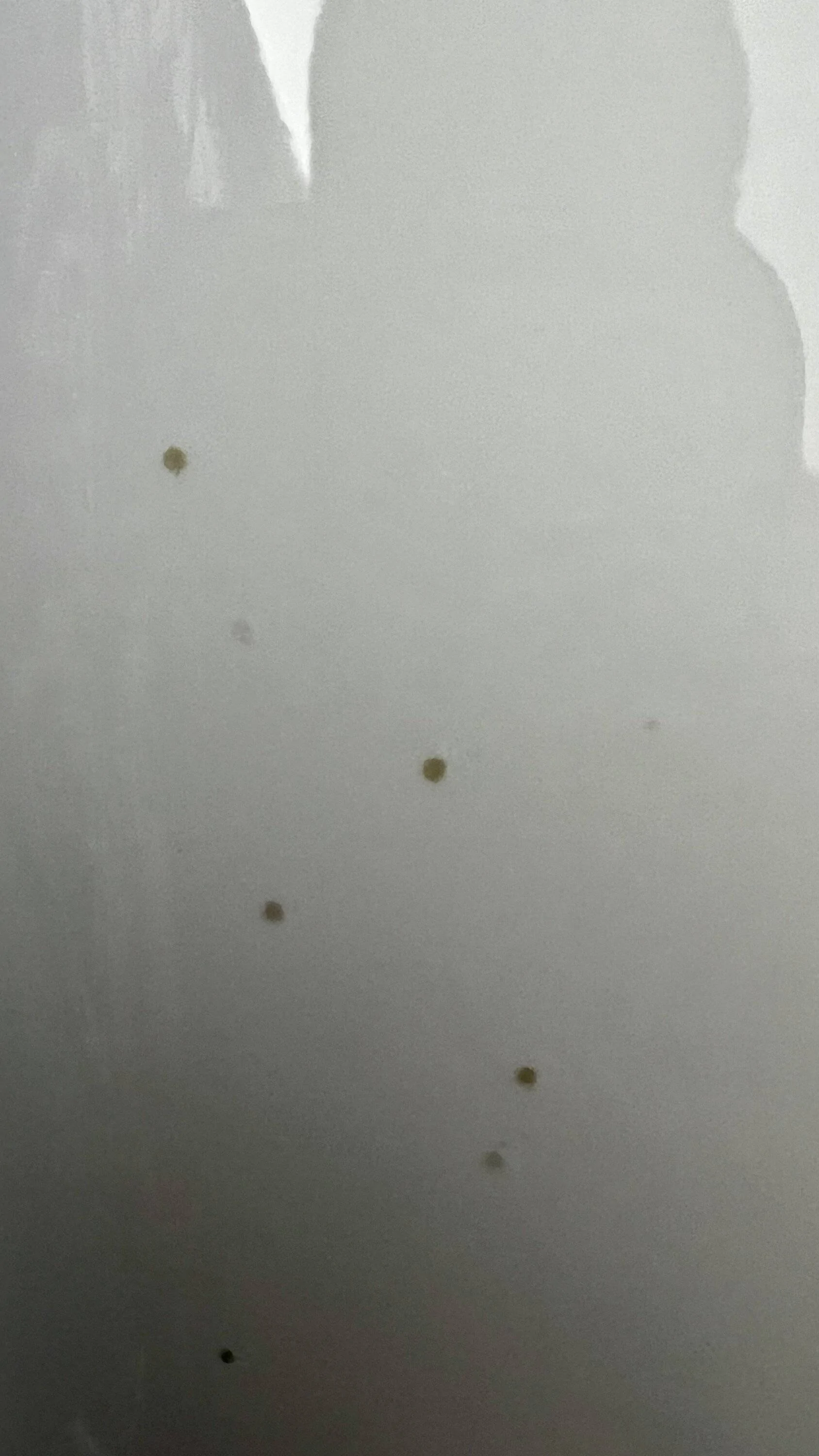

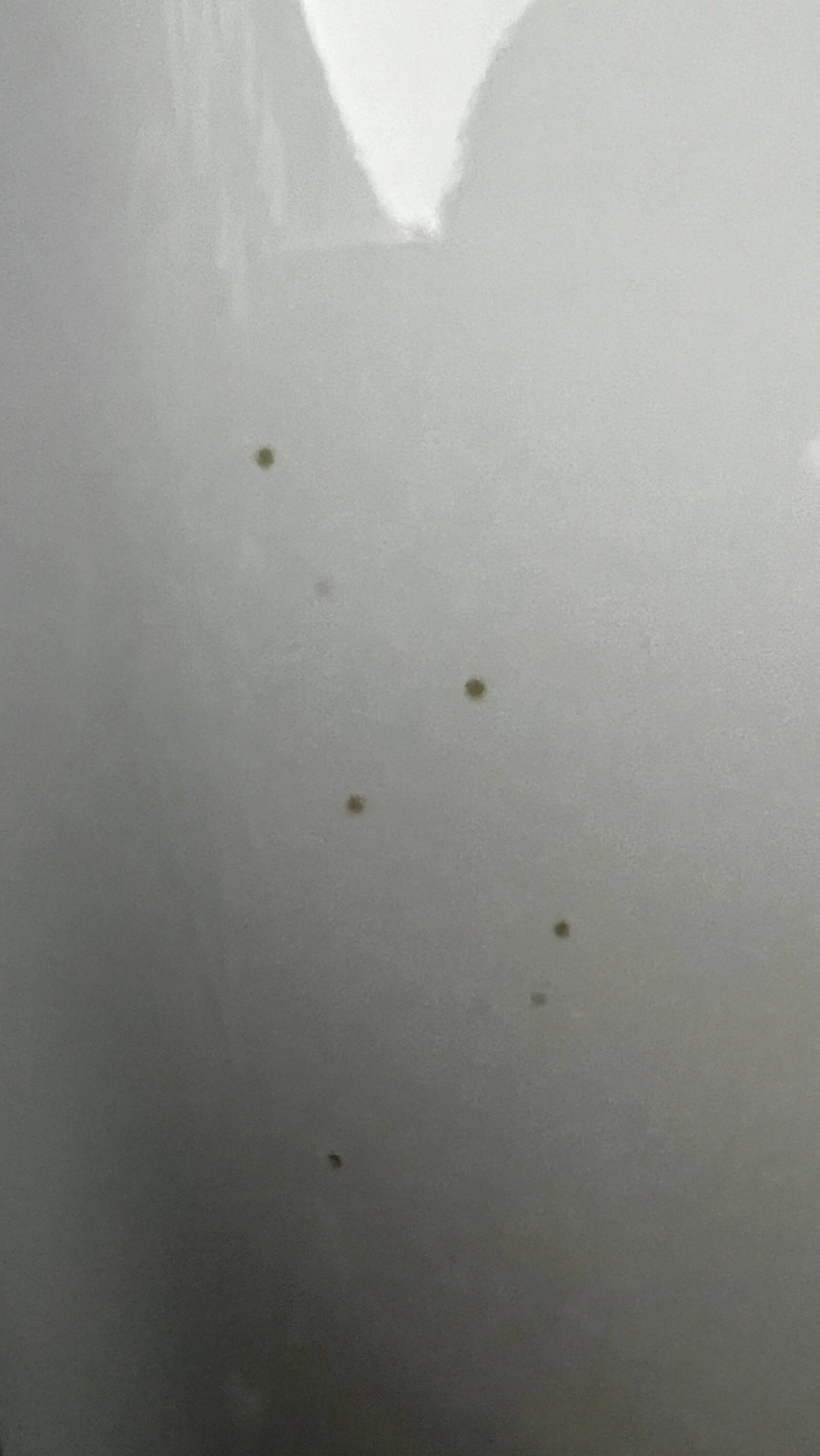

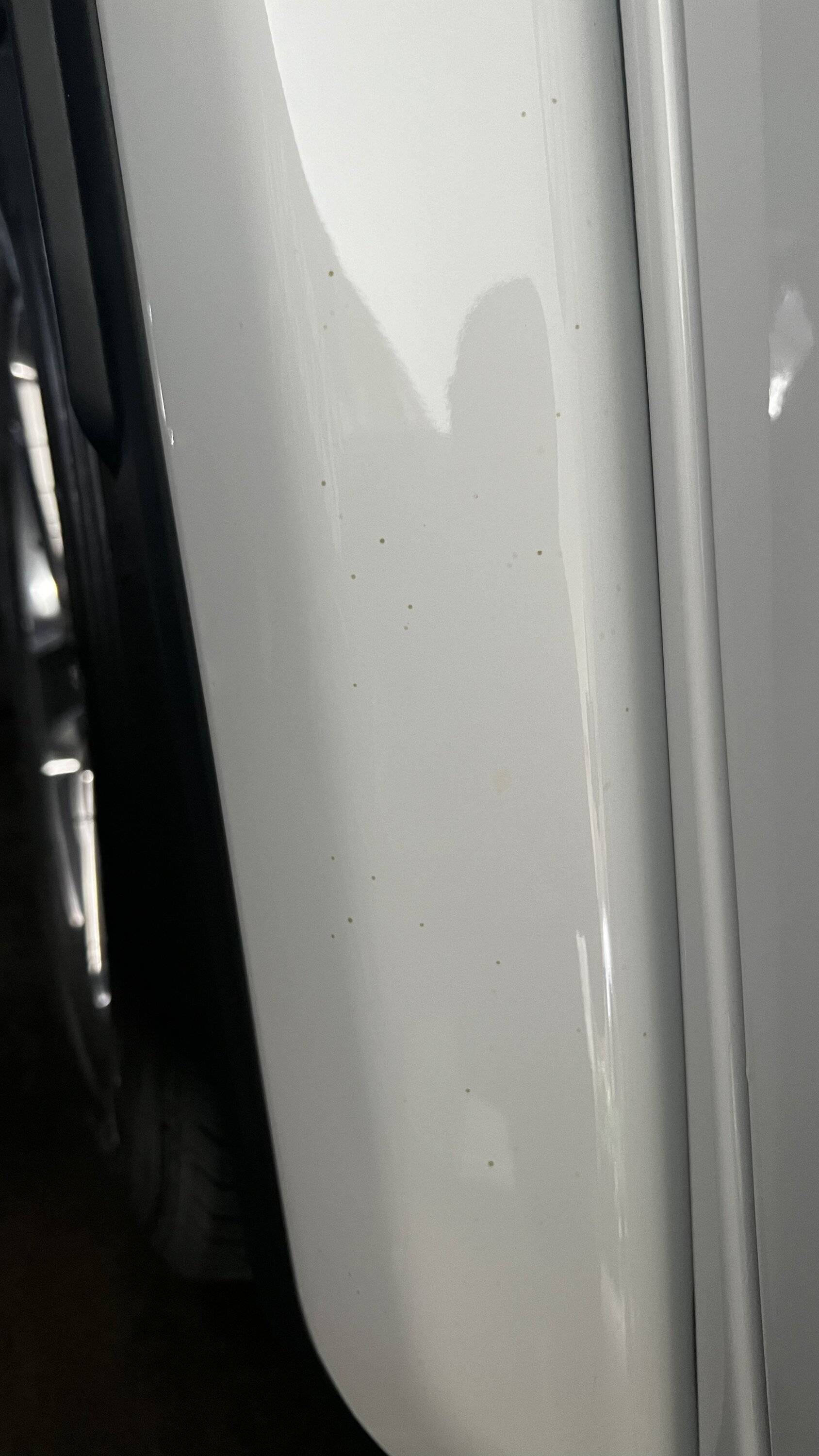

Hi, since a few days ago I noticed that I have some brown/orange spots on the back fenders.
I have tried to remove them by washing, waxing and using Tar remover, but it hasn't worked.
I thought it might be rail head dust but I'm not sure.
What do you guys think it is and how could I remove them?
Thank you.

My last vehicle was white and had this as well. It’s called industrial fallout. Bits of matalic stuff get onto paint surface. Clay bar and a lube spray will remove it.

Trains kick up a bunch of dust from coal cars, the metal-to-metal grinding on the tracks, etc. and it gets on vehicles.
If it's iron, you could use an iron remover spray. Smells awful but works well if those spots are contaminants.

Detainers clay and lots of lube.
Thanks I'll try that

Yes, I think I will try Iron-X

Yes, do the Iron-X first. Clay Bar will remove it, but it takes quite a bit of work. Iron-X it first, then come along with the clay to remove the rest of the impurities before waxing.

I've used Iron X on wheels but never paint. As others have said I would use clay bar.

I’d hit it with iron remover and a synthetic clay pad for a polisher. That’s about as aggressive as a decon as you can get, though you’ll need to do a polish afterward.
