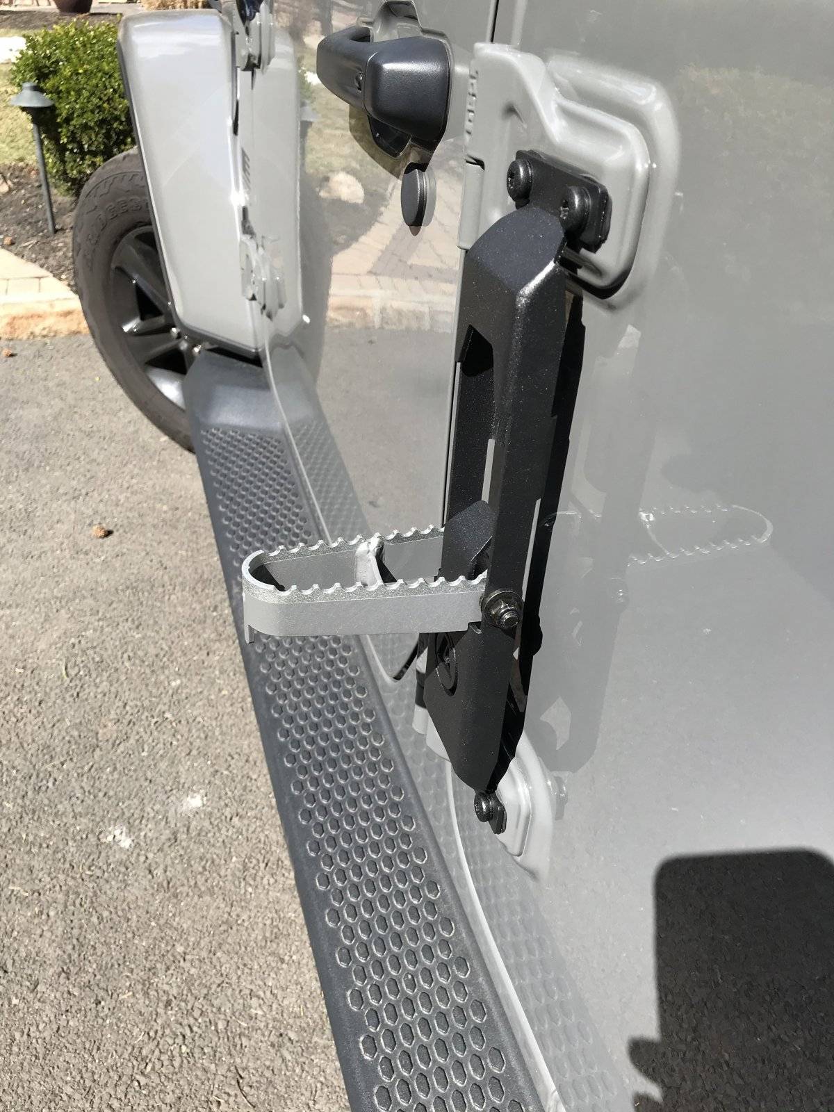

The Atlas steps? Don't the install instructions say to shim the bottom first? If you haven't done the other side yet, using inflatable shims makes the job super easy.
For display purposes only:
Actually I used two on the bottom and one on the 45° angle where the fender is, to make sure the door stayed square.
If they are still shipping with that little rubber rectangle gasket, toss it. Mine are disintegrating after a bit more than a year. Haven't decided yet whether to trim and seal or replace with silicone gaskets.
I installed these same steps last weekend. Directions said to tape and shim but I found it easier to just take the doors off and lay them flat on a packing blanket. Used couple pieces of painters tape to mark the hinge positions in case they moved (they didn’t) when removing the OEM bolts with an 18” breaker bar. Took a fair amount of force to get them moving but luckily no issues and easy install from there aside from time spent trimming the rubber gaskets which were way too big.
