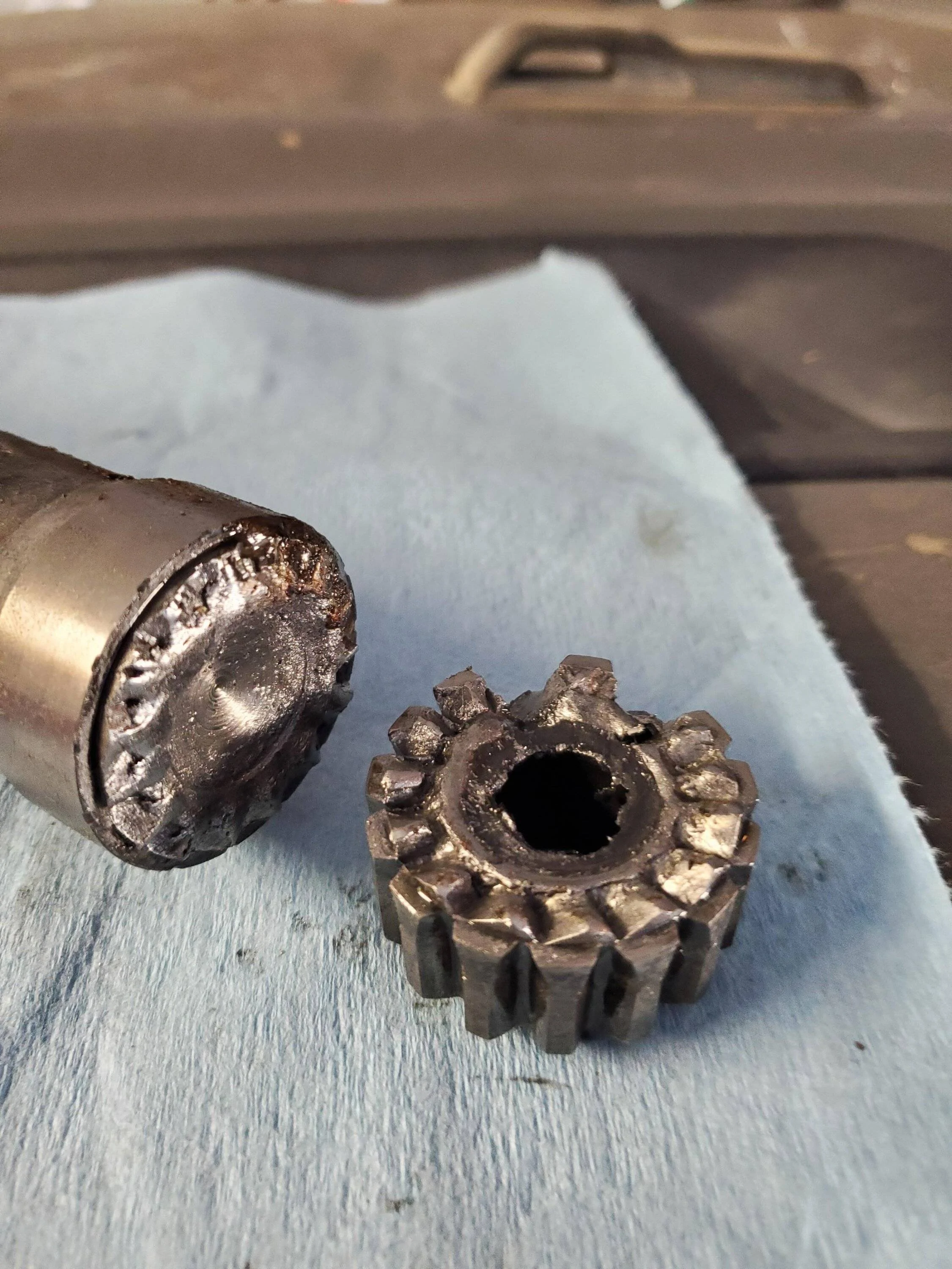

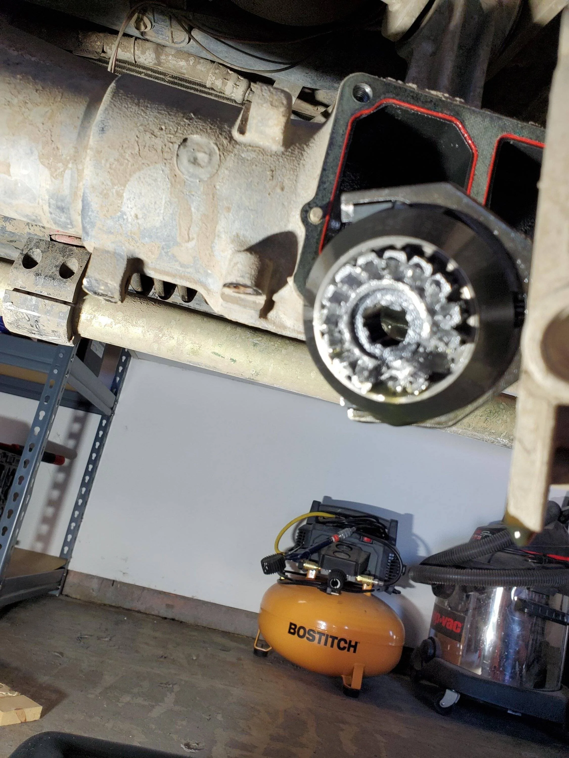

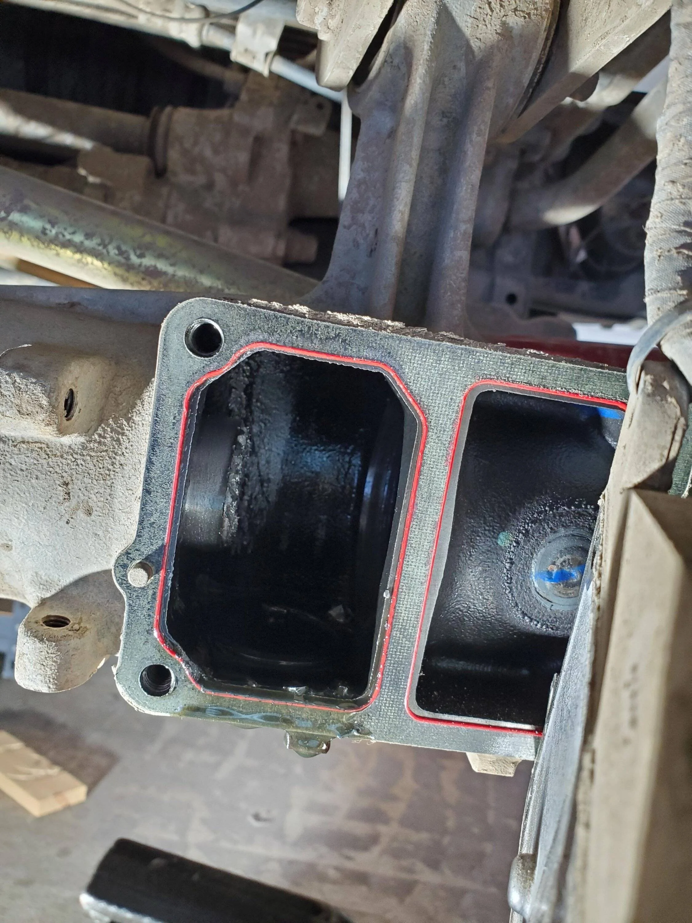

Finally cracked it open today. Inner Axle shaft snapped right at the FAD.
Now I have to figure out where to get a replacement. I don't want to go the RCV route (don't like the idea of all that grease) or delete the FAD. I just want a replacement shaft or possibly upgrade to better shafts but without having to modify. Are there plug and play upgrades for axle shafts?

At least it snapped where you could grab it to pull it out. If it snapped in the middle it is harder to extract the pieces.
There are several options to upgrade your shafts. FAD delete shafts are more common. I'm running RCVs myself. There are some threads here about various options.

RCV makes a kit that retains the fad (it's what I run). They will sell you individual components from the kit so you can just upgrade the inner shaft. (I'm 90% sure the RCV shaft is a direct replacement)
The grease isn't that big of a deal as long as you don't over do it with the grease. Most of the mess stays in the wheel.
