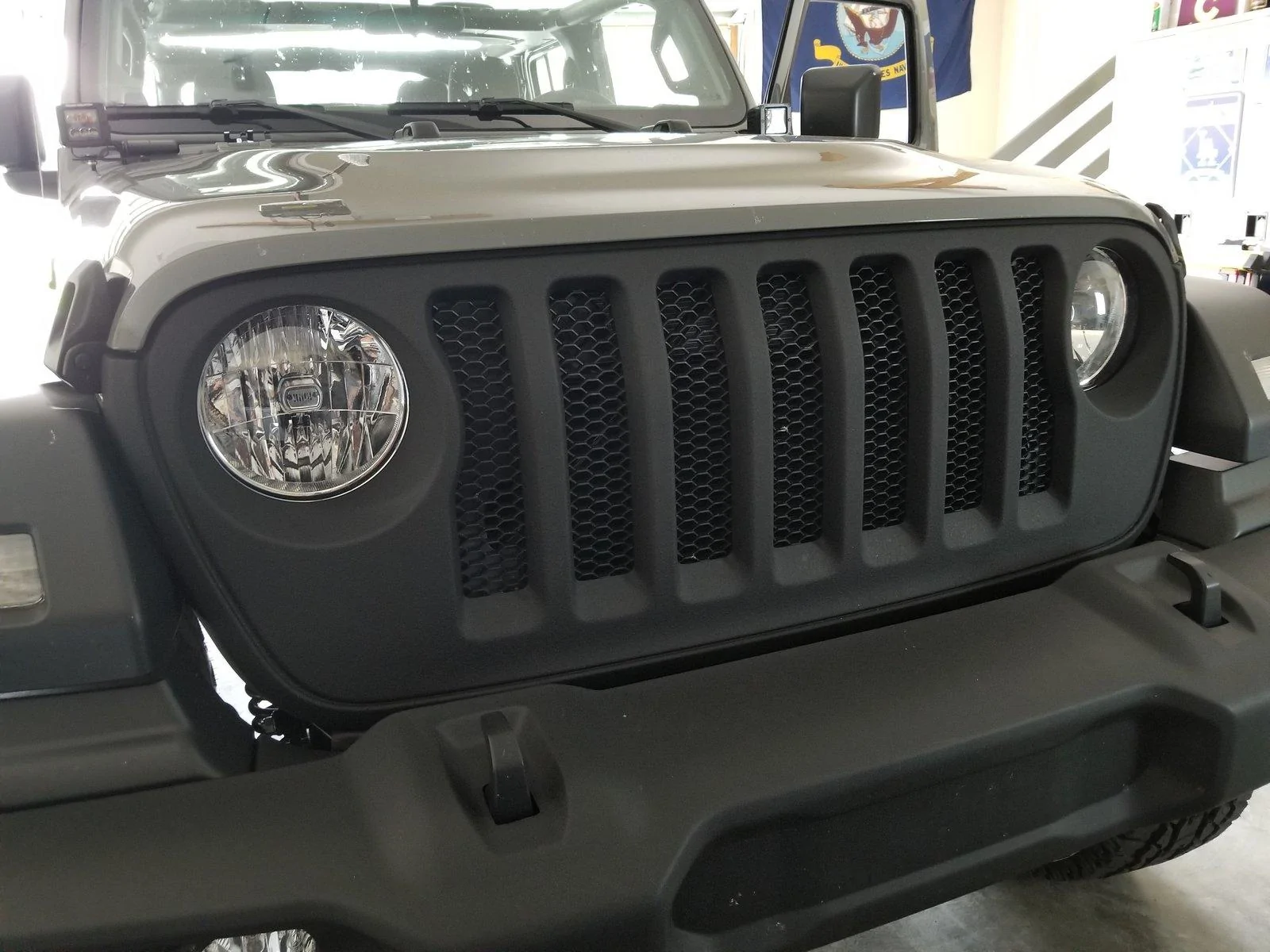

2nd time's a charm with plastidip...Did 3 lighter coats and 3 heavier coats. Very pleased..
oh man that looks really good. I need to redo mine now. Its definitely uneven like your first go. Did you warm the cans like other post suggested?

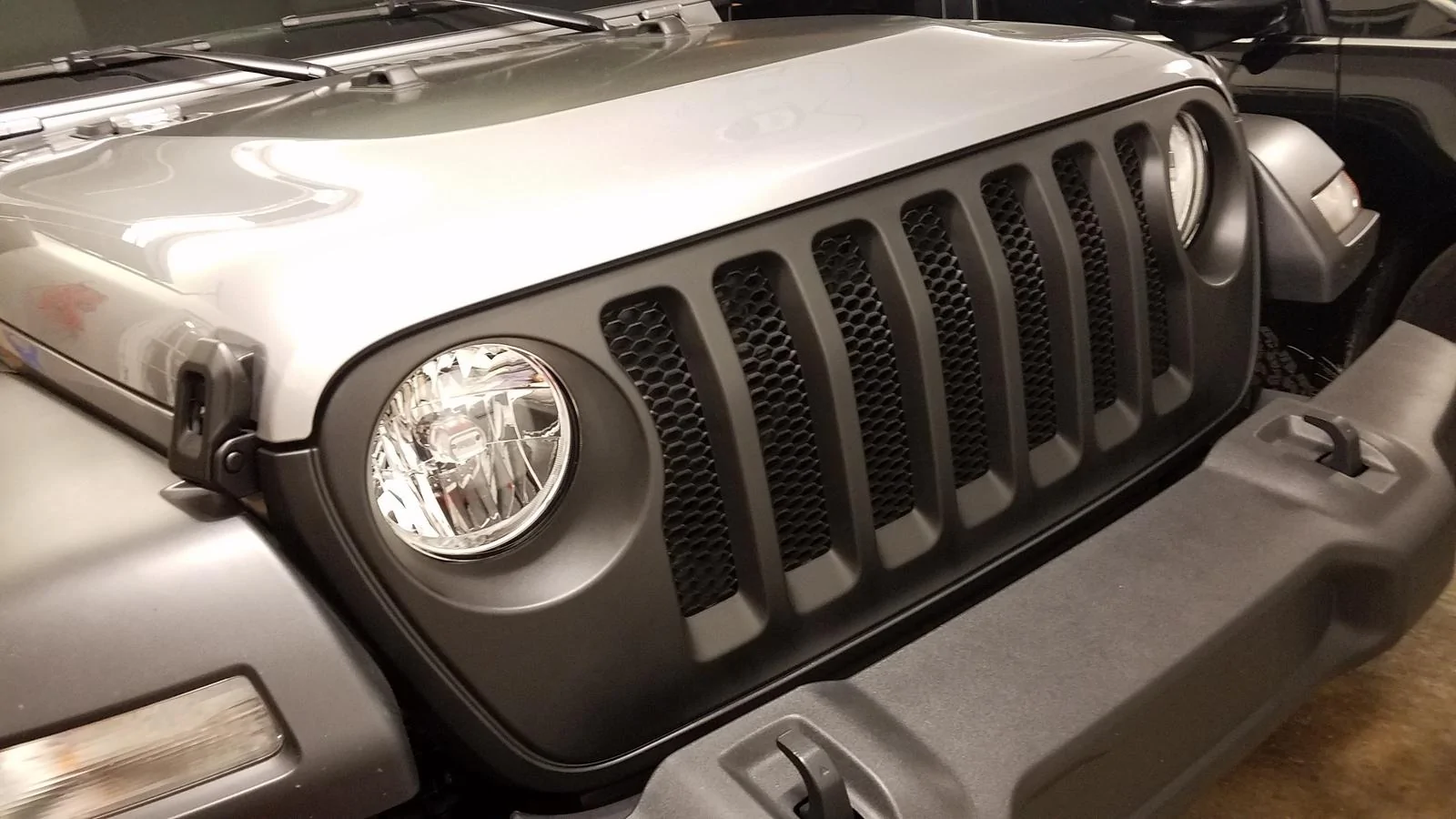

I tried plastidip, till I got my first rock chip. So I just bedlined. it. It's damn near bulletproof now. Can pressure wash, scrub, no problems.
Yeah...warmed them in water for about 10 min and also sprayed it at night in the garage when temps were in the 70s with lower humidity. Much better than my first attempt
Did you use bedliner spray paint and do it yourself? Is the texture alot rougher than plastidip? I got a quote from a rhino liner place to do it for $50, but didnt like the rough texture look when I saw their samples.

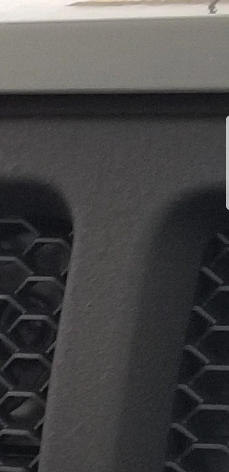

I used duplicolor bedliner and did it myself. It is a little bit rougher than plastidip, but no where near as bad as rhino liner. I zoomed in on a pic from my phone and took a screenshot of it. Not the best quality....
That looks great! I want my entire jeep to look like your grill (my order is currently in D1 status). Does the the duplicolor bed liner come off, or is it permanent? I’m trying to figure out what to do. I love the “somewhat rough” look, but not sure I’ll want it forever on the entire thing.
I'm 3 months in and plasti dip is still looking good after 5+ car washes and hitting it with scrub brush to get off bugs. I'll prob go with your bedliner next.

no...it doesn't come off. it is on there for good.

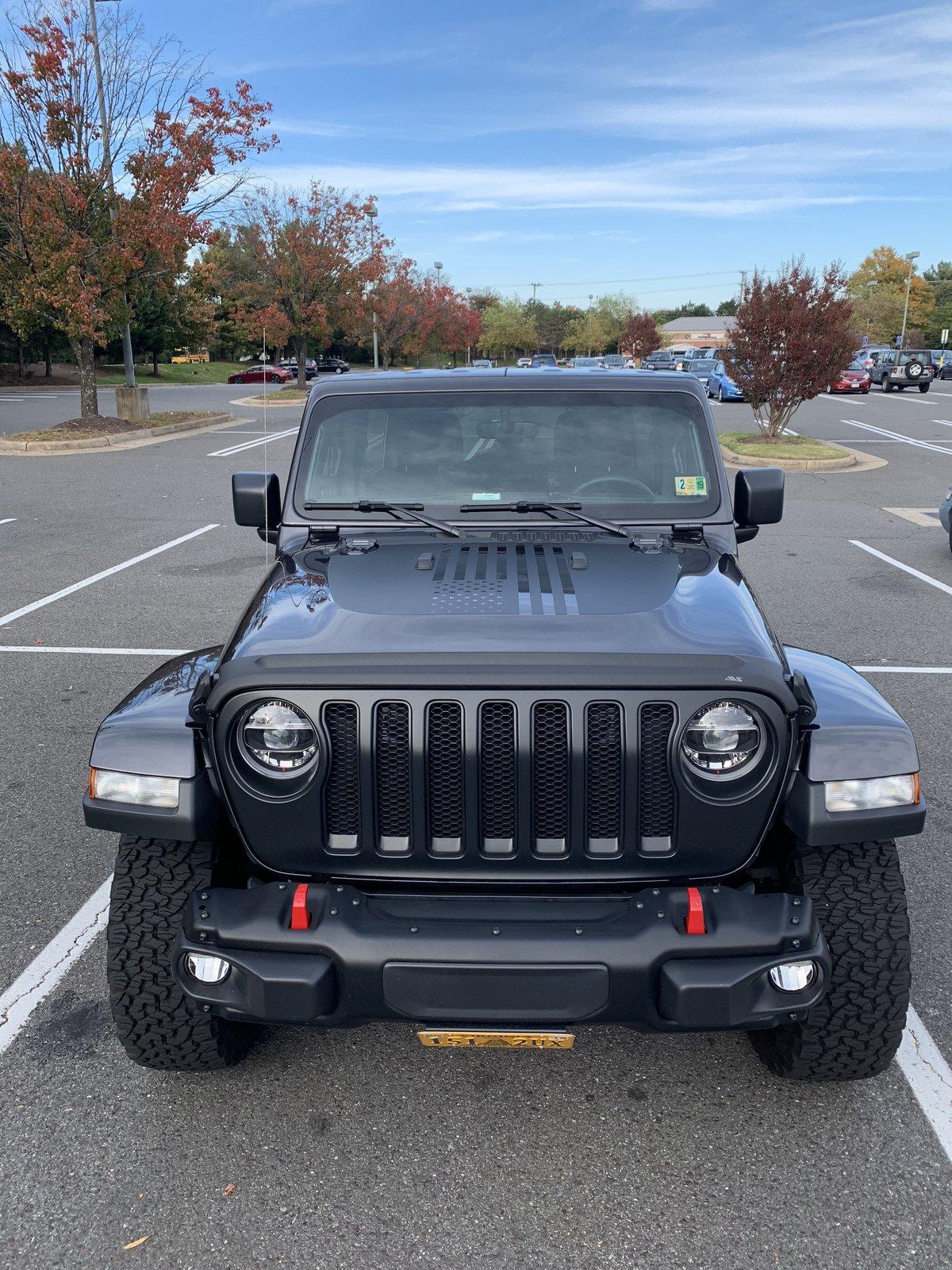

Jeep Wrangler JL Blacking out the grill 500E657E-CB95-4720-A831-AC7B07387DEB
Mopar matte black here too.
