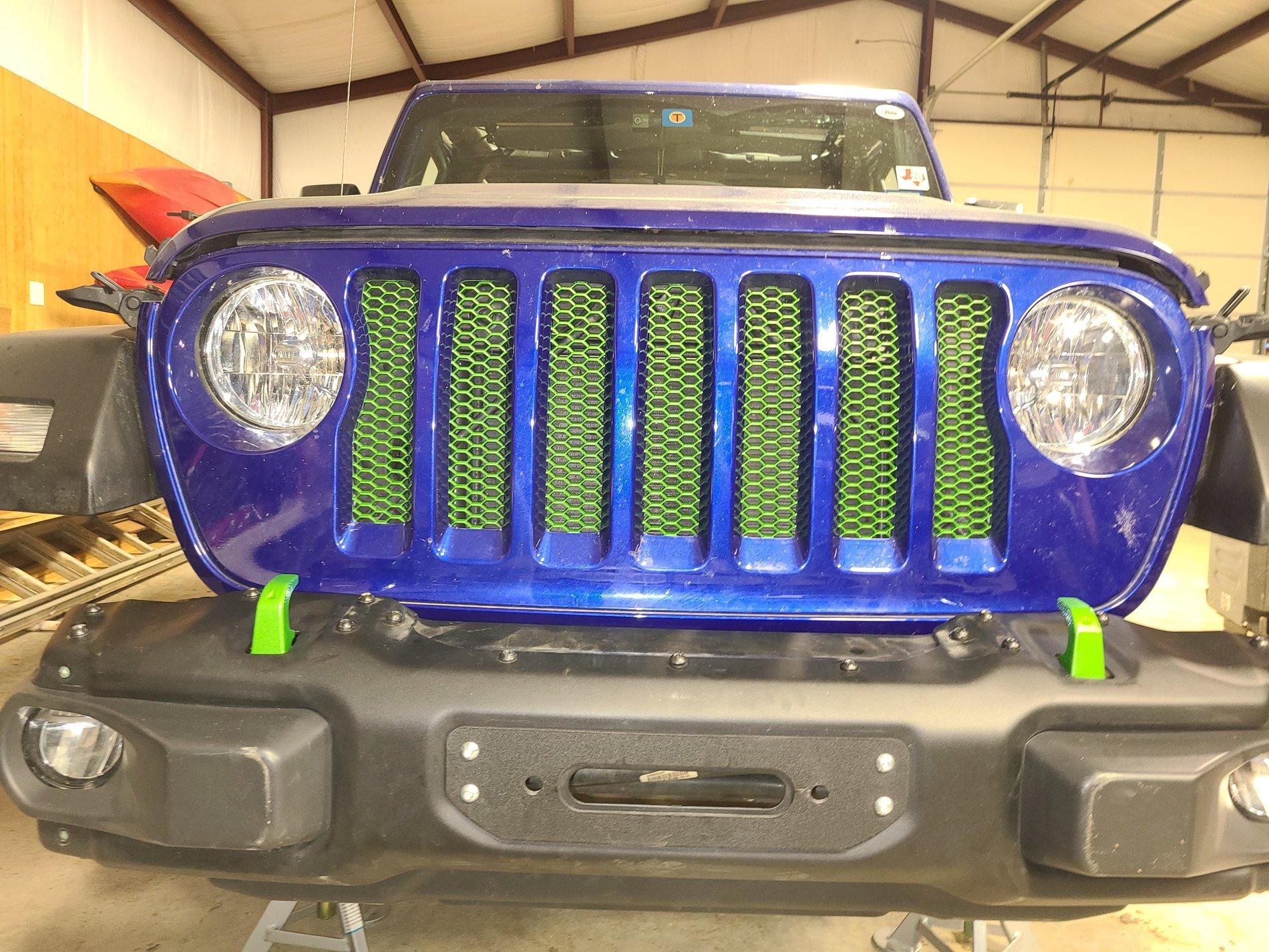

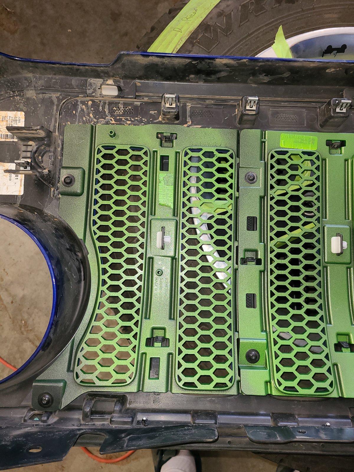

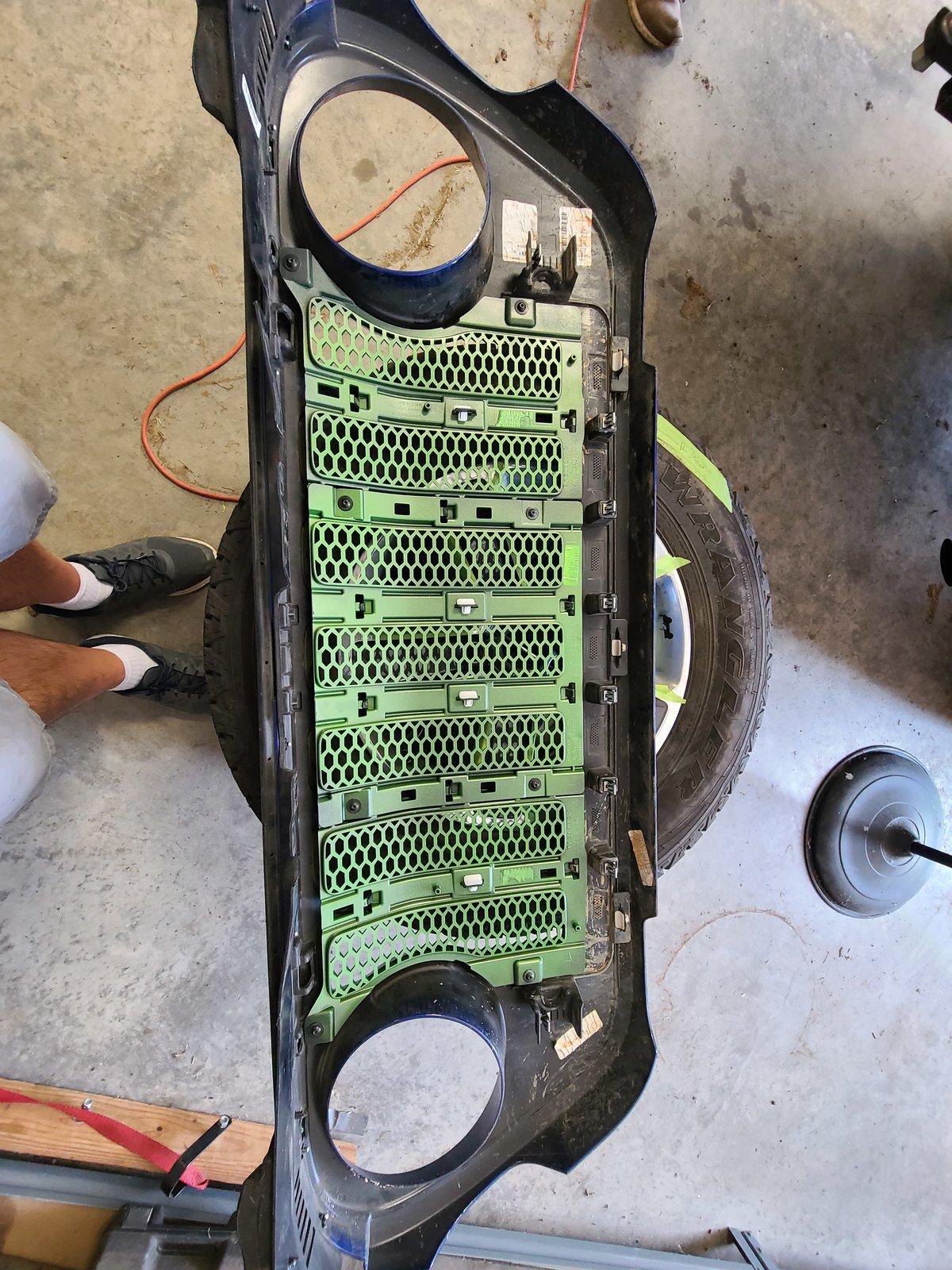

I have done this for my daughter. She wanted mojito accents for her ocean blue.
Steps where to remove inserts, sand with scotch Brite. Clean, spray with a paint prep supplied by paint supplier (adhesion promoter), then spray several coats of paint.
I sprayed then rotated it 90 degrees, and sprayed, rotated, repeat until all angles done.
