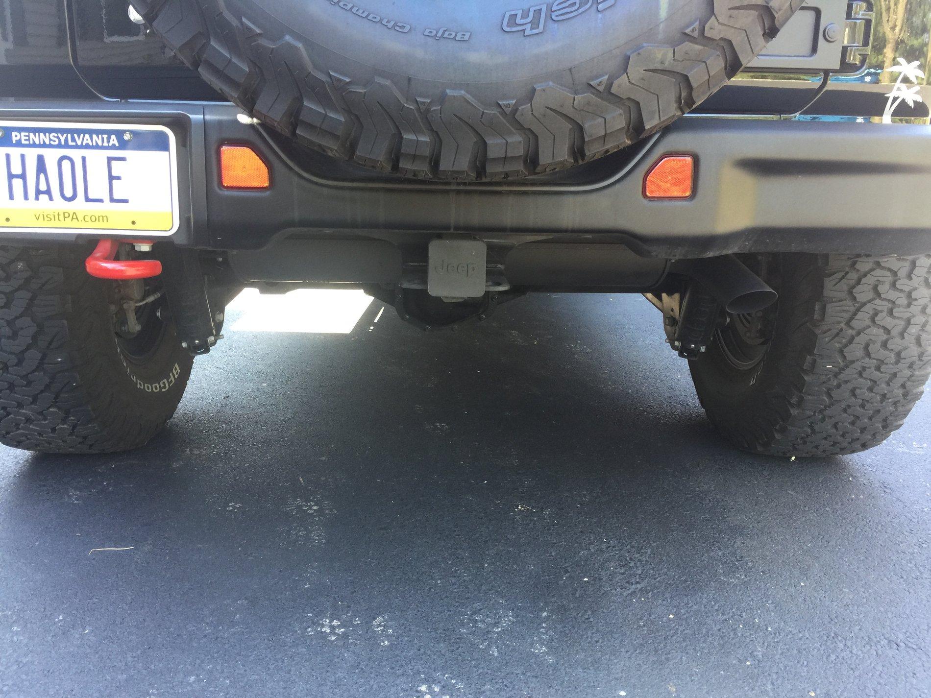

I did this with all three of my JKs - I used Rustoleum High Heat, and it held up very good. I installed a used like-new Borla touring muffler that I got for a great deal on my JL, and I painted the OEM muffler black once it was off just in case I want to go back to It in the future.

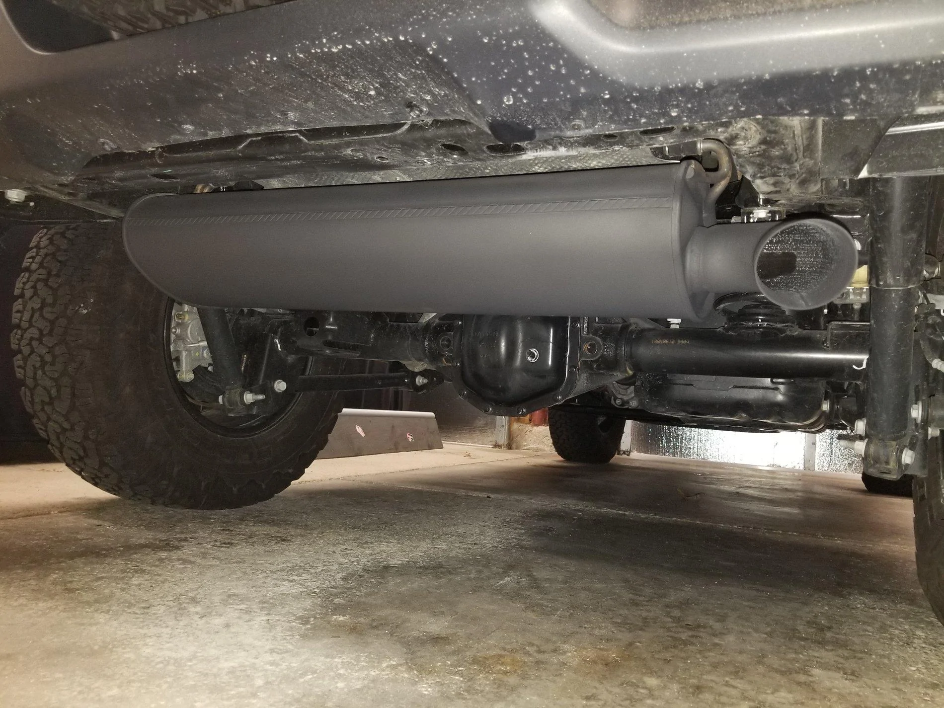

I did this today. Pretty easy. You can easily put cardboard on the top of the muffler and work around with an 1x1 over spray piece in your non spray hand. You get a lot better at it. I cleaned the muffler and then took some high grit sandpaper to it. Then cleaned again. Then hug heat primer. Then high heat paint.

How do you get all around the muffler. Im assuming the parts you cant see are not painted.
